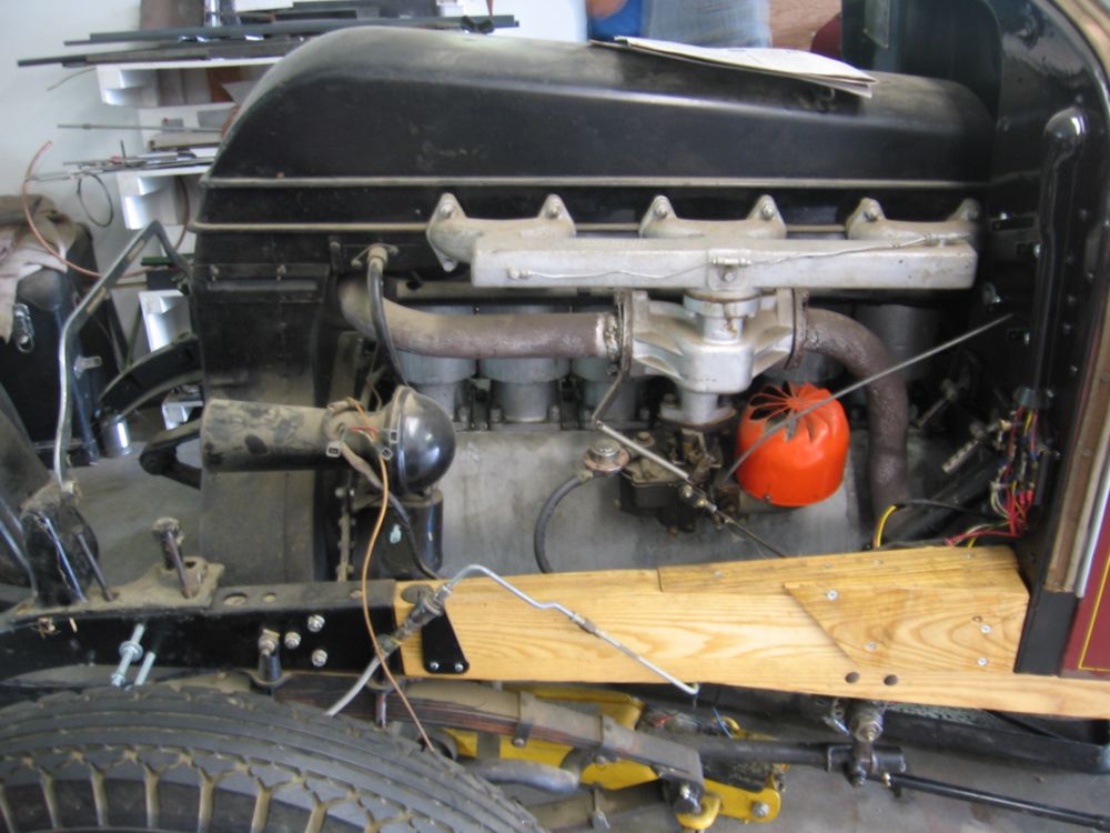

    The Franklins had the wooden frame rails up through 1928 and they were fairly large and heavy cars. You might want to check out the H.H.Franklin Club for more information.

  9. 31Dodger
    Joined: Mar 24, 2011
    Posts: 5,189
    31Dodger
    The 1928 Franklin frame....

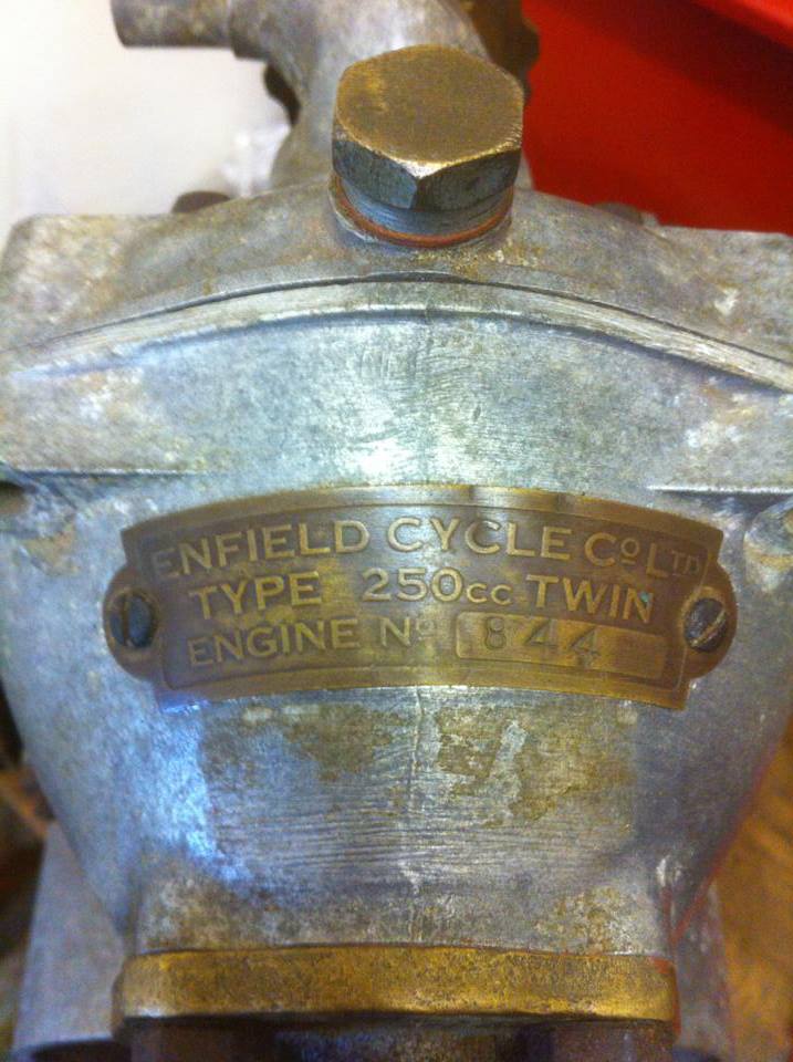

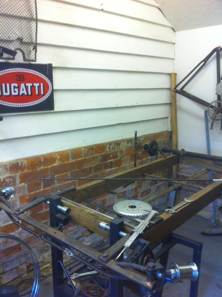

  29. banjeaux bob
    Joined: Aug 31, 2008
    Posts: 6,824
    banjeaux bob
    from alaska
    How a bout this one that Tim Gunn is building up using an Enfield flat twin ,2 cycle engine?
