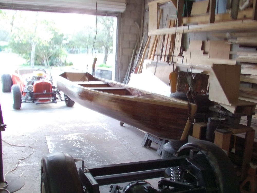

  4. TomWar
    Joined: Jun 11, 2006
    Posts: 727
    TomWar
    OK here area few pics, the Boat and the woodie that's almost ready to start on the Body. 3M "Scotch Weld" has quite a few formulas.
