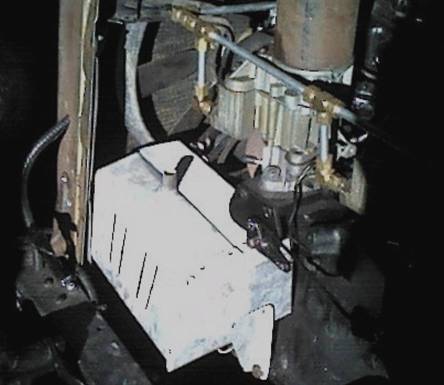

    Old style woven fabric sleeves to cover the wires. Press off the V pulleys and find/fabricate some to accept flat belt, leather or web. Cover up the alternator, see picture.

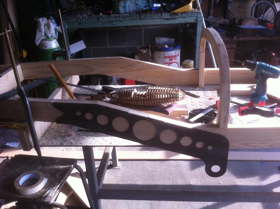

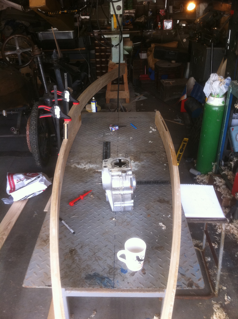

    You gentleman need to get over to the cyclecar thread.There Ade and Chu** are each building cars qwith wooden frames.
    Ade is building a replica of a car called the "Japic".He is using laminated side rails.The pics are of the car that looks like a cigar.
    Chu** is a little less complex.
    Bob

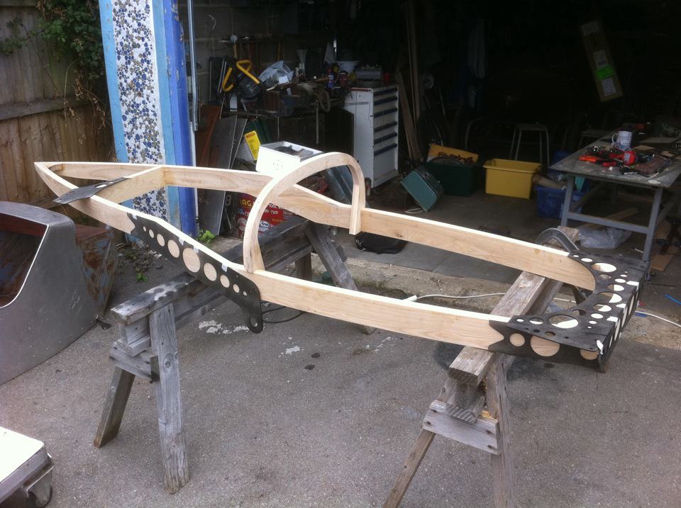

  21. banjeaux bob
    Joined: Aug 31, 2008
    Posts: 6,756
    banjeaux bob
    from alaska
    More of Ade's JAPIC recreation...

  24. banjeaux bob
    Posts: 6,756
    banjeaux bob
    from alaska
    Ade's progress and the original JAPIC..
