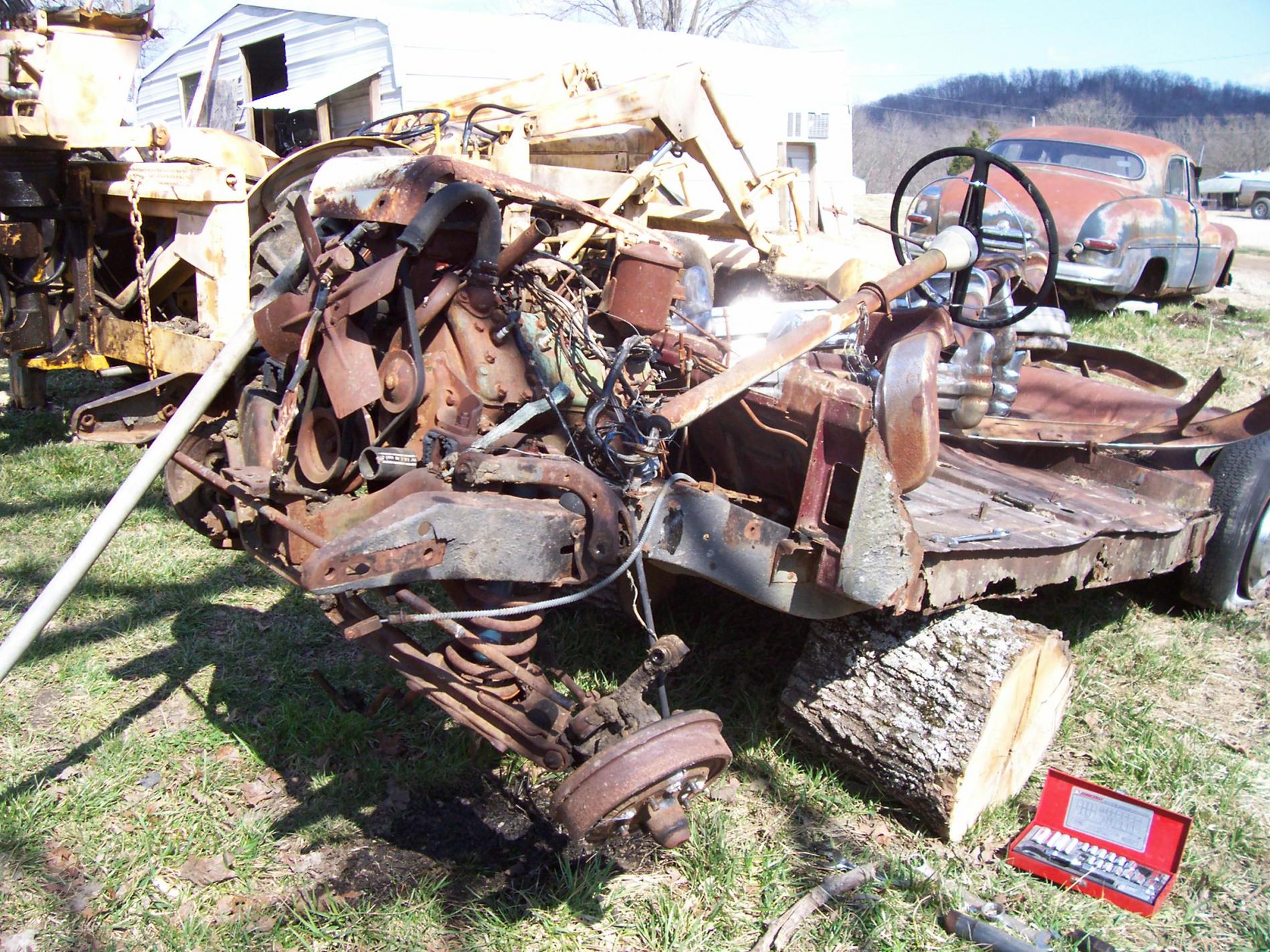

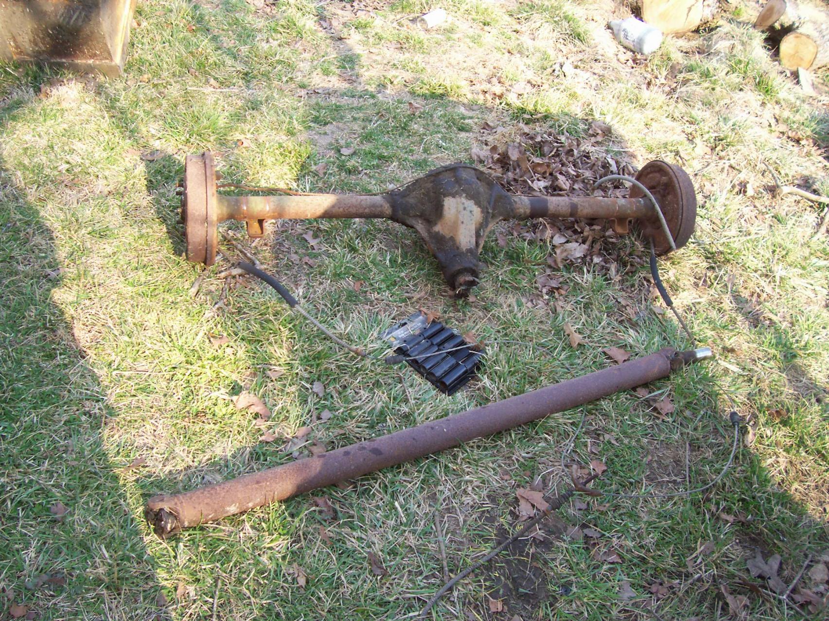

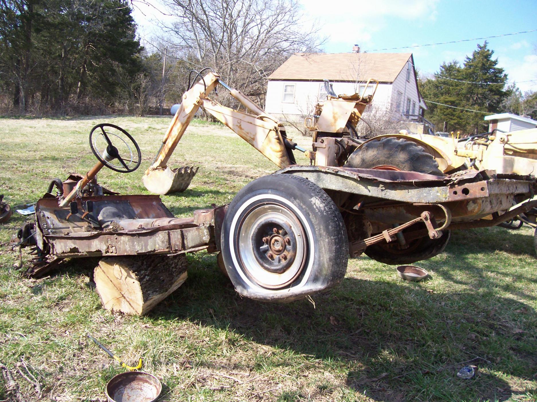

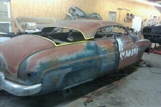

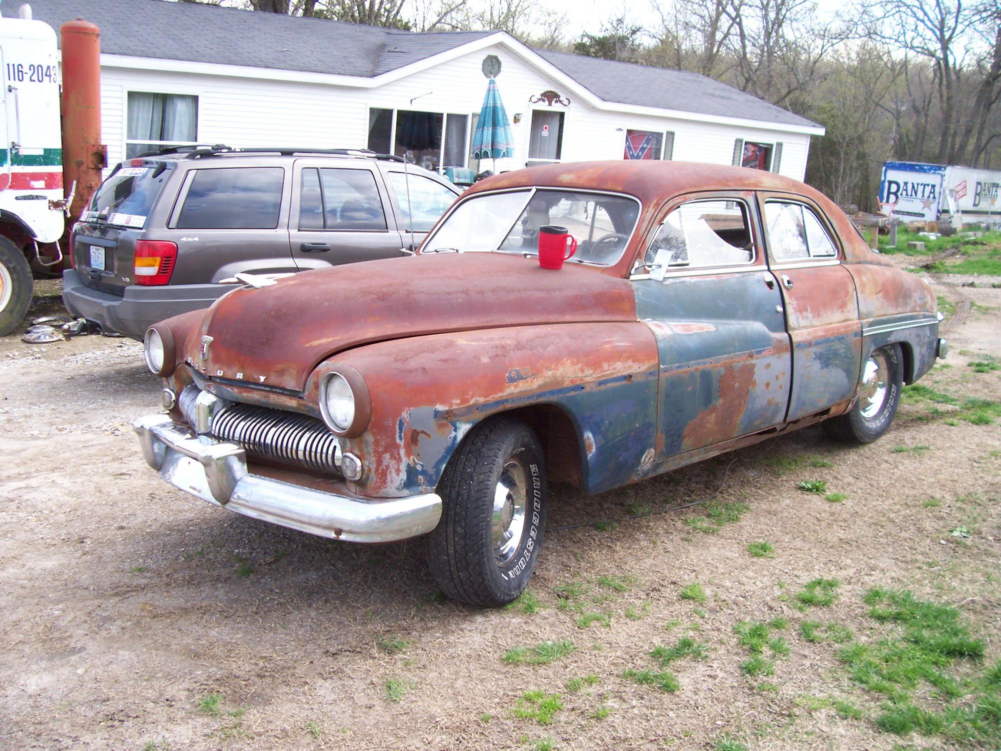

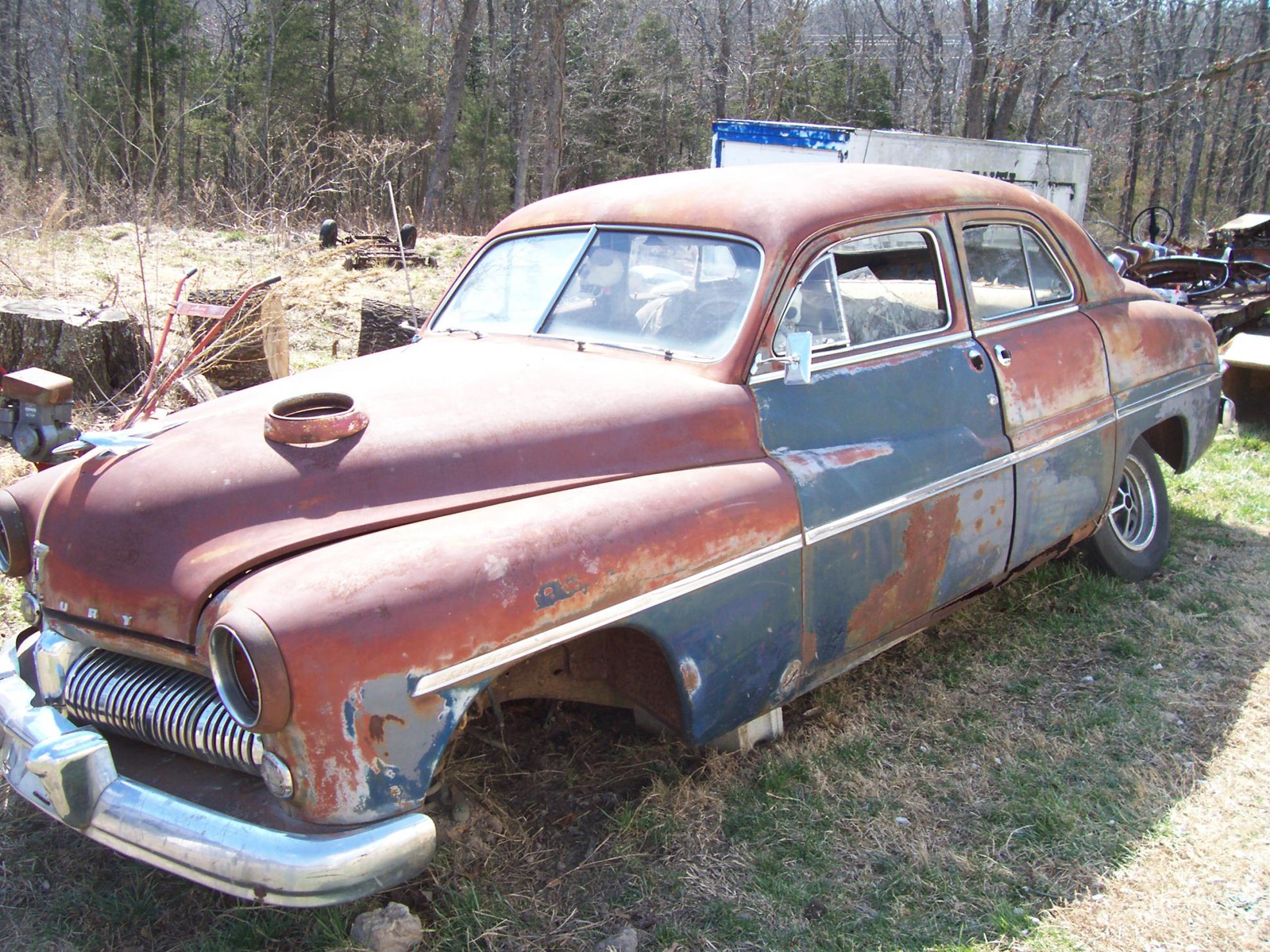

    Well I bought this 49 merc 4-door that someone had pulled the front spindals, brakes, and steering parts off of, and they had pulled the rear end out of it. Now many years ago I had a 49 merc that I drove that I threw a rod in the engine in, and then traded to a budy, he cut the body off and put it on a lincoln floor pan/chassis, well turns out he still had the old frame and all from my old merc. So he gives me that part I brought it home and started to work on the mess today. As you can see I had a handy little jack beside it to use and just did the work with simple had tools out in the yard today, and now have all the parts off and ready to go under the other merc. Here are some pics. Jim

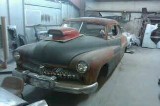

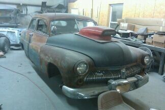

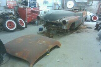

    Well the 49 merc 4-door is in the body shop, it is getting some wiring work done, getting the engine and trans put in, getting the bearclaw latches all the way around, hood corners rounded, nosed decked, shaved door handles, all bodywork, Interior, the works! Jim
    P.S. dont worry the scoop is just on there as a joke by a buddy of mine, its not staying! LOL

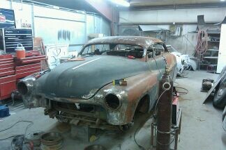

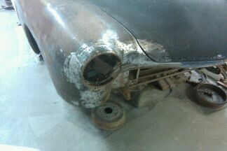

    Been doing a little to the merc, removed all the grill stuff, the pan the grill the headlights, park lights, the chrome from the car, started frenching the headlights, did away with the park lights, pulled the grill and the lower pan off the car and have started working on the 53 desoto grill setup to go in the car, also rounded the hood corners and nosed it while I was tinkering with the front, I started on the doors also, removed the chrome from them did the handle on the passenger front door, installed all the brear claw latches in the car, have all door fitting fantastic, have my 351 and auto trans sitting there waiting to go in the car, bought ne 50 pont taillights with bluedots to be frenched in the car since I have not had any real luck at getting a set of 49 or 50 lincoln taillights in decent shape or at a realistic price. Just recived new rockers from mercury land, fantastic rockers and fast shipping, really A+ rating from them! So this is next on my agenda, tomorow being saturday and me having no plans.....and since my car has no glass in it, no seats and no interior mouldings or anything else, (not a coincedinse) LOL I am going to be up at the shop measuring marking and bracing the car for its chop, hope to cut it up tuesday after work, will be 4" in the front and I am guessing 4.5" to 5.5" in the rear, not sure, just gonna cut till I get the look I want, I want it LOW, not overly chopped but I definatly want the car chopped! Anyways here it is now! Anyone in Springfield MO want to come watch, help, or just laugh feel free to drop me a line and I will give you directions to the shop, it is out by strafford on I-44. Jim

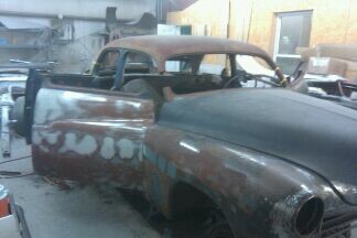

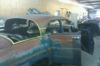

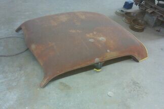

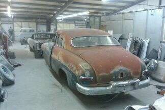

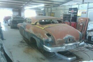

    OK Sorry for the long delay in updates but I have been working on the car instead of posting on here! Anyway here is where I am as of right now....I marked the car for a 4" front and a 4 1/5" rear chop and as I was snacking on my lunch one day I said "hey lets cut it on the outside of the tape marks instead of the inside!"......well stupidity insued and we did....or I should say I did just that so it became a 6 1/5 cut in the front and a 7 1/5 in the rear....lets just say that is way too much on a merc 4 door. SO thankfully I did have a extra merc 4 door on hand for any kind of mistakes I might make so I just said no big deal and went out back and whacked the roof off that car and cut the post on it and went to measuring and cutting and welding, what I ended up with is a 4 3/4 front chop and I dont really know in the rear for sure yet, I think it is about a 5 1/4. Anyways here are some pics as it sits for now, I hope to have all the roof welding finnished this week and be doing the top of the doors this weekend. Jim

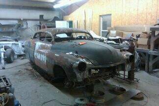

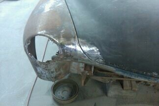

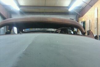

    Here are some more with the top a little more in the normal relm of chop...Jim

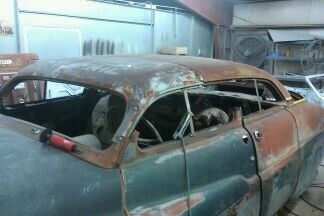

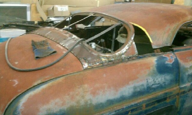

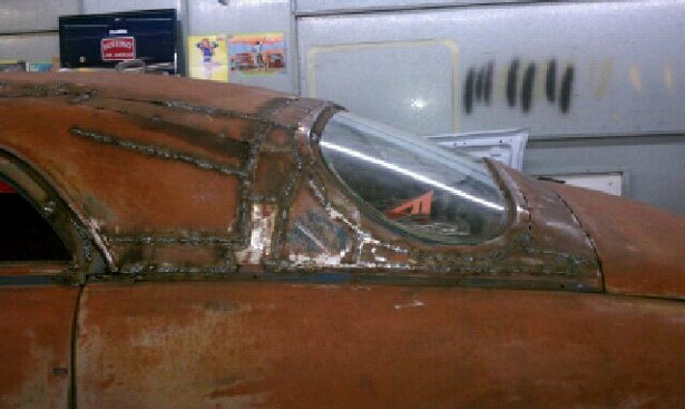

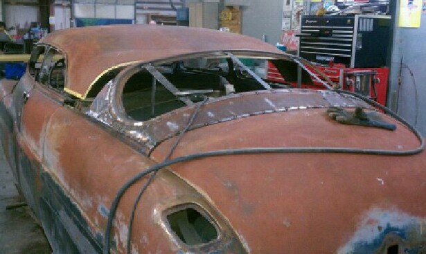

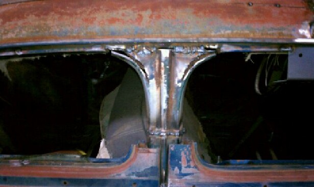

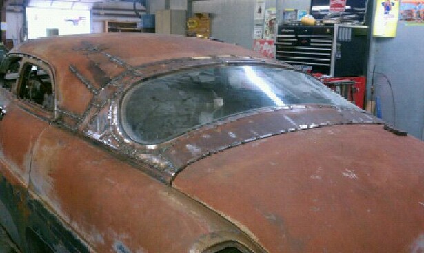

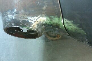

    Some more of the A pillar getting close and the b pillar getting some work done to it, them a little work getting done to the rear window area, if you would notice I flipped the rear window upside down on the car, something you dont see many people doing but with this big of a chop I thought it looked good. Jim

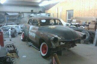

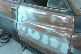

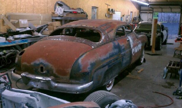

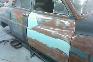

    OK Got a little bit more done, got the rear doors done, they have a bit of the dog leg in them yet still have the window shortened to the point they look almost like a coupe window, kinda a little of both worlds there, then the rear glass just looks great in my opinion, I love the way it worked out turned upside down in the car! I think it follows the lines of the car just perfect this way! Anyways here are some pics of it sitting on its new shoes now! Just got to finnish lowering the car soon, it looks like a 4x4 after the top chop.....Jim
