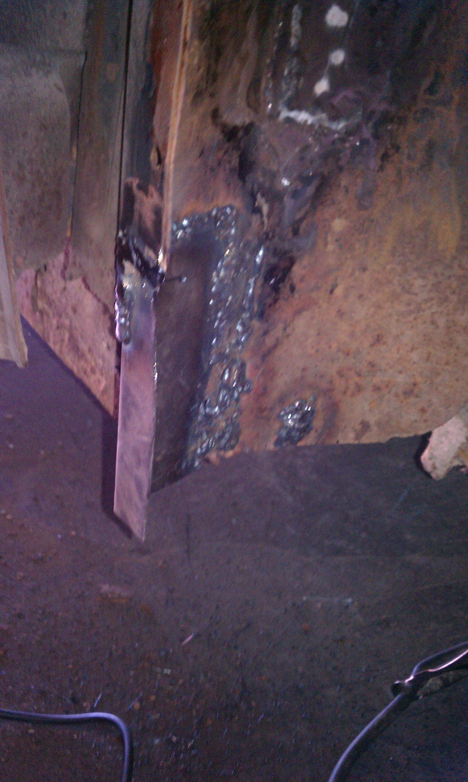

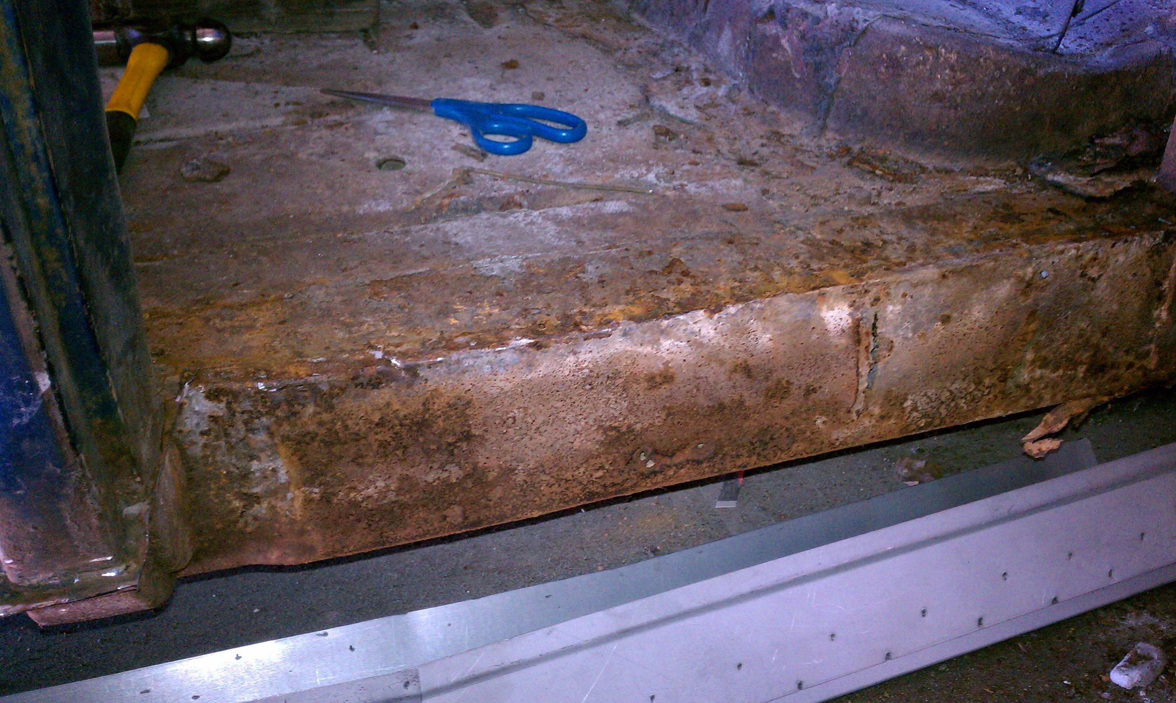

    OK Some updated, nothing real exciting on this car lately, just alot of rust repair.....did I mention I have been fixing rust, and then a little rust, I think that **** grows over night! I cut the rockers off and then found rust on the inner rockers, cut that out rust on the bracing behind that, there was rust in the inner fenders, rust on the brackets that the 1/4s bolt to, rust on the 1/4's just everywhere. But anyways here are some pics of it through out the rust removal and replacement over the last couple months. Jim

    Some more..
