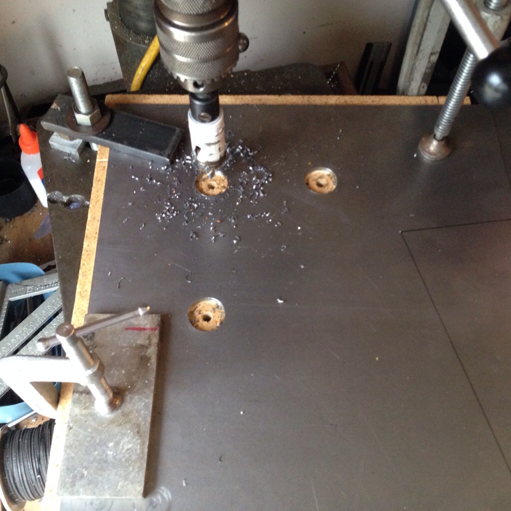

    Center punched and drilled – MDF backer will do double duty as the hammerform once I circle back with a larger holesaw.

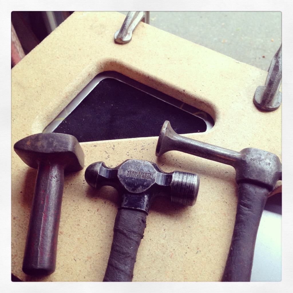

    Hammer.
    Form.
    3dnsouth likes this.
