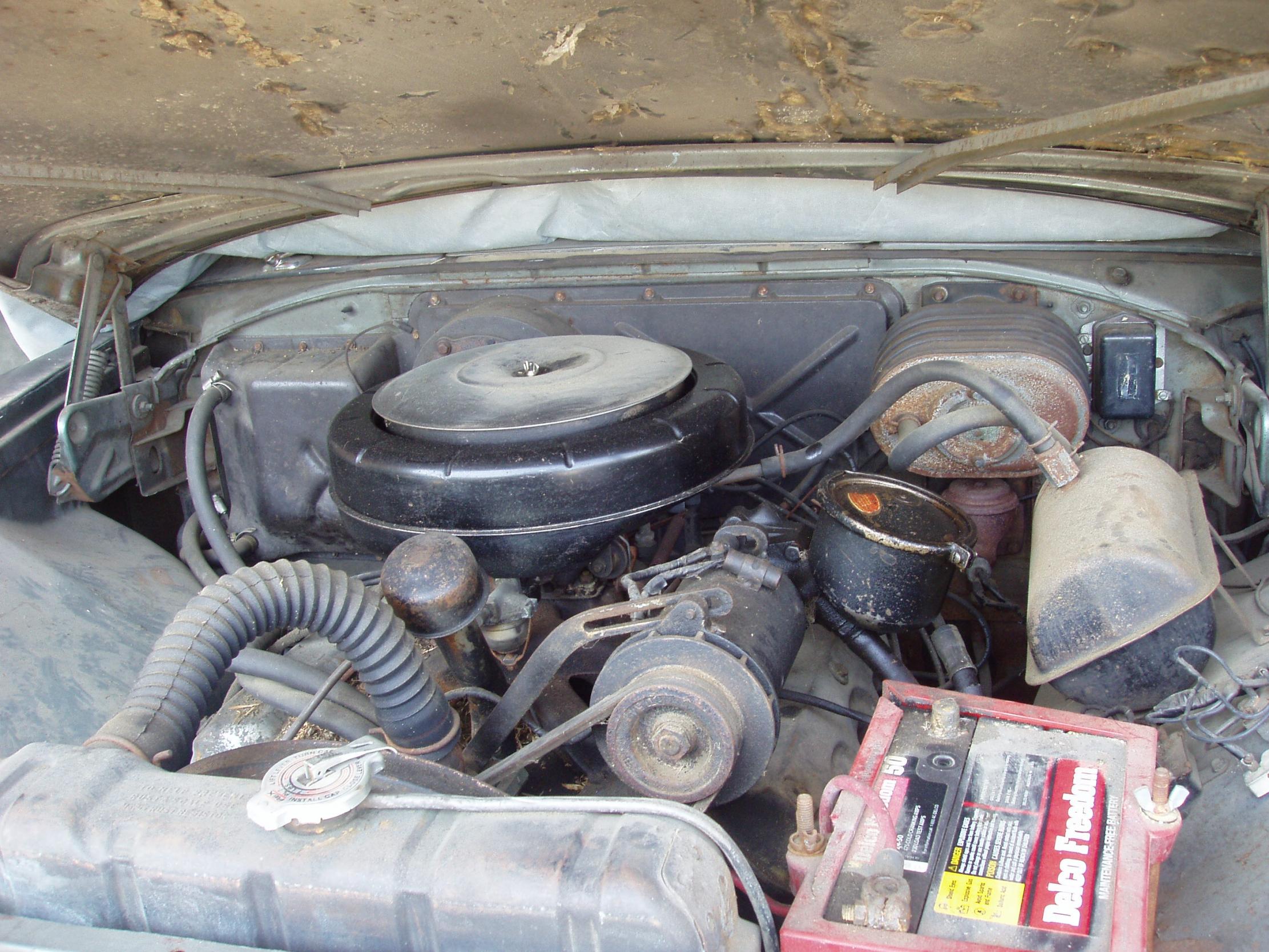

    In the mean time, hopefully I have attached a photo just before I put it away and one under the hood. chrysler0001.jpg

    Nice car, the forward look Mopars. I've got a 56 New Yorker myself, in the process of replacing window channel felt in the drivers door today.
    If it were mine, after that long of a sleep, I'd pull the valve covers and slowly turn the motor over by hand if you can, and have an assistant watch for valves that stay open. Some penetrating oil and a very light tap on the rocker tip will sometimes loosen them up if they're not stuck too tight. Sounds like you've got pretty much everything else covered.
