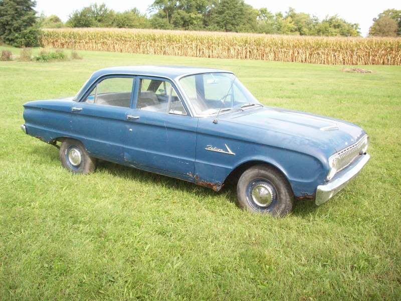

    Found a better side shot from when we first got it. The measurements for the drop ar kind of a guess as both ends of the car were lifted(!!???) by PO. Front suspension was topped out at rest and the rear had lift shackles that were 8 1/2" long!

    My guess for the "razing" is the typical sagging front springs and the worn and or cracked rear leafs. We actually adjusted the ride height on our 63 comet was to add a couple leafs and replace the cracked ones. being a convertible, it was needing alittle help getting level with the added weight and length behind the rear axle. They sure are funny looking jacked up in the air, (personal opinion) nice to see you all working together.

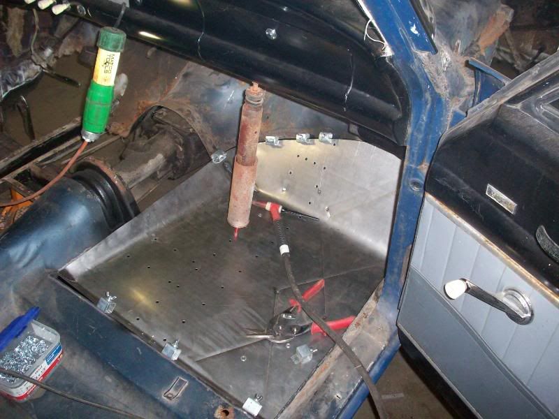

    Got the passenger floor final fitted and welded today.
    Note handy holder downer!
    Drivers side is nearly fitted, minor triming, drilling and paint it will be ready to weld.
    Not a lot of progress as it takes a while to butt weld all the seams and fill all 35(?) spots.

    For the record, those floor pans were made using no special tools, no bead roller, brake or shear.
    I did take lots of pics for a tech on how to do decent floor pans with a bench, hammer and some snips. Took about 45 minutes for each side and a total cost of 20 bucks.

    where is your car from? sure had a lot of rust on her. just curious about it.
  29. StevieJo
    Joined: Sep 28, 2009
    Posts: 20
    StevieJo
    It's from Illinois. Hubbie got her from a guy in Rushville and he had it sitting out in the yard for a couple of years.
