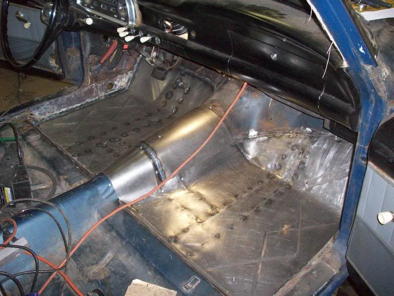

    Out with the old,
    In with the new, got the lines re-routed too. Front brakes are rebuilt and the rears get it tomorrow!
    Floors are done and welded in. The tunnel is done too, I made it removable so it will be easier to get the 5 speed in and modify floor brace.
    The tunnel will get welded in after the trans swap.

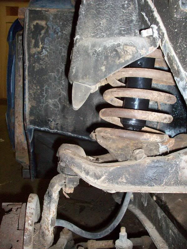

    after a day of fighting my daily all morning and some of the afternoon I got the new shocks picked up, shortened and installed,
    I also cut and welded the upper control arm to correct the balljoint angle.
    These were taken with the front end hanging on the shocks, it sits a couple inches lower.
    Note the ball joint angle, when the suspension is sitting on the snubber the joint is real close to binding. Since we are gonna move the snubber up a couple inches I figured I'd go ahead and fix it.
