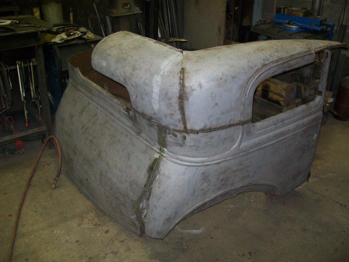

    I've had just a little time this weekend and I decided to start tacking my Vicky body together. I've never had one before, nor have I had the opportunity to work on one so there is a learning curve here. This is what I started with.

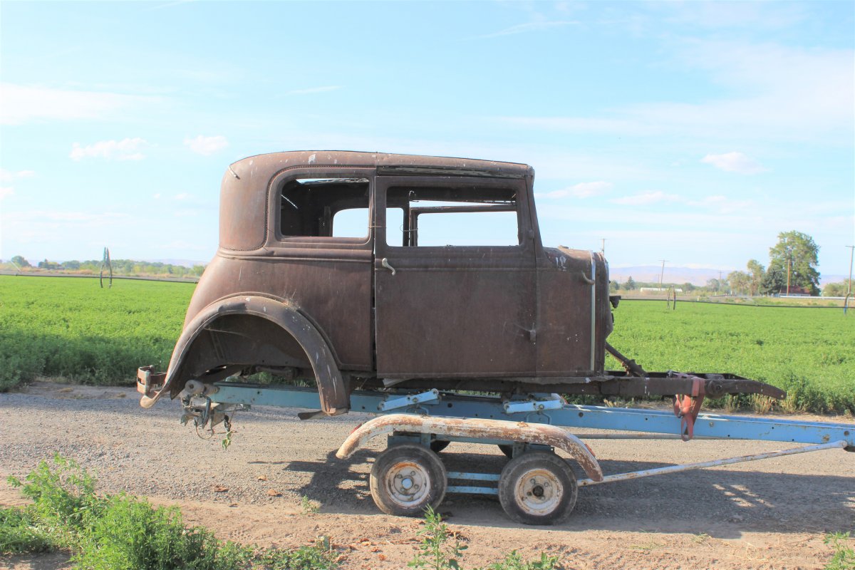

    I bought this from adam401 on here, (thanks again!). To get it home my wife helped me cut it into panels and stuff the whole thing in the back of my SUV for the ride back from Connecticut. After having all the panels blasted and the surface rust removed the shell is in remarkably good shape. 001.JPG 003.JPG 20170523_120837_Film1_1527879823955.jpg
    I've begun re***embly and adding a 3 1/4" chop that puts my side windows at 9", the same as a 4" chop on a '30-'31 A coupe. In my eyes perfect proportions. 001.JPG 001.JPG
    I know this is not how you put a body back together but because of the way it was cut apart I can reattach the panels at the same place. The wood frame was completely gone so I will subs***ute a steel structure to square and align the body. My frame foldings arrive Wednesday and I already have all the crossmembers and frame parts fabricated to build the ch***is.

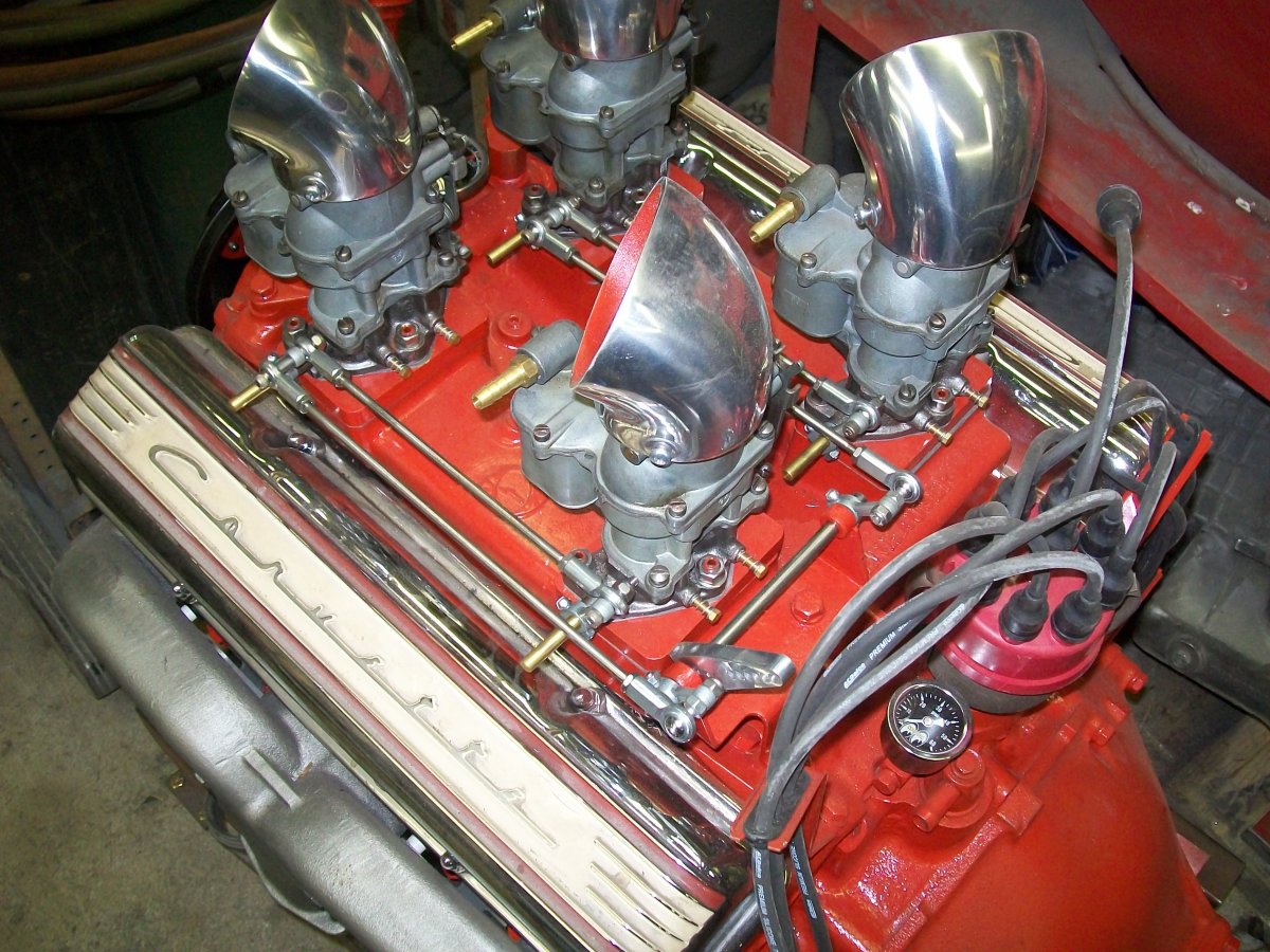

    Over the Spring I was able to screw together a really nice '57 283 with some goodies and a Clay Smith cam, 4x2's and old Mallory. The trans is the unusual, for a rod, Muncie 318 with a Sparkomatic yoyo shifter, (thanks Pete!). There is also a really mint '40 banjo to bring up the rear and a load of vintage parts for the rest of this one.

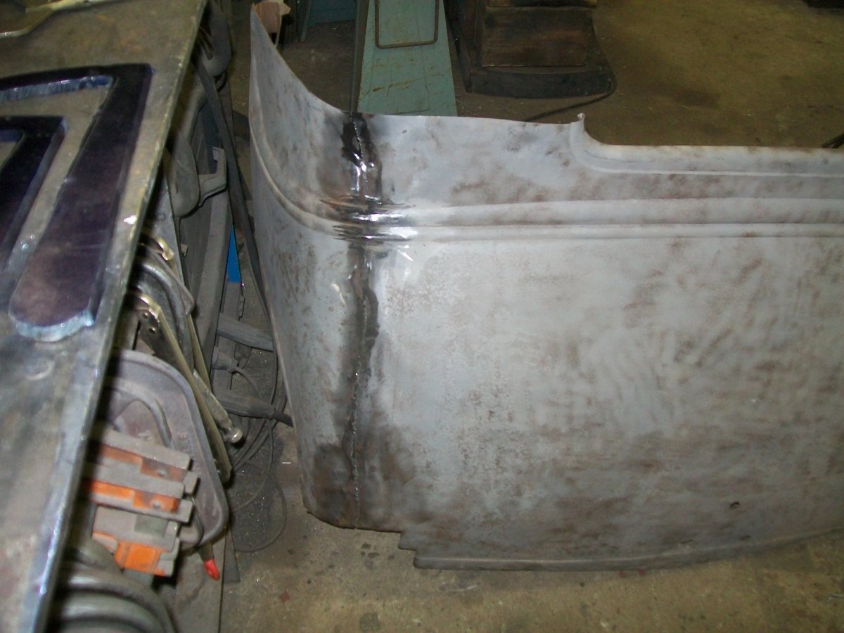

    The body was pretty bent up so I felt it a bit easier to straighten the panels, put the body together, and chop it at the same time. I've been using the cuts I made in Adams driveway as a reference point to make the chop work. I would have been way better off if I had my ch***is together and used that as a reference to square the body as I ***emble it. As I don't have anything to reference or any body dimensions I'm just welding what I know goes where and getting the body lines right on the rest. I'd like to put a solid roof on it and as such I need to get the roof perimeter on the money.

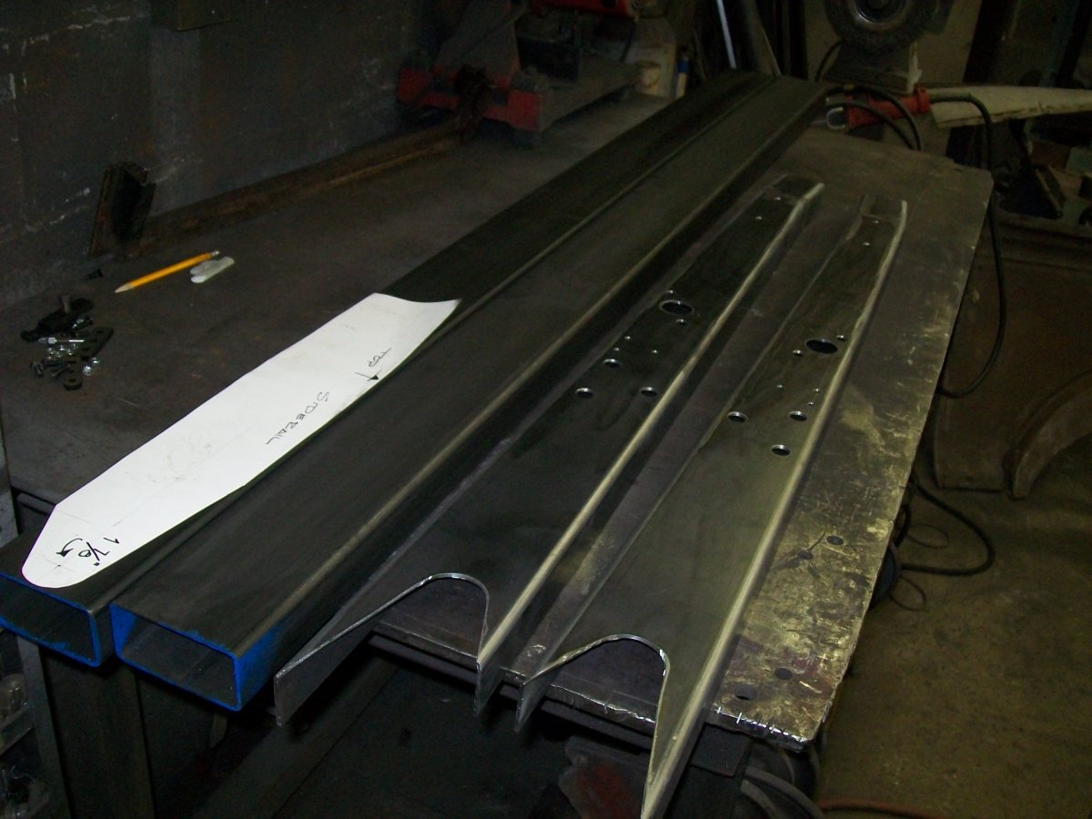

    Picked up my foldings from Steel and Metal Services on todays' morning parts run. Fred did a great job again! Right on tolerance. The crossmember I made a while ago. When properly gusseted it will take the spring ahead frontend nicely. I did a rework on the 'bones a week or so ago using a simple fixture on my steel bench. The axle is drilled to add a bit of flexibility.
    The last few days I've been trying to get a few hours in each night after the shop closes to work on my own stuff. It's been 11 years since I've had a car of my own on the road and I'm sensing my mortality. I really do need one more ride to Wildwood. This car will be no showpiece but it will drive great and do exactly what it needs to do.
    Last night I was able to get a little time in on some pick and dolly work on the shell. It is really getting quite nice for a bag of walnuts. With a little shrinking and file work it will be a really nice body. I do like the proportions of the side windows to the rear window etc. I am going to need to shorten the tail by 2 5/8" to make it work with the way I'm bringing my frame tails out. It will look very cool though. 001.JPG 001.JPG 002.JPG 003.JPG 004.JPG 005.JPG

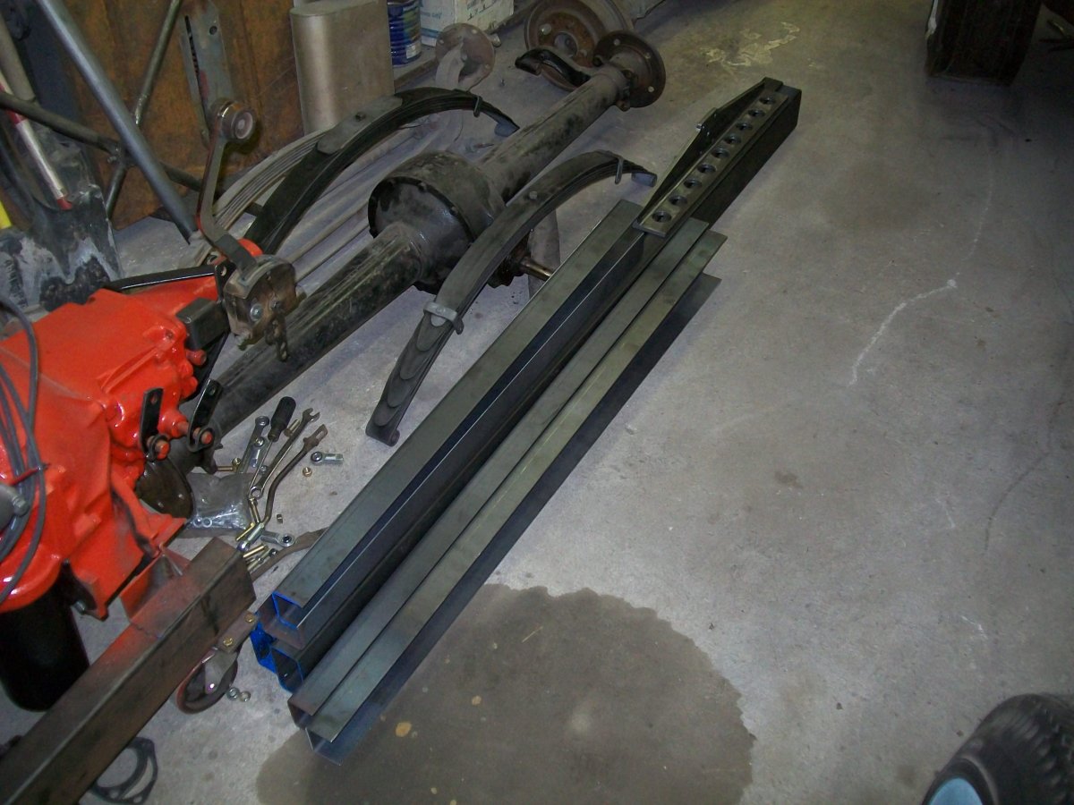

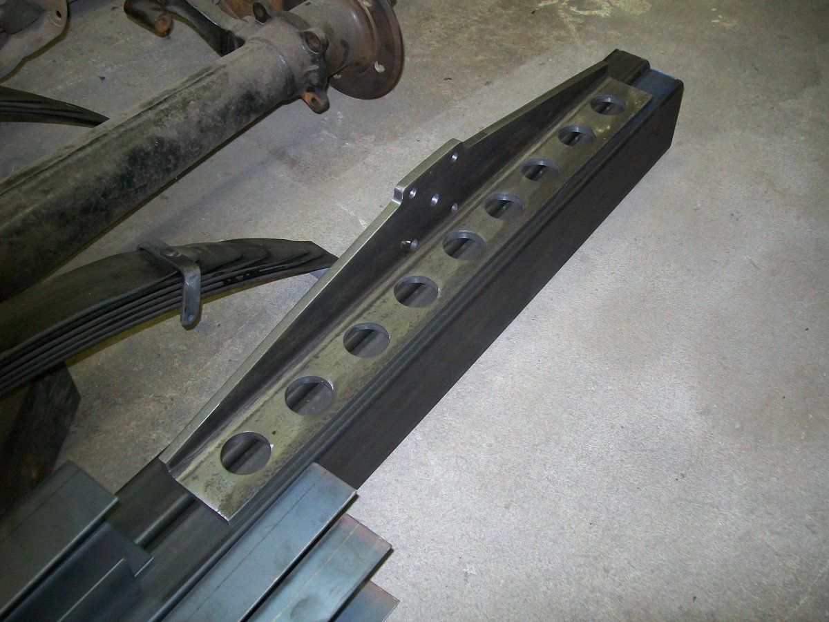

    Scavenged some time this weekend to ***emble and box the side rails for my frame. The folded parts were right on the money so it went together really easy. This is a quick and dirty frame, not like my usual stuff but it will get to Wildwood and back. Dimensionally, they are right on but just not as involved as they maybe should have been. They will be plenty strong and the only thing you will actually see is the front rails beside the engine and the bottom 1" of the side rails. They do have some nice tapers and the front rails look like they should, being 1 3/4" wide, with a square boxed inside like a real Model A frame would be.
    I have the rear setup to take a deuce dimension spreader bar and the exposed tails will look real nice out the back of the Vick body. I need to cut the reliefs to follow the A frame profile tonight and I'll set them aside until next weekend. The next step will be to lock them into the marriage fixture to allow the installation of the crossmembers and all related brackets. I placed tapered bungs to accept the rod ends for the front end and have a lot of the other stuff made already. Busy week in the shop here so next weekend until I can give it hell again. 003.JPG 004.JPG 005.JPG 006.JPG

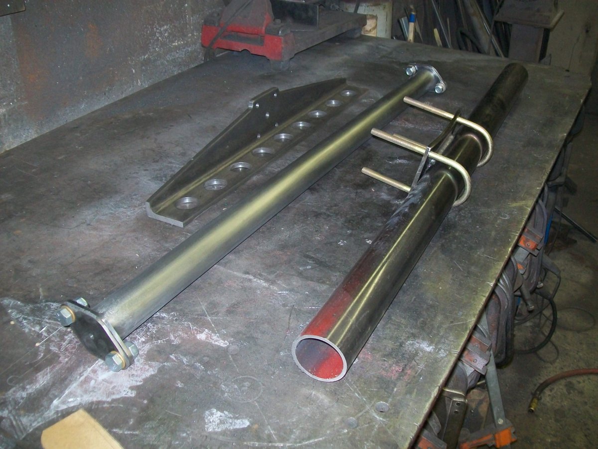

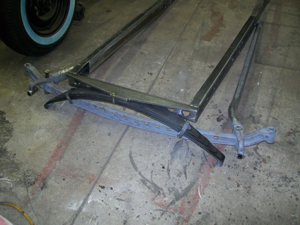

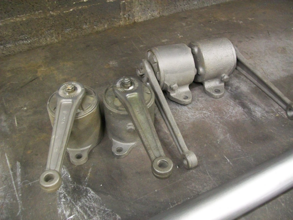

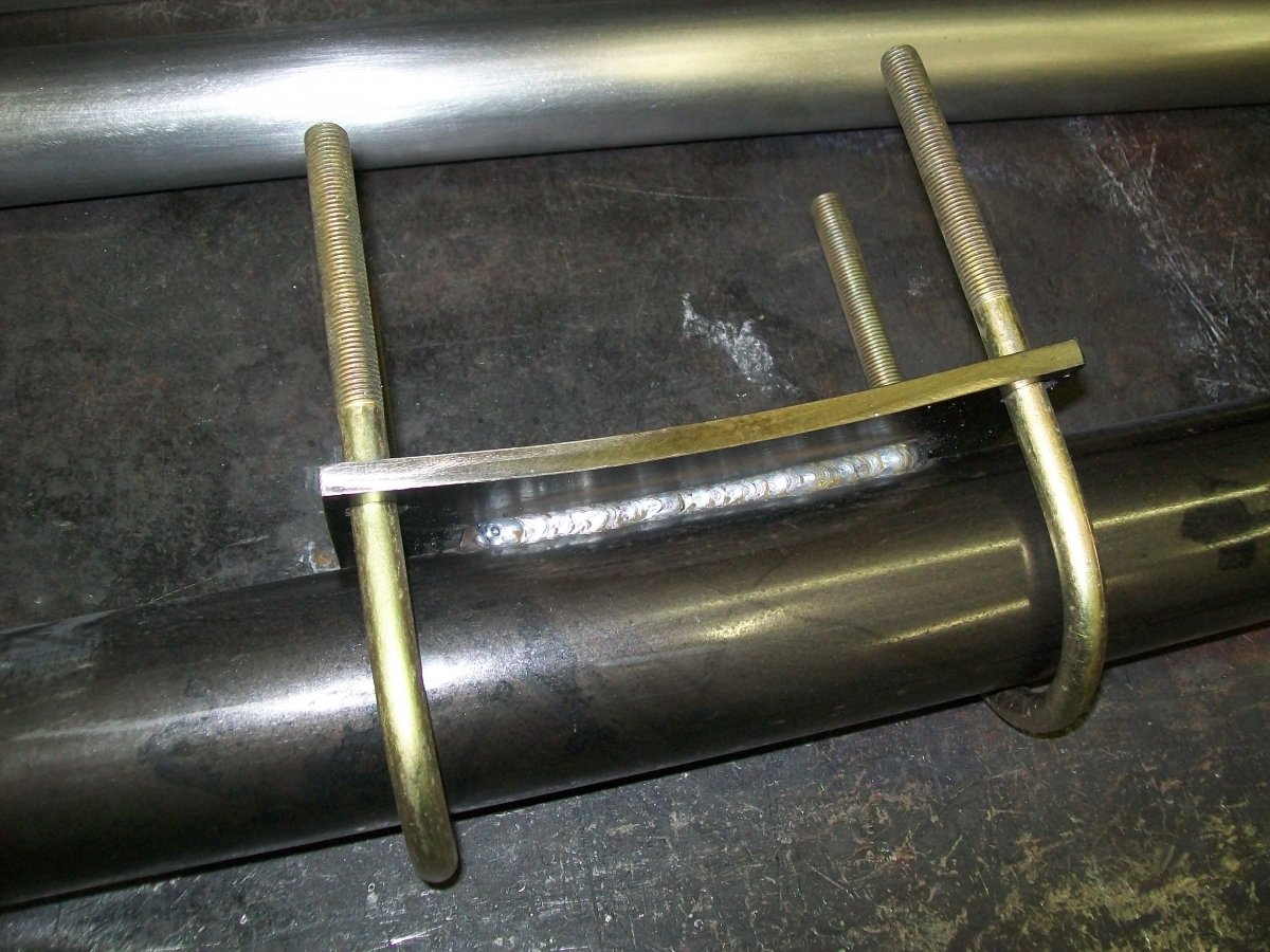

    Had a little time tonight and finished up my front and rear cross members and rear spreader bar. I was just going to order a bar from Speedway but they are only 14 ga. and the spacer plates are 1/8". I decided this might need a little more beef so I made this one up of 2", 3/16" wall mechanical tubing with 3/16" plates and spacers. I'm going to need to get the front cross member in to make the rest of the parts for this.
    The big question is, I have a set of front and rear Houdaille shocks that I would really like to use. I'm just a tad worried that they are too early for this car. Not sure when these disappeared from the scene but I'm placing this car in the very late '50's. Big decision here as I need to add plates and brackets in the frame to take them. Anybody have any thoughts on this? Some pics of what I'm up to.....

    They were still using those shocks on modified stock cars in the late '60's if that is any help. Bob

    On the other hand tube shocks had been used as OE on factory built cars for ten years by the late 50's. So tubes would also be an appropriate update for a newly built rod.

    Both good points. I wasn't sure when they disappeared from rodding. Ford went to "airplane" shocks in late '47-'48 and a lot of rodders went with the newer style. I'm using a spring ahead cross member, like the red one in the pic below. This pic is off the HAMB and I know the owner is on here, but I can't remember whos' car it is, so maybe he can jump in. It is on a full fendered '27. This should set the cross DSC06094.JPG member/spring just behind the pickup shell I'm using. If I use the Houdaille shocks I can set my '35 Ford pickup lights right where I want them.

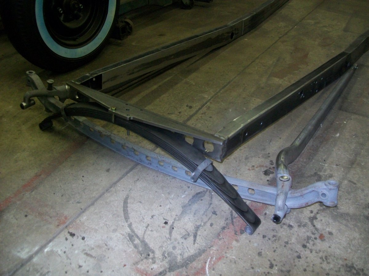

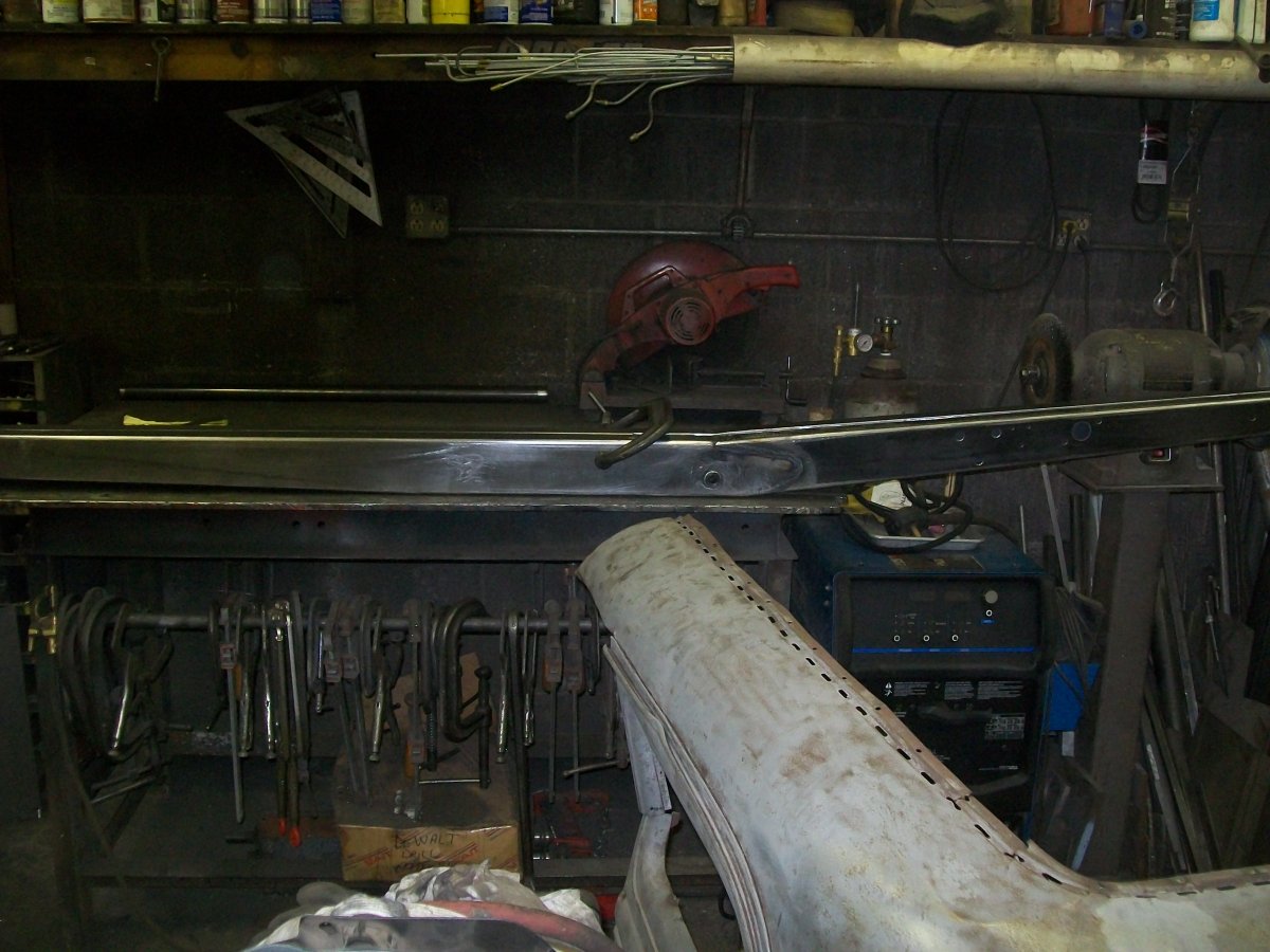

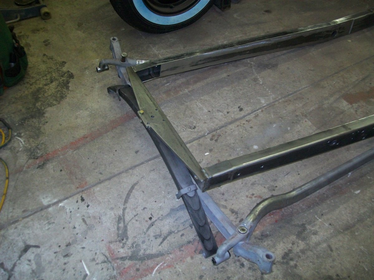

    Hot late night yesterday and I was able to get the rails and cross members out of the fixture. Nothing special but deadly square and on spec. I just roughly fitted the front suspension parts and everything is right on the money. Ride height is just as planned. I got lucky! Actually, I drafted a full set of 'prints on the ch***is so it would be pretty hard to screw up. There are sections of boxing plate both front and rear that need to be done and will greatly improve the appearance of the frame with some much needed detail. The frame looks light and spindly in the pics but is quite beefy when seen up close.
    I don't have any space in the shop to set another ch***is up so I'm going to make up the center section on the bench and add it to the rails as an ***embly. Id really like to get the engine and trans in there with the ch***is on ride height just to make sure everything clears nicely. Also I've developed a desire for a sectioned deuce radiator with an early core as opposed to just buying out one of the offshore rads that won't have a lot of character.
    I think the front end is working out fairly nice. Still a lot of work on this frame to get it on the wheels. 001.JPG 002.JPG 004.JPG 005.JPG 006.JPG 007.JPG 008.JPG

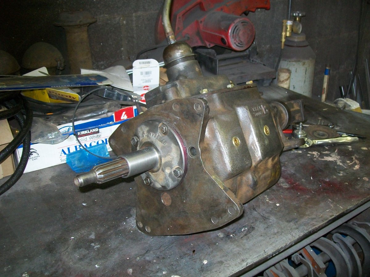

    As an alternative to my relatively weak Muncie 318 box I put together a Ford 3.03 Tremec with a Jeep T 150 top for the Vicky. This conversion has been covered many times on here and is easy to do. I milled the sideshift bungs off the case and tapped them for 3/8" pipe plugs after hitting the work with a needle scaler to put the cast texture in. This saves an inch+ in the legroom area. The front bearing retainer was turned down to Chevy dimensions and this setup will drop right in back of the Chevy 'bell. I picked up a very nice stick from my buddy Pete and grafted it to the Jeep stub so it will look like and early Ford box but is way stronger and full synchro. I need to finish up the weld on the stick but I'm out of Argo 001.JPG 002.JPG 003.JPG n on a holiday weekend so it will need to wait for Tuesday. I have also put these in back of flattys and they work great. Ratios are very close to the typical early Ford "78" case trans. Just some late night stuff in the shop.
