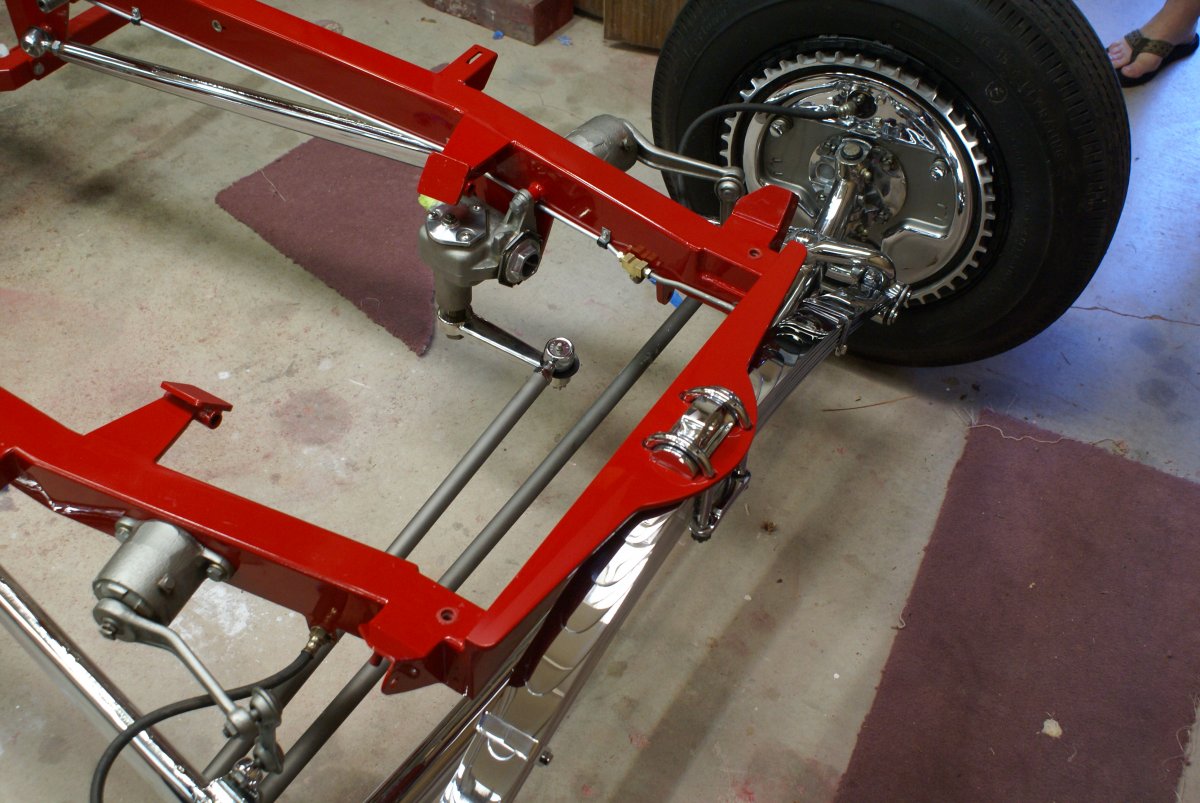

    My roadster originally built in 1956-7 came with with the Houdaille shocks so it was an easy choice to re-use them, plus there isn't a lot of room under T fenders.
    I don't have any pics of how I mounted them, but I drilled through both sides of the frame and welded in threaded tubing to bolt the shocks to.
    I don't have a lot of suspension travel but the shocks seem to work great. DSC06202.JPG

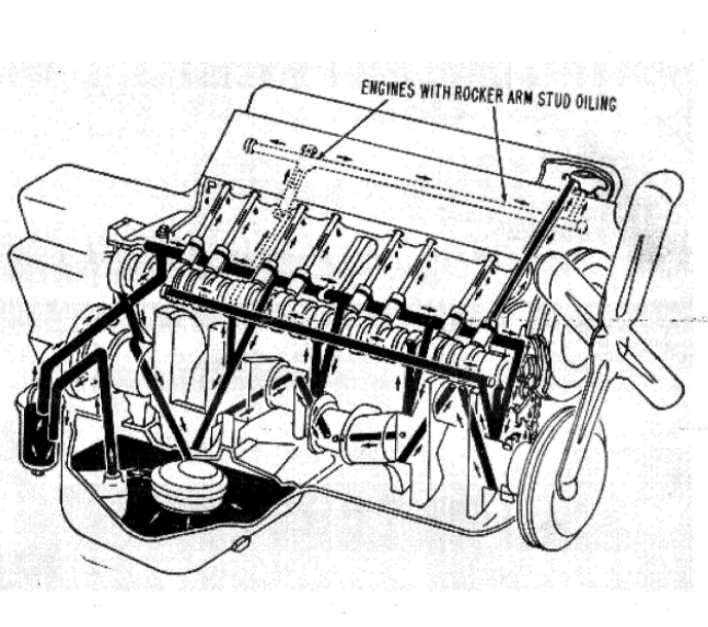

    Just an FYI (and please confirm to make sure). I just finished machine work on a 389 and my machinist said the pressure connection (where you have your oil pressure gauge in the pics above) are filter pressure. He recommended to me to use the small pipe plug just to the side of the distributor for a more accurate reading of oil pressure at the bearings (cam and crank). My machinist made the comment to me after he saw that I had my gauge sender screwed into the same port where you have your mechanical gauge............

    Damn! Thanks much for the "Heads up"! I've put them down there on Chevys and the like for some time and didn't know the Pontiacs were different. I'll pop an extra gauge up top temporarily to see the difference and then when it's in the car I'll use the top port. I had no idea!

    This is a diagram posted on the Butler Performance website. You can see the oil leaves the oil pump and goes into the filter. The connection on the back of the block will be more representative of pressure your bearings are seeing.
    To be honest, unless you are just constantly thrashing your engine, I think either one would work.......but there is a difference.
    Is this your first Pontiac engine? When you freshened the engine, did you remember to install the oil galley orifices in the back of the block?

    I really didn't go through the whole engine. This was supposed to be a 40K engine and from the looks of the bores etc, it probably is. I just cleaned things up a bit, (it actually was near spotless inside and out), and re***embled it after checking tolerances as I went. I did replace the pistons with some 9-1 and just stoned the bores to let the new rings seat. So in fact it's more like a junk yard motor than a rebuild. It is a composite of three motors I picked up very reasonably. In short, I never got that into the block to pull plugs or even the cam bearings. If it lasts one summer I'm happy. I spent most of the time on it getting it as clean as possible both inside and out and making the brackets that allow it to fit in the tight space I have to work with.

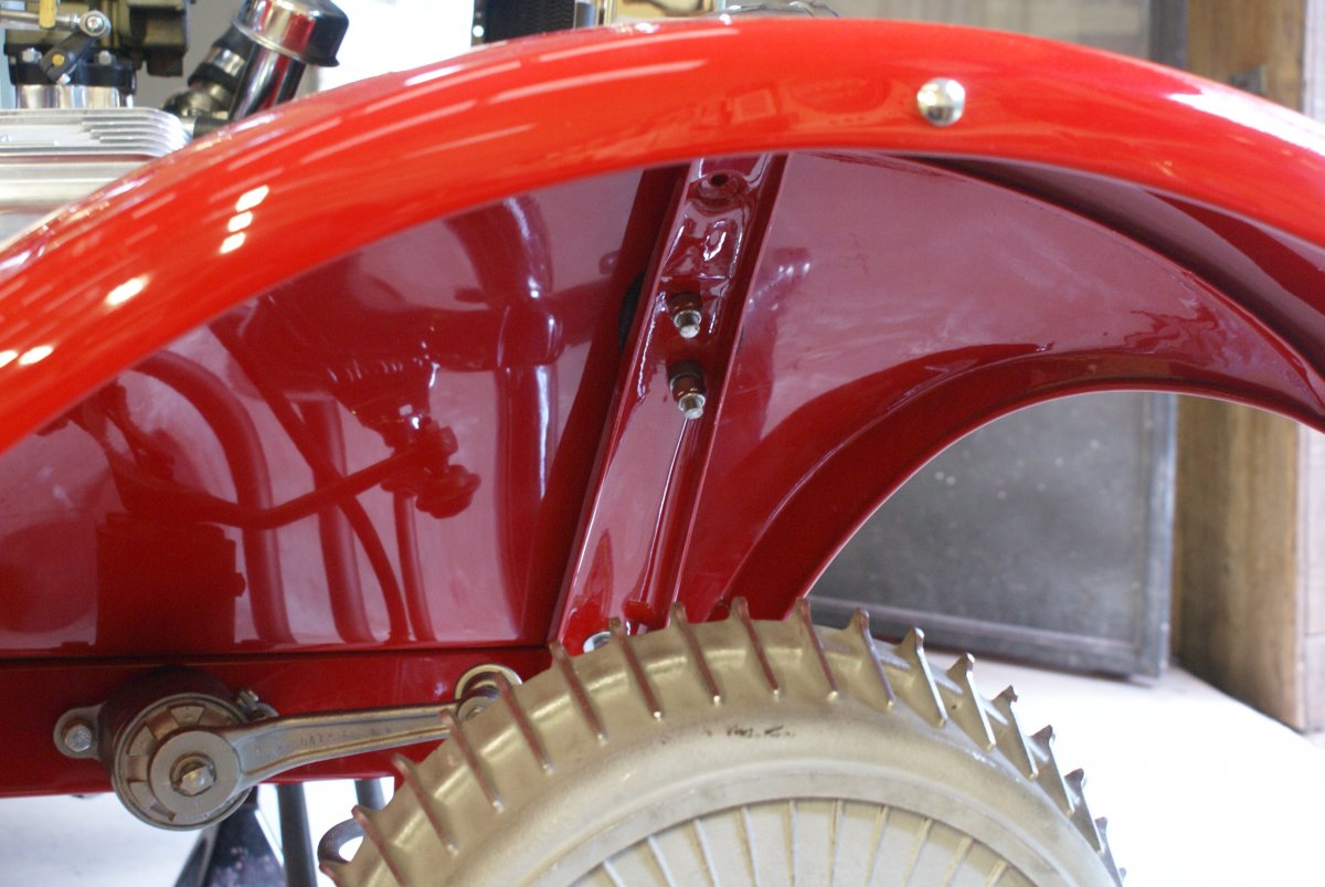

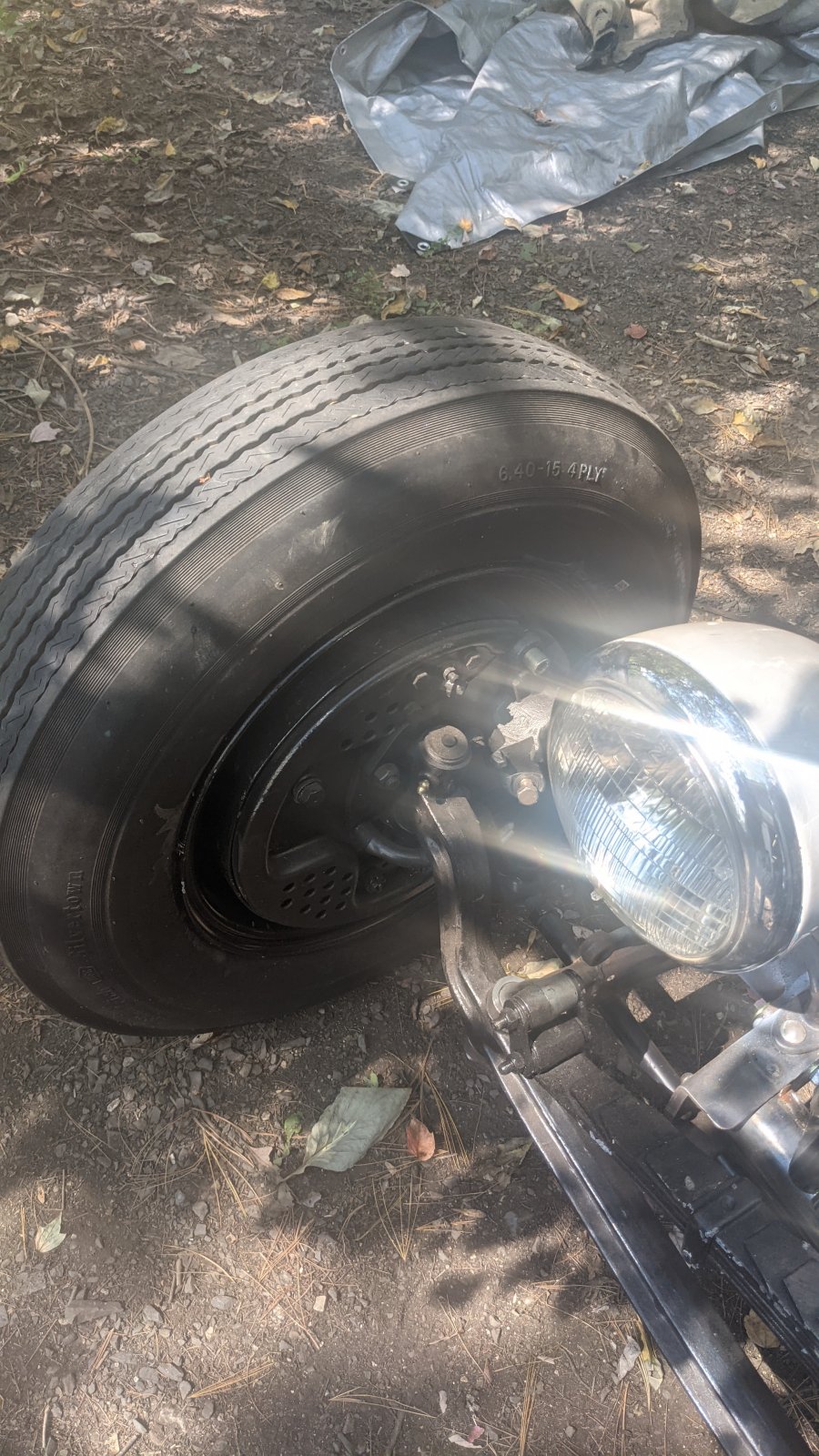

    Working on it between shop projects. I need to run discs on it because of my feet so I took a little time and made some covers for the fronts to kind of mask the ugly. With the wheels on it doesn't look too ugly at all. Also a lot of other fabrication done so it's pretty much ready to go together for the last time. I'm going to set it up again next week so I can finish out the body work and get it squirted while I have a window in the shop open here. Thanks for asking. You keep me motivated!

    That is a nice fabrication..that should tuck into the rim nicely...and get the big poncho slowed down in an admirable fashion...

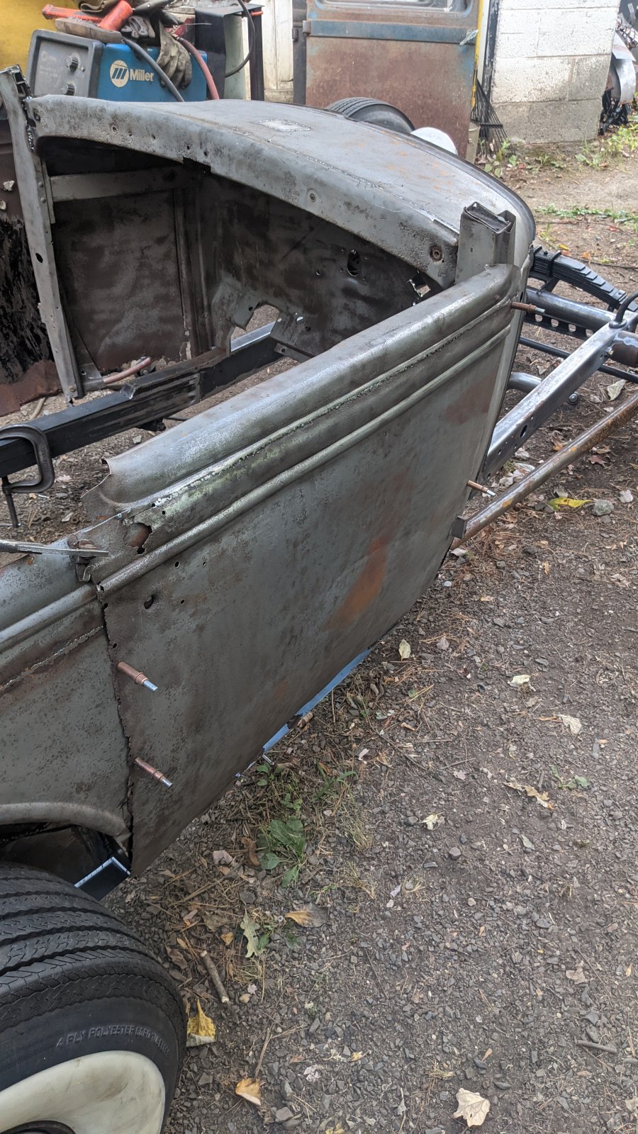

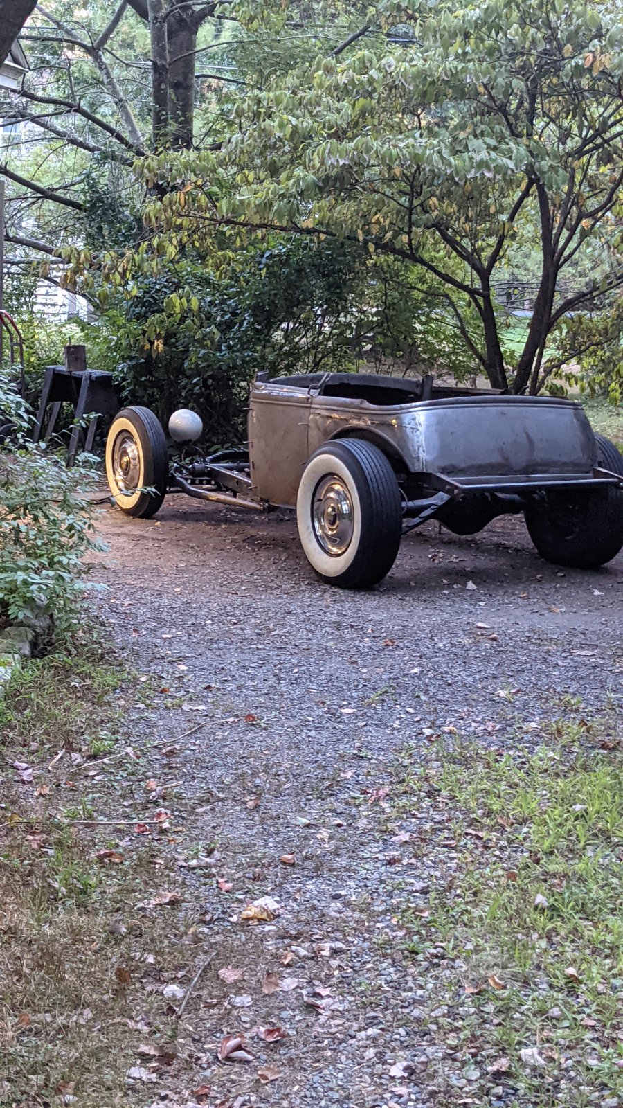

    PXL_20220821_145243080.jpg A quick update......
    As discussed above I've come to the realization I'd rather have something to drive as opposed to a great project ****ing up shop space I can't spare so here goes. A few pics of as it sets. We put the Pontiac in my buddies '34 as he was almost ready to roll but was in need of power so it got him on the road. Also I donated my frame to another buddy who was in need of a platform to begin his roadster pickup project. Frames are easy for me to build and I know he appreciated it.
    I kept my front end and rear along with the body panels. A couple weeks ago I took a Sunday and knocked out a quicky frame to take my axles. In the interest of time and money I decided to whack the body into a similar one on the cover of the above magazine. In the last few nights I fitted the panels to ch***is with a whole lot of slice and dice. As the frame has a 3" Doane Spencer style sweep and the body a 2" channel I needed to move the wheel wells up 4 1/2" to get them where they looked right. The section job and some stretching and shrinking left the rest of the body panels fall into place. still a lot of panels to make for this although they are all super simple. I've got some ideas for the tail that I'm working on today. This has all been done so far on late night time after work and a little weekend stuff.
    The pics don't do it justice as the proportion is spot on. I have the body braced up now and it is very square and symmetrical. Adam 401 did me a huge favor p***ing this one along to me. The shell is being set up to take one of my aluminum lift off roofs that Homemade hardtop57 is going to cover in Hartzcloth for me. I know whacking up a relatively rare body for something like this will not sit well but the amount of work to restore it was just out of the question. I just want something to drive and this is it. Time to make door templates and get them swinging. I may make them as overlay style doors. I know Vickys had insets is but I just like the way they look.

    I forgot to mention, the shop is packed full with 4 cars so I'm building this in the driveway. I guess that makes it traditional?

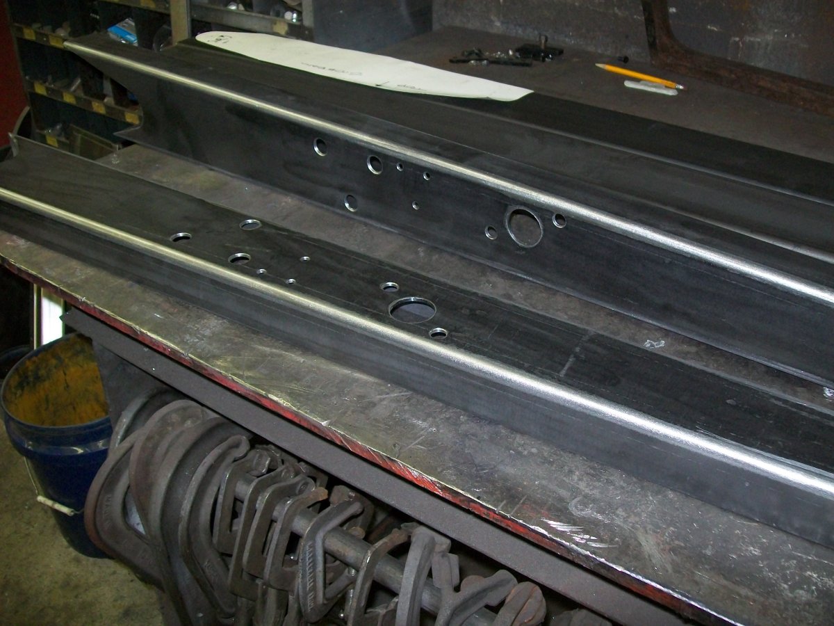

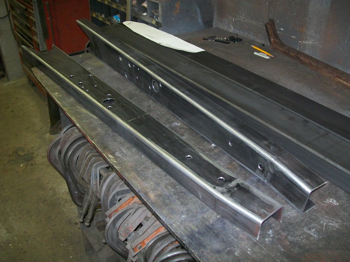

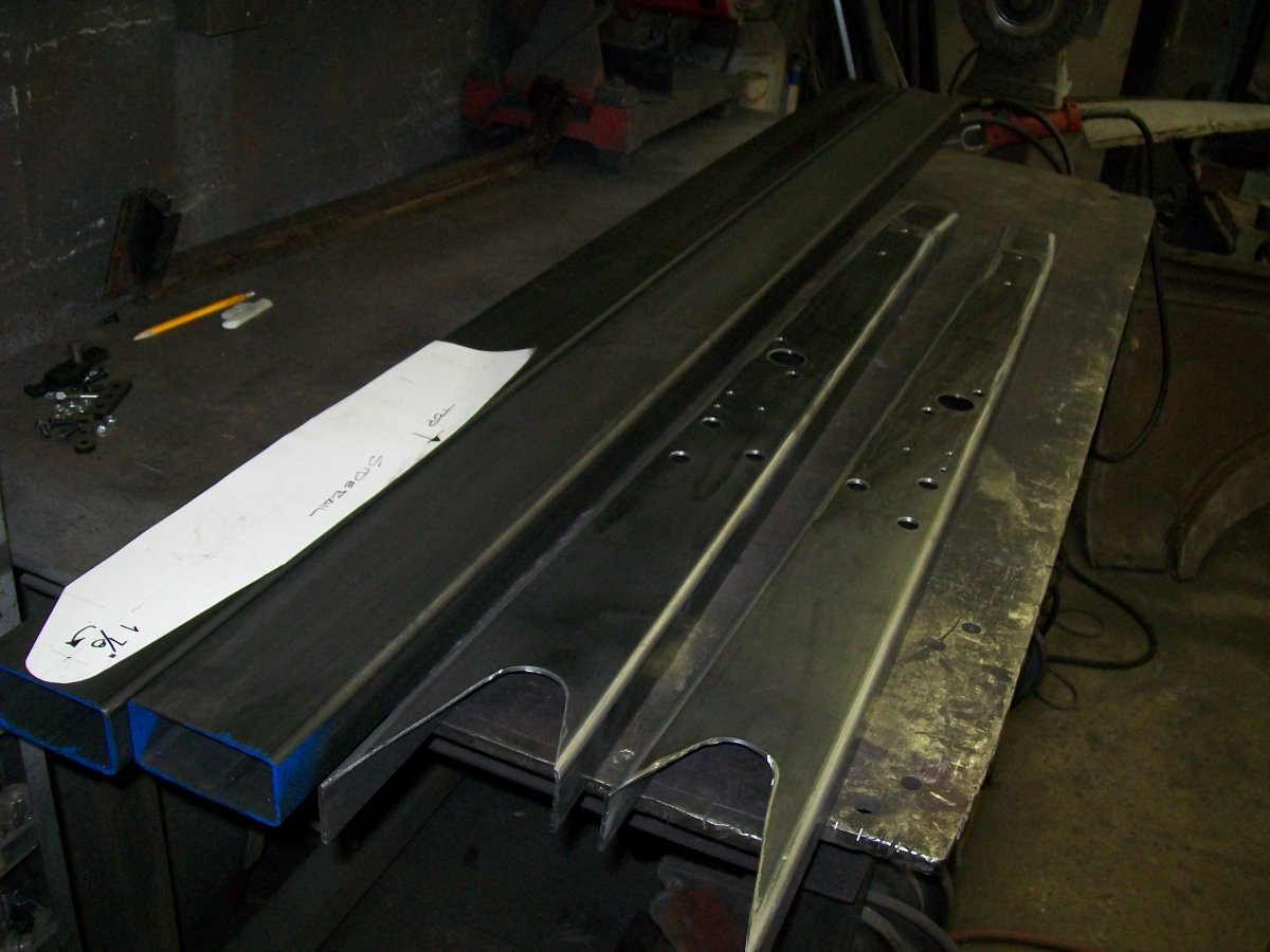

    Your Vicky seems to be as bad as what I started with a few years back. Mine had been in a fire and every stick of wood that had been in that car was burned away. Like yours, there was no top in the front half and in the back all there was was some drooping "metal" that was so full of holes that it looked like some kind of lace. The bottoms of the doors inside and out were rotted away and long gone and the cowl was too rotten to use and even the gas tank top was unusable because at some point, it had exploded and reshaped itself like a puffer fish. Over the following months, my father and I managed to make a decent body out of it, building a roof, adding a 32 cowl, firewall, windshield frame and windshield header and fitting it to an spare 32 ch***is that I had pulled out from under another old project and we put it all in epoxy primer to protect it until the day comes that I go ahead and finish it or at least get it running.
