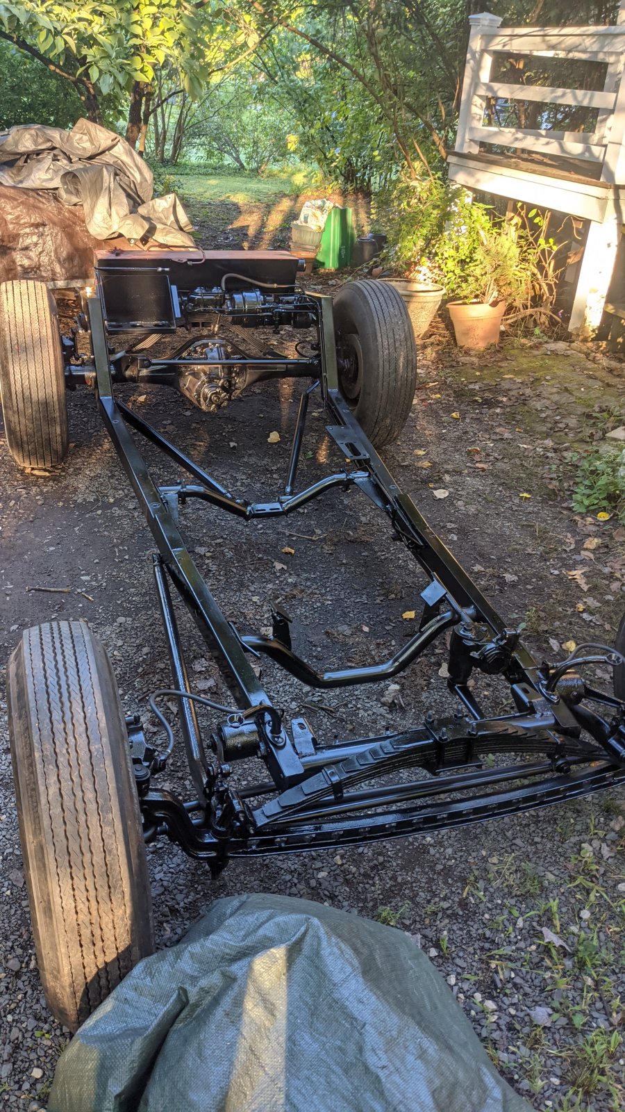

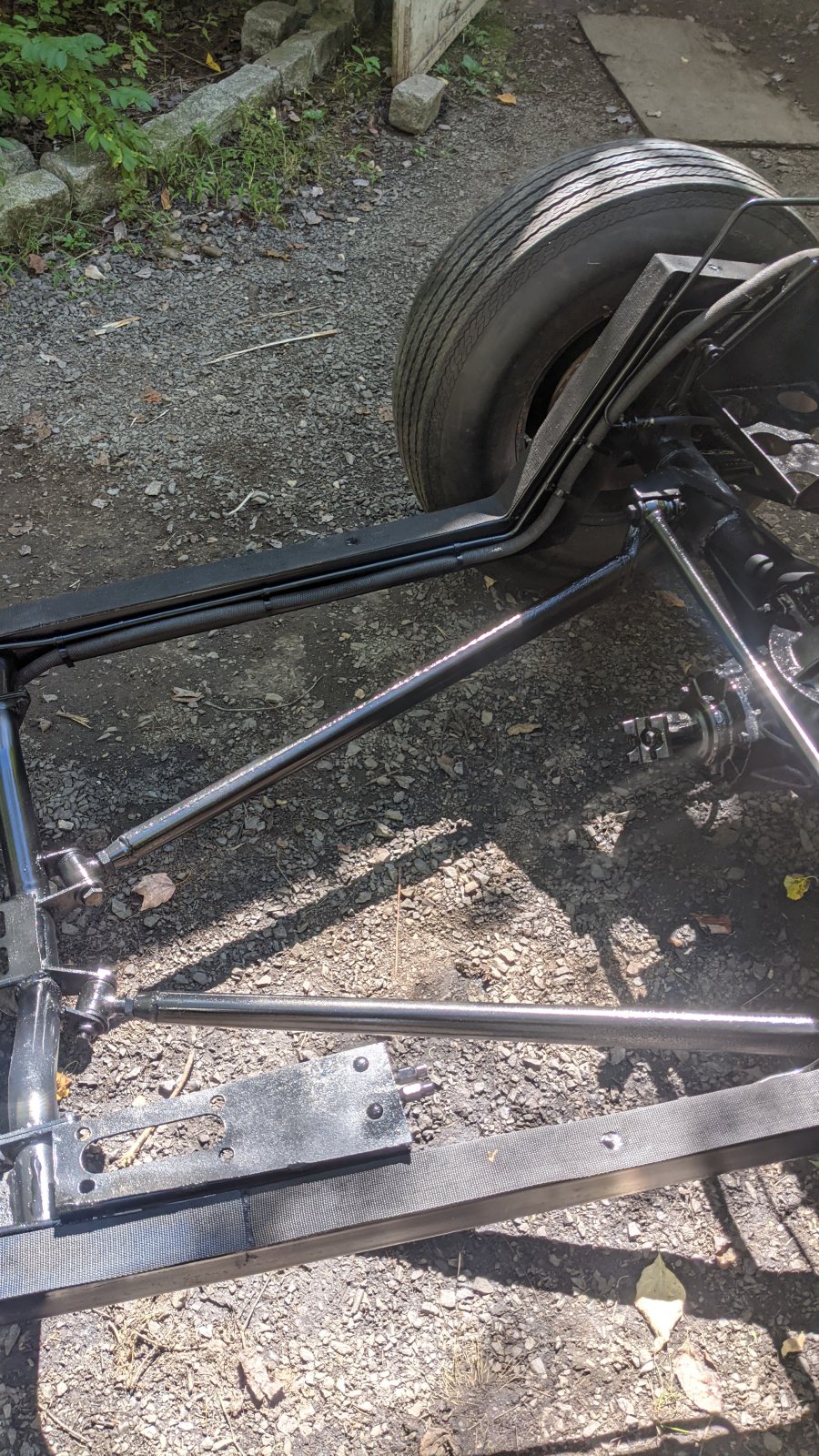

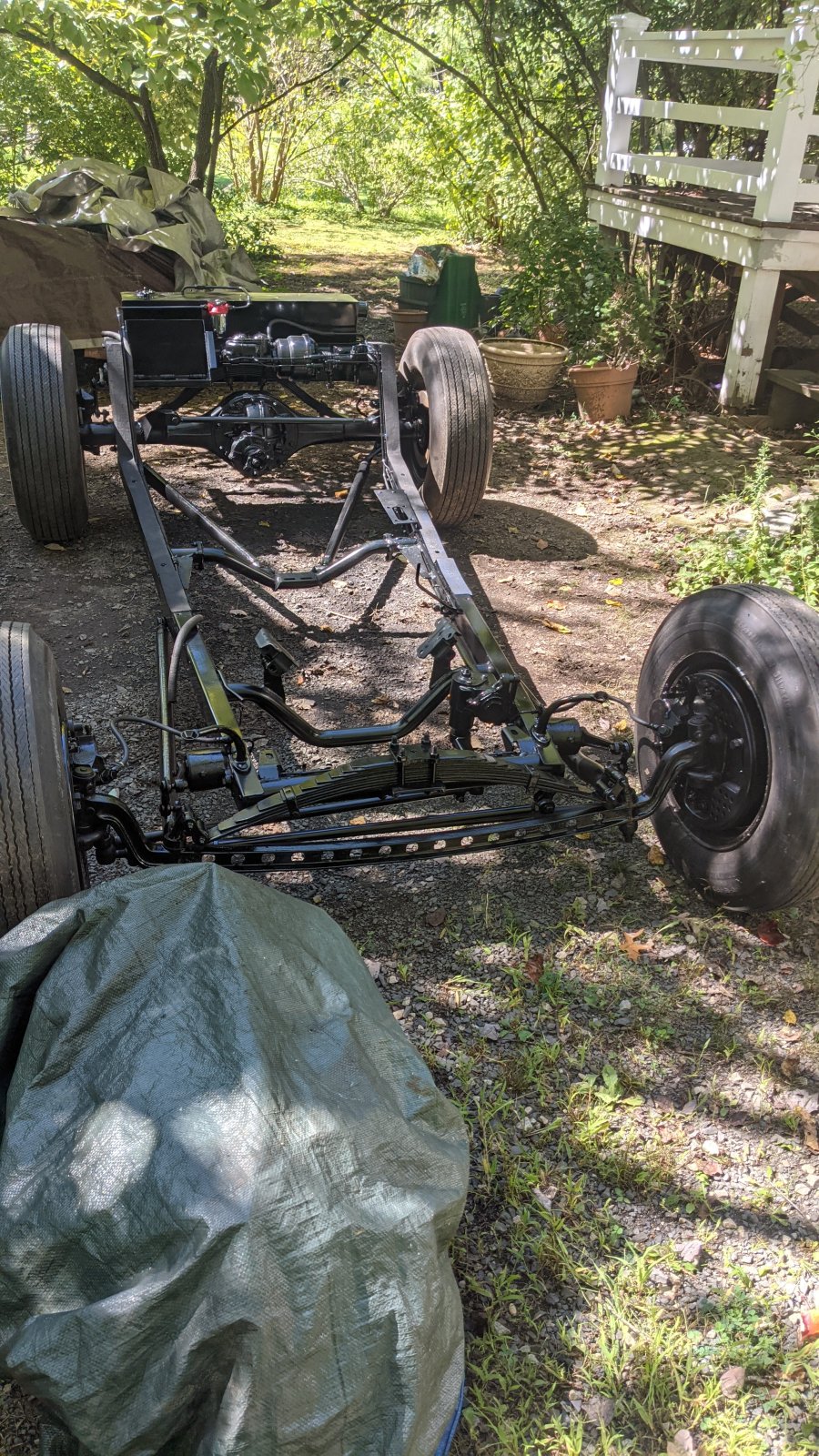

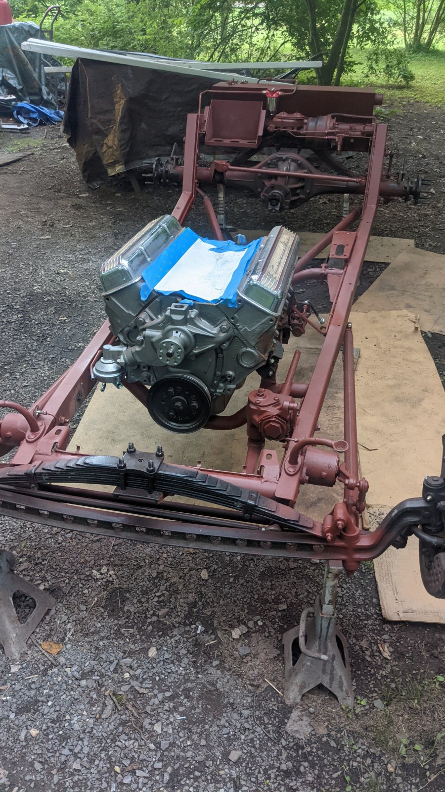

    Everything done on the ch***is except I need about a half day of Scotchbright and 180 paper. I detest shooting this in the drive but it will be three months until a bay opens up. I'm putting some plastic and cardboard down and I'll go to it. I'm just shooting the whole mess together with the appropriate stuff masked. I could go with Rustoleum gloss black. Anybody know what hardner to put in with it? Never used it before but would probably work just fine here. Obviously lifting the engine/trans out to paint. Also mcsfabrication on here was nice enough to p*** along the right bellhousing so I'm swapping out the '57 one on there now for the correct one for my trans while it's out.
    PXL_20230727_234152284.jpg PXL_20230727_234200086.MP.jpg PXL_20230727_234208128.jpg

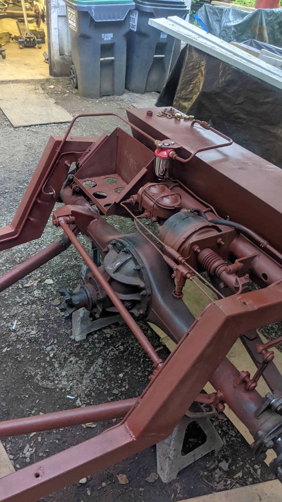

  8. Why fog the whole damn thing in red oxide? Makes all your hard earned work look cheap
    Koz likes this.
  9. Koz
    Joined: May 5, 2008
    Posts: 2,786
    Koz
    I agree it doesn't look good in red oxide. I shot everything, after Scotchbrighting it, that was bare metal because it had developed a slight "haze", (rust), from setting out under tarp for the last few months. I've used red oxide for years on structural steel to kill the haze with great results. It locks on well and after a few days curing sands and takes typical sealer nicely. I usually shoot my ch***is in Eastwood Ceramic Ch***is Black over a sealer as it is damn near bullit proof but I might just shoot this one in Rustoleum as an experiment on my own car.
    The alternative would be to take everything apart, have it blasted with a fine abrasive, prep and paint and re***emble. I don't think this car is at that level by any means. It's pretty much a patched together beater in reality, just a well thought out one. I'll do a decent job of prepping it before paint and most of this doesn't show anyway. If I wait to get it inside it will be pretty rusted up and I really don't want it outside over the winter unpainted. It's a compromise I need to make. I would have needed to blast the frame and ch***is components to epoxy primer it, which is the right way to do it.

    I've gotten the ch***is all sanded out to 240 and scotch brighted the weird stuff, (like lines etc.). Sanded up really nice for red oxide if you let it kick a bit. I chickened out and used Eastwood 2K Ceramic ch***is black on everything in gloss. It didn't get too ugly for a driveway job, somewhere between a Sears vacuum cleaner sprayer and rattle cans. Actually I shot a solid coat with my Devilbiss and let it flash. I then gave it a wet wash coat that actually doesn't look too bad. I'm going to give it a day or two and hit the front part of the rails you see with a lambs wool to take out a bit of orange peel and some of the to be expected dust from a driveway job.
    As I welded tap down clips for all the wiring harnesses when I did my lines putting the jute loom on is a no brainer. I want to get all the wiring underneath done before I set the body on, way easier. Finish up the loose ends and set the motor/trans in next. Feels like I'm making at least some progress here!

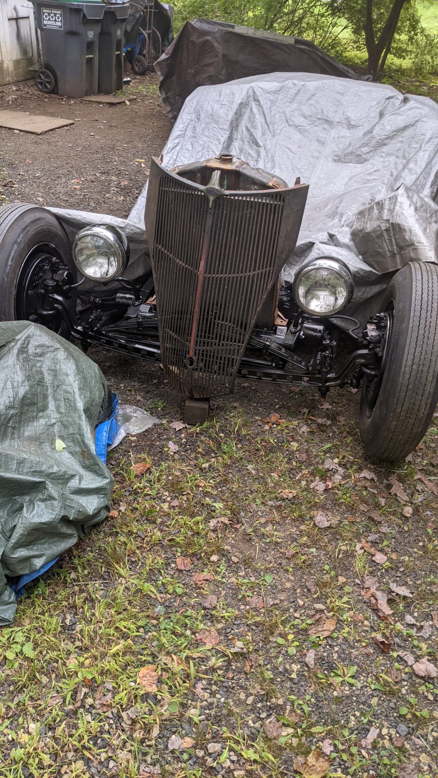

    I know this has been done about 12,000 times but I'm negotiating on this '36 grille. It really looks good because it fits over the suicide mount "just right". It would take a bit of metalwork, particularly on the hood but I can deal with that. I also think the pointy look would go well with the rest of the body lines nicely. I've never been totally happy with the Chinesium one I have on there.

    Shot the headlights and got some pics across the front. Didn't rub them out yet. Pretty neat but needs the corners filled a bit. Parking lights will help.

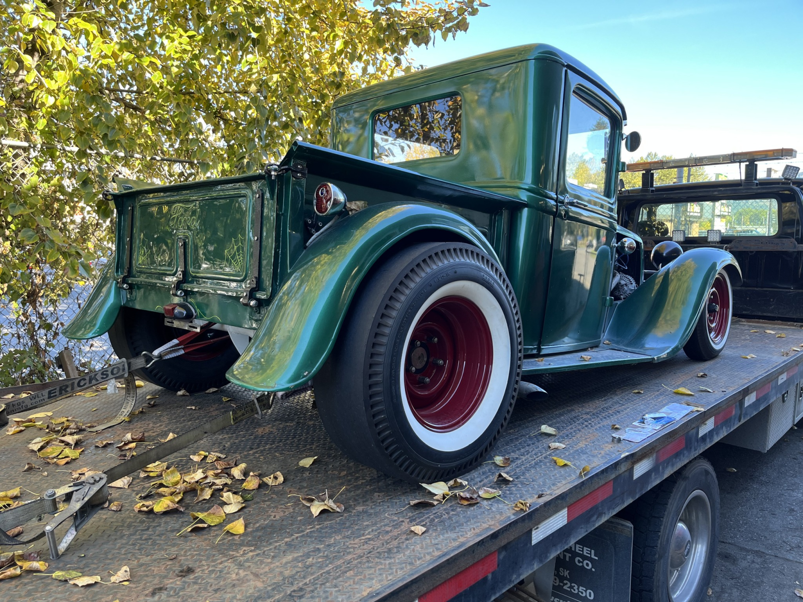

    The one I was talking about earlier. I know the builder is on here. Really cool but very different than my Vicky.

  21. Wasn't that Brian from Kalamazoo?
    Six Ball, Stogy, Koz and 1 other person like this.
  22. That was built by @flynbrian48
    Six Ball, Stogy and Koz like this.

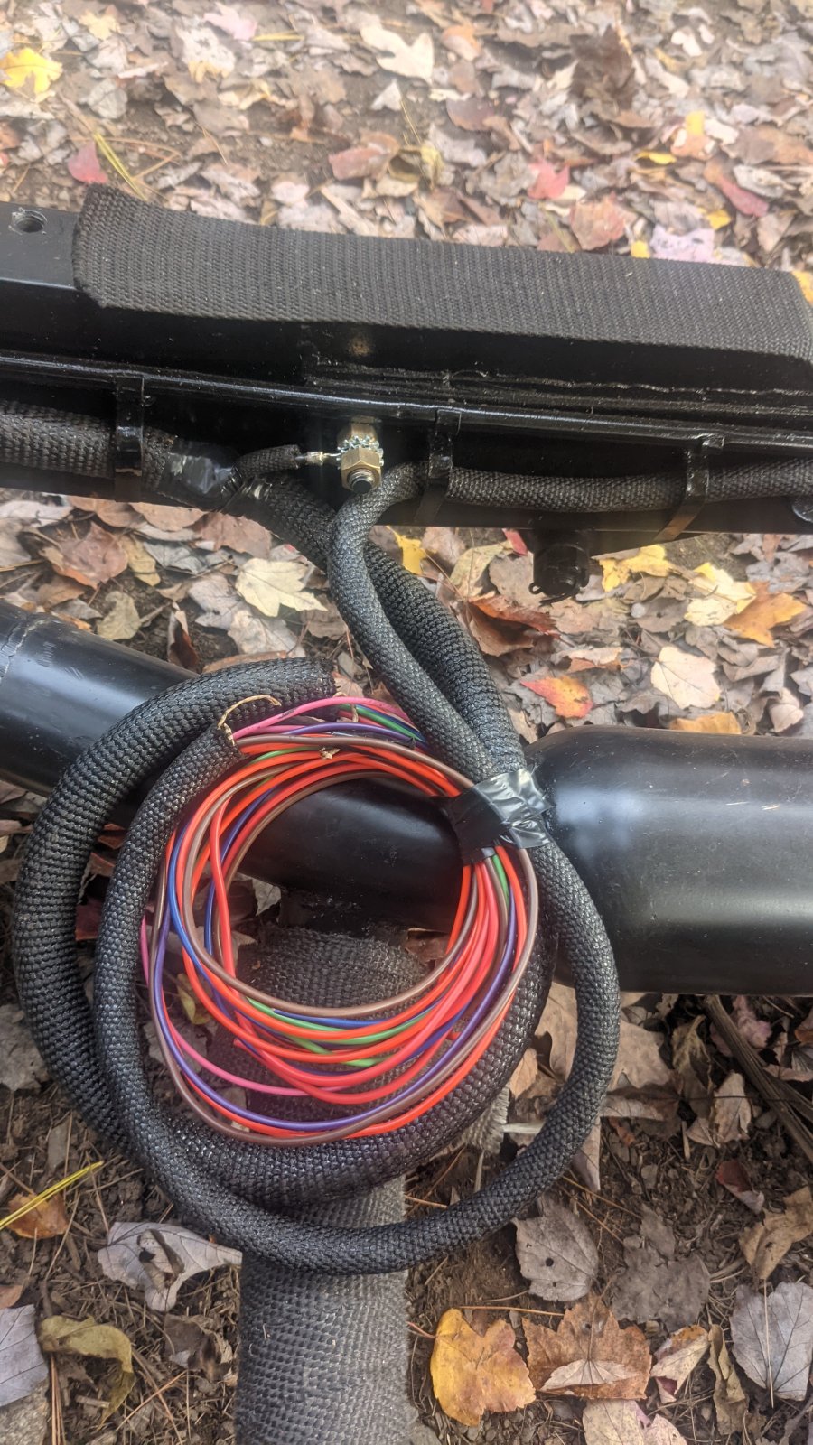

    Finished up the rough in on the ch***is wiring. All in old jute style loom from Brillman, with designated grounds for everything on to 3/8" br*** studs/nuts brazed into the frame. Just another step toward dropping the engine in. The only ch***is work I have to do yet is add the battery cables and weld on the bracket, which I missed, for the motor mount chain on the left side. The ch***is paint is super easy to touch up so no big deal as I haven't blocked or rubbed out any of it yet. The front and rear looms in the first pic feed through some rubber grommets in the toeboard near the firewall to the fuse block under the dash. The tabs on the frame will be clenched onto the loom when the battery cable goes in. I need to set the motor in to get a proper length on the cable before I make it up though. Easy peasy!
    Working on ***embling the last of the motor/trans setup to drop that in. A lot of the parts that I was missing came this week. Going to be good to hear it run after all this time. Some pics for your perusal.
    PXL_20231025_212234781.jpg PXL_20231025_212248049.jpg PXL_20231025_212301183.jpg
