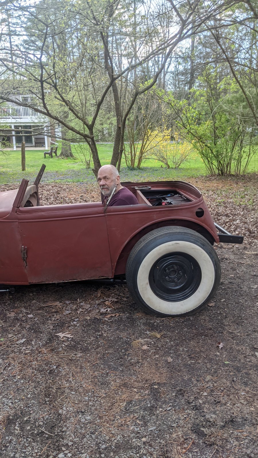

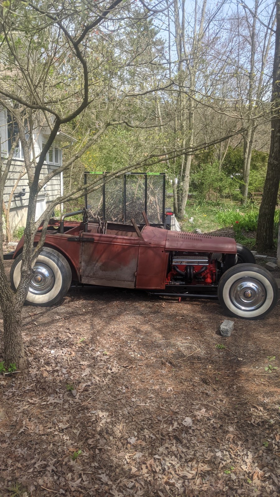

    I've got the body back on and bolted down with proper oak blocking strips and webbing underneath. Over the winter I finished out the underside and seam sealed everything along with prime and Eastwood ceramic ch***is black. I then coated the underside with rubberized undercoating and added band sawn oak blocking to nest the body onto the frame. Still a bag of walnuts but I keep pounding out and welding up all the problem areas. Working on finishing out the dash today to get my electricals up so I can at least fire the engine,
    I have a good bit of concern over the health of the cam with the valve springs in the heads on there. The heads are just so nice I hate to swap out the springs. I'm going to chance it and if I flat a lobe I'll just bite the bullet for a roller cam. At the moment I have a Weiand duel plane and 750 Holley on it just because I know it works well and I need to fire the fresh motor. When I have time I can go through the trips and make the swap. The Holleys run so well I may just leave it on.
    I don't have a grill shell on at the moment as that jury is still out. Summer is coming way too fast. I need to keep my *** in gear. Some pics for your perusal.

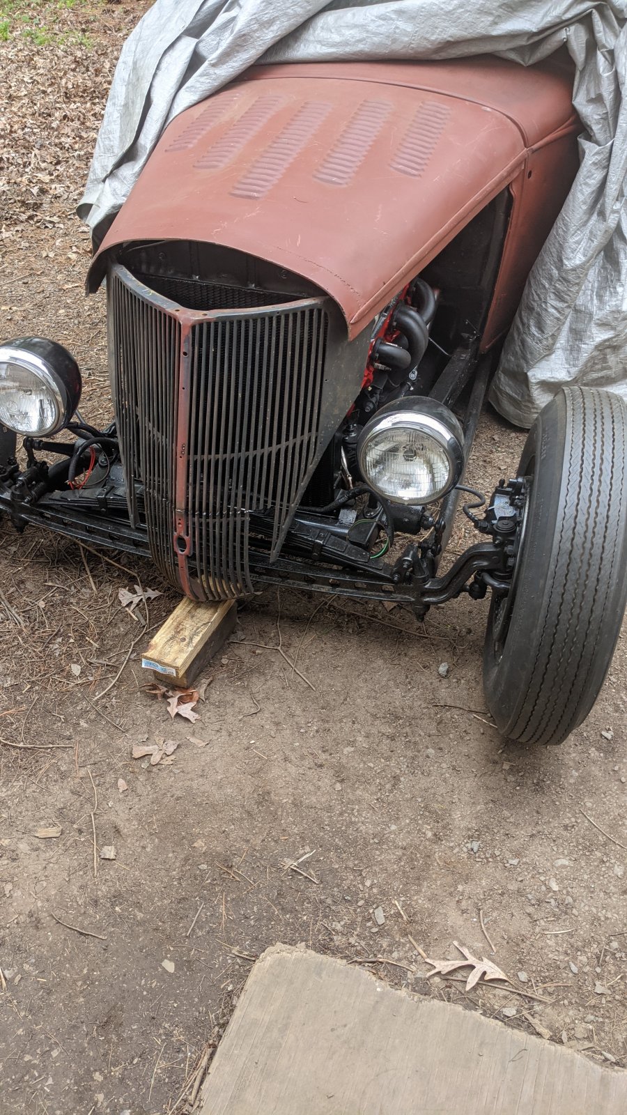

    Spent a few hours last evening chopping the '36 grill 5 1/8" to a workable height. I had a lot of concern if this would have the look so I really dragged my feet on this one. I think it looks actually a tad better than the full height shell. I still have a lot to do but up close it actually enhances the lines of the low roadster. With the hood shortened to fit everything came into proportion nicely. I'm trying to tuck an hour of two each night into finishing this up so I'm making a bit of progress.
    My next stunt is to finish the grill up and fit the hood along with fabbing a buck to form a peaked front to the hood like a '36. I'm also working on a hinge setup like an old Buick to open the hood sideways along with a proper latch.

    Looking good! Have you thought of using a 1936- 39 era headlight bucket cut in half for the front of the hood? You save on some hammer time. Bob

    Great idea there. I'll make up the front in two pieces of 18 ga. as one of the things that is so easy for me is rolling panels. I have some AK s****s laying around that will shape so nicely. The hard part is going to be making the hinge system work. To keep the lines right I need to have a very low crown on the "nose" to clear the radiator cap underneath. This, and making and fitting the doors up is the fun stuff. Actually, all the stuff that I don't particularly like to do is done on this one. The last pain of a job is going to be covering the whole body with lightweight and sanding it into the shape of an old Ford.

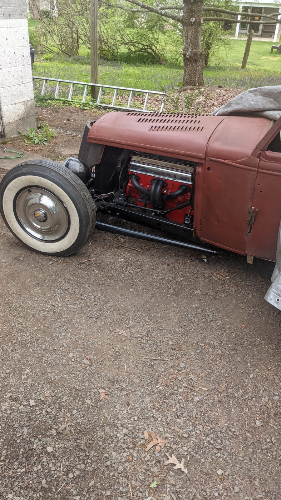

    My shop is packed so it's outside or nothing. You wouldn't believe how many people stop by just for a look. Today after work I took about two hours and pounded out the nosecone. from some s****s of 18ga, A lot of hammer work to go yet but I like the look. When I'm finished welding it up I'll get on and shrink as needed and take as many divots out as I can. Kind of a bag of walnuts at the moment.
    Tonight I'm bending up some 2 1/2" skirts for the sides of the hood like a stock '31. They will have the 3/4" bead like a stock hood.
    Let me know what you think.
