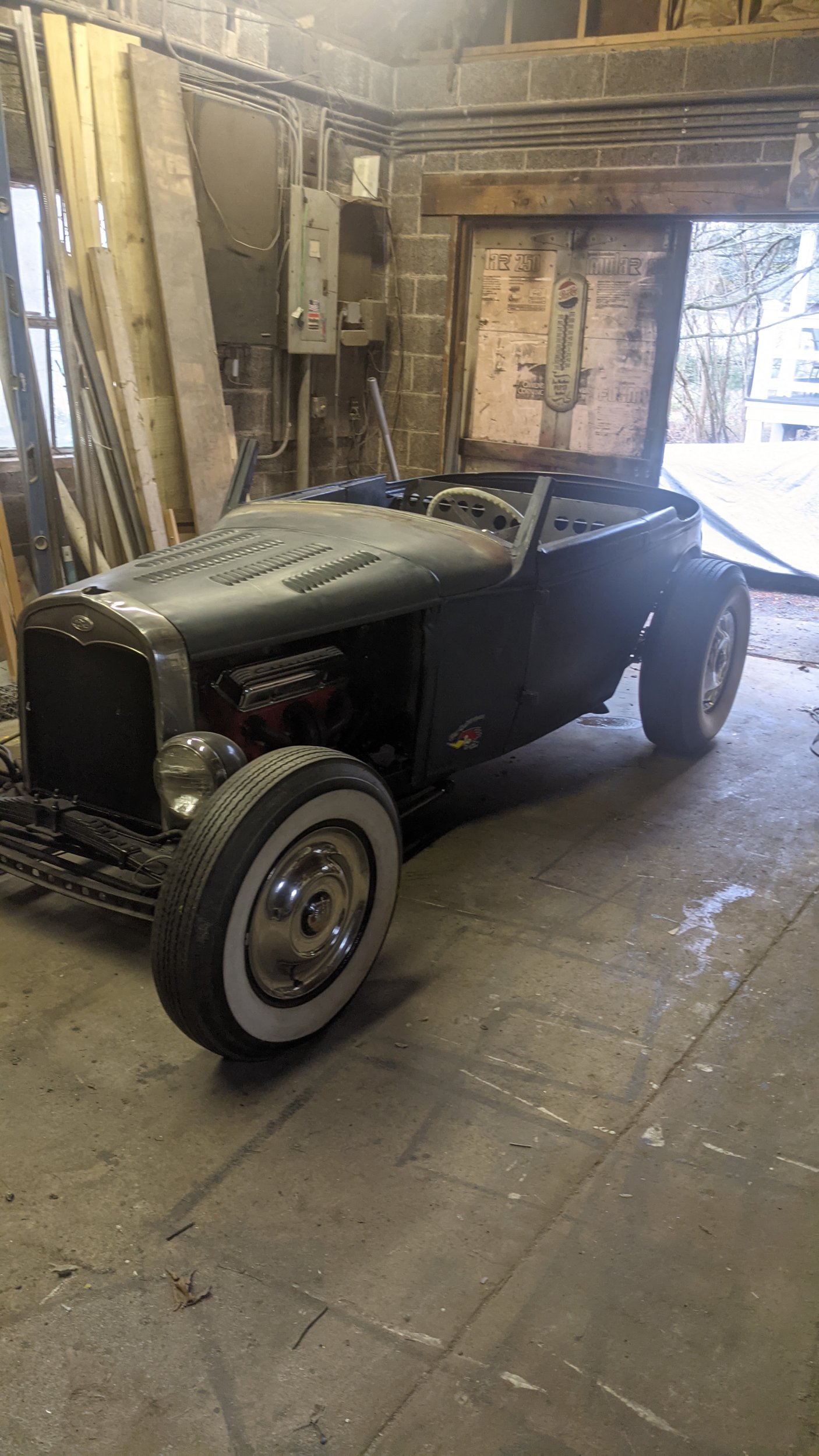

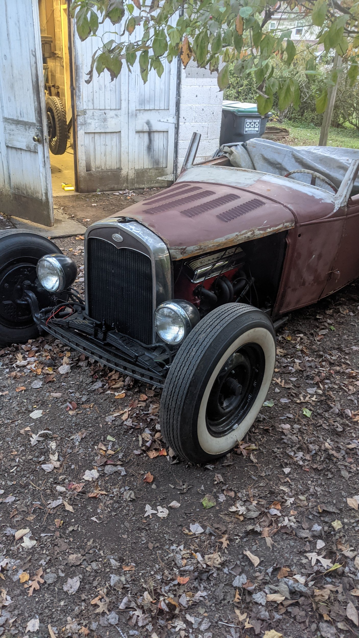

    Did a tad of metalwork before the snow hit here. Rolled some beads and hammer welded them to the lower hood edges. I was going to try to adapt some stock tops but I would have needed to add to them anyway as the hood is aout 3" longer than a stock A hood so I just rolled some the right lenght. I'm not going to run the hood band as I just don't care for the way it looks. I'll need to do a small filler bead to smooth the transition to the cowl. That ones easy.
    Also I need to come up with a cool way to work out the radiator cap to accomodate the Mopar radiator. That's just fun stuff. I added the salvaged bottom of the '31 shell under the frame with some brackets off the frame. This doesn't show well in the pics but made a huge difference in the way the front looks. If I line it up perfectly with the shello above it nicely clears the tierod and panhard bar with no chance of interference. Pure luck, no actual planning involved.
    AutoZone here has started handling Duplicolor ready to spray lacquer. Some nice colors in stock including vintage black and some early looking blue colors. I love the way lacquers look sheen wise. Going to give it a try on the speedster. Not sure if anybody else on here has any experience with thier products. Sure is priced right though. They also started stocking urethane primer and high build by the quart. Perfect!

    Thank you Bob and a Merry Christmas to you as well. I was looking at those pics and must remark, having it set in the driveway, even covered is taking a toll. It is looking a bit rough in those pics and needs to go inside ASAP.

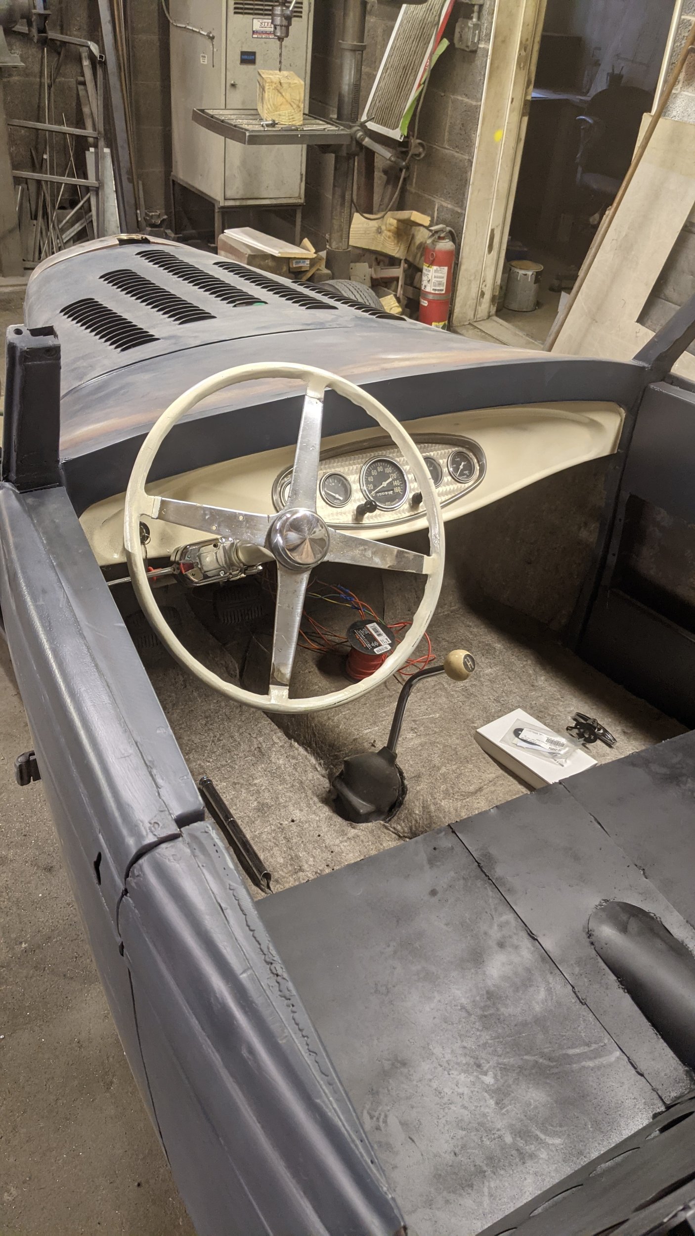

    PXL_20250406_172817160.jpg PXL_20250401_225624319.jpg PXL_20250405_210852451.jpg PXL_20250405_210852451.jpg some pics of how it sets now. Some motor parts on the way but just about ready for inspection and road time. I have removed the windshield posts which didn't suit me and I'm recons***uting the cowl return to the dash and doors to accept a DuVall/ Hallock stainless knockoff. Details as things progress. PXL_20250401_225624319.jpg
