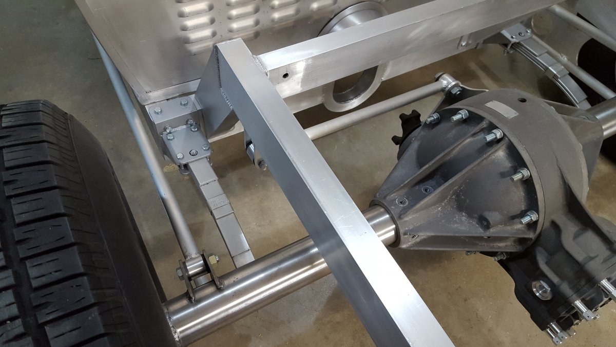

    The frame is 1/4" thick,2"X 5" tapered from the cowl forward to 3". Front and rear crossmembers are 1/4" 2"X 5" with corner braces made from 1/4"X 2" X 2" Aluminum Once the floor is done it will be sort of a Unibody. It's pretty rigid and I plan on driving it...A lot!

    How about a pic or two of the rear suspension?

  6. Aluminum1929
    Joined: May 27, 2016
    Posts: 32
    Aluminum1929
    from Troy,MO

  8. Aluminum1929
    Posts: 32
    Aluminum1929
    from Troy,MO
    Sorry it took so long. I've been moving and finally got the car moved into the new garage. Lost about two months so I am getting back in high gear. Plus these weird, warm February days make me want to go for a drive!
