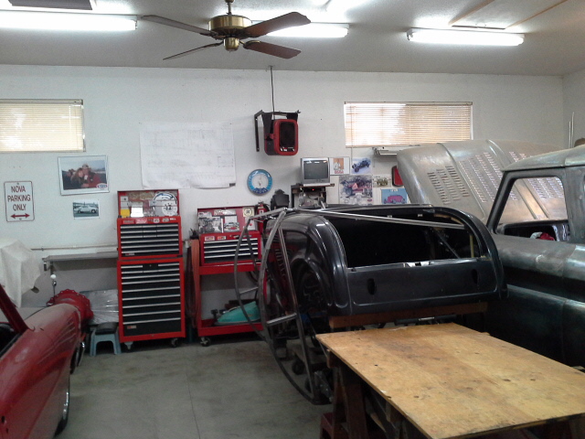

    If you are going to mount fenders, do it before you box your frame so you can put in weld nuts where needed, Doing any custom modifications on fenders or running boards eat up build time as well. cindys roadster.JPG side.jpg
