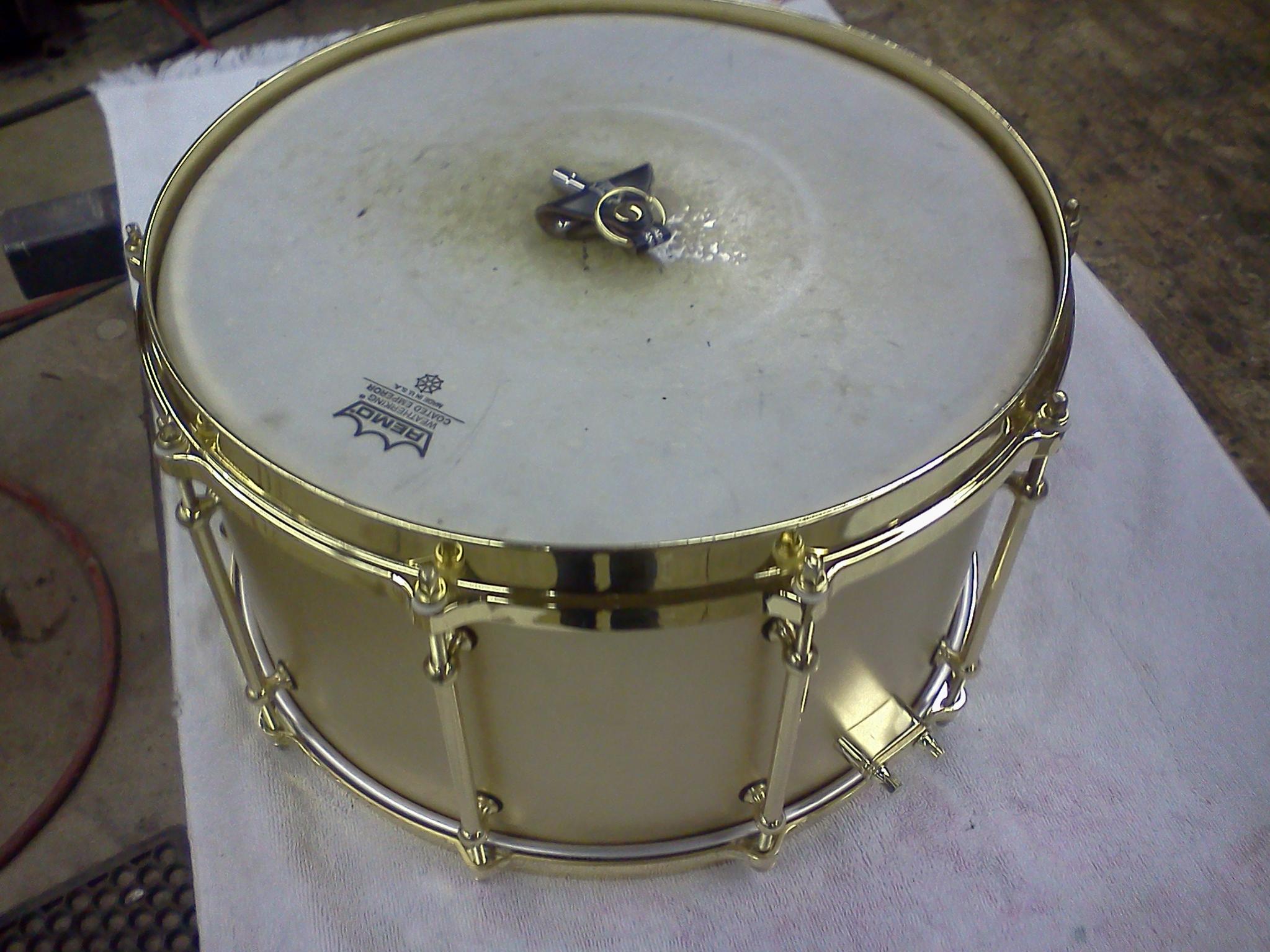

    Mindover, first let me say you do beautiful work,very impressive sir.I will be curious to see how you make out with the T.I.G. welding of brass.
    I just finished this brass drum for a local musician/drum instructor. I do mostly steel and aluminum fabrication and I know exactly the problem you are referring to with the aluminum cracking.
    I used my T.I.G. welder on the joints on this drum and had no cracking issues even after grinding and hammer/dolly. Pleasantly surprised at how well it went,as I don't get a lot of opportunities to work brass.
    Thank you for taking the time to share your skills with us.
