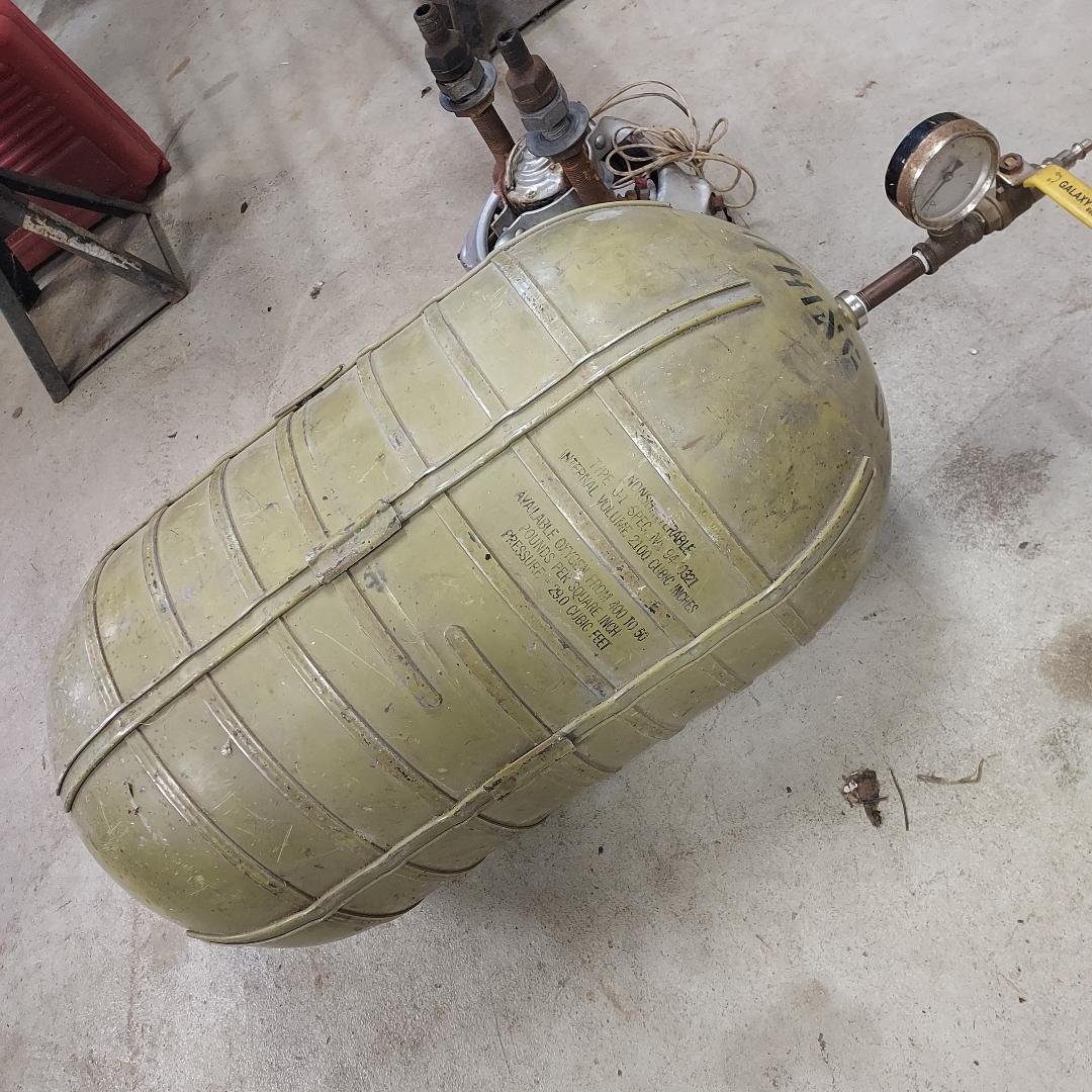

  12. mr.chevrolet
    Joined: Jul 19, 2006
    Posts: 9,334
    mr.chevrolet
  13. patsurf
    Joined: Jan 18, 2018
    Posts: 2,590
    patsurf

    1biggun
    Dad has one that we fill to 140 PSI every time its used as a air tank for at least the last 6o years he has had it or more . I used it for 20 at the races to fill tires . there SS so there not going to rust out and and for home or auto air stuff there likely never filled more than 120 PSI f as that's what most compressors are maxed out or less these days so there are likely never over stressed or near 400 PSI there rated for .
    If its not all beat to **** id run it at 100 PSI and not worry .
    My Grandfather had like 20 of them tanks when I was a kid . He made a dog bowl out of one . he had one rigged as a fuel tank on a wood splitter .
    RodStRace likes this.
