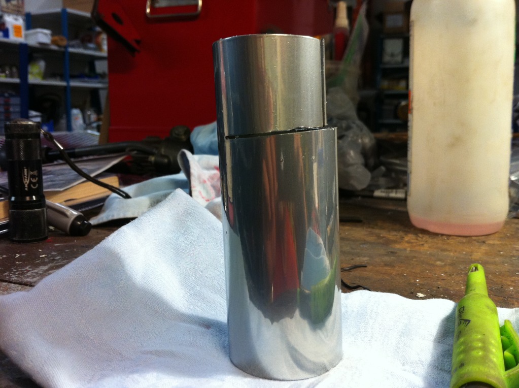

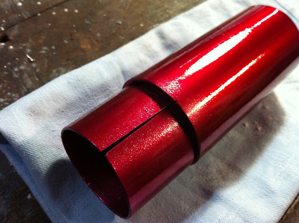

    Tested Eastwood's DIY powder paint kit and for smaller things it seems to do the job just fine.
    First I tried on a piece of s**** metal, just cleaned it off and gave it some solid red powder.
    First lesson learned: You need a lot of light when you spray the powder, otherwise you don't see where there's a thinner coat cause the powder is so matt. Orange peel...
    Second attempt, this time a tube and "Crome". Lookin good, but I should have tried some clear on top of it. Instead I used the "Translucent red" a little bit like candy. Came out nice, but to find the limits I went for a third coat. Clear.
    The last picture shows what happend. The two layer paint isolated the tube so it never went electrostatic enough.
    Too little powder gives this orange peel effect. (When orange peel becomes popular, I'll be the King!)

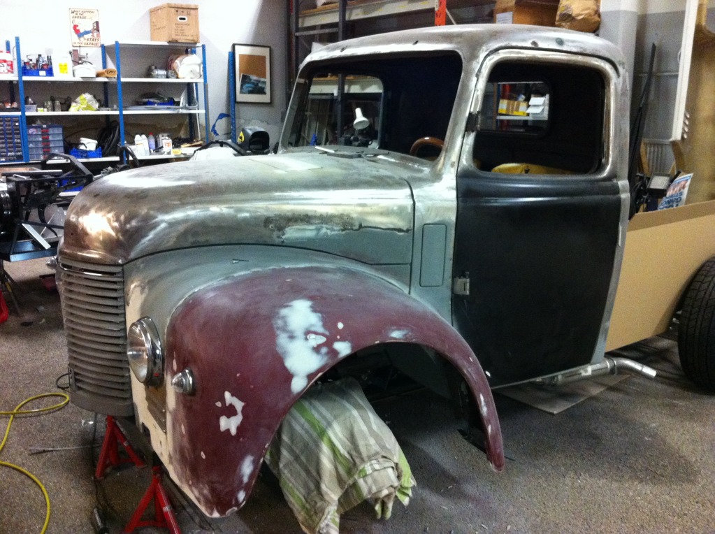

  5. Now the the right fender is also ready for gl*** treatmant, just waiting for my turn signals to show up so I can fit them nice and tight.
    In the meanwhile I played with a designtrick my friend 40StudeDude here on HAMB used on his outstanding Cadillac build...
    Thanks for the inspiration, Roger!
    And don´t sand too long with a heavy electric sander...:eek:

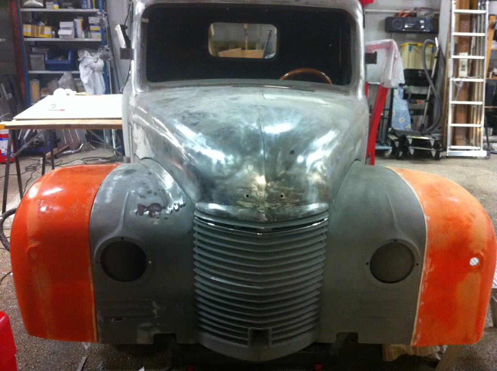

    Got my "Turn Indicators" from UK and testfitted them.
    Looks... :eek: very Brittish indeed, chaps!
    A little bit Marty Feldmanish...

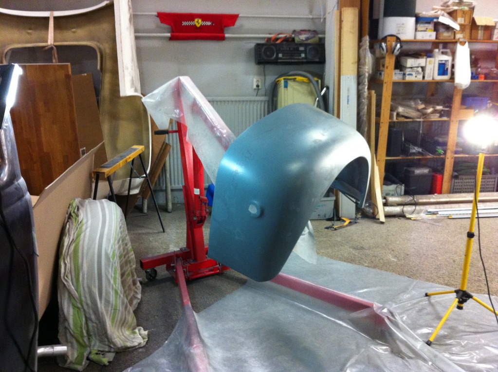

  13. Been working with the fenderplugs to get then as smooth as possible, before the fibregl*** is applied.
    If you want to do everything by yourself, be prepared to do all the mistakes that's included in that process... :confused:
    Don't lay rattle can paint first and "real" car paint on top... :(
    Don't spray too much paint on one spot.
    Don't think you can judge the viscosity of the paint the way Chip Foose do, unless you are a pro...
    ...and so on!
    But tomorrow the work with the molds starts!
    Two halfes with dividers, piece of cake on YouTube... ;)
    Used a door window channel to copy the form on the fender to the cardboard.
    A lot of wax on and wax off...

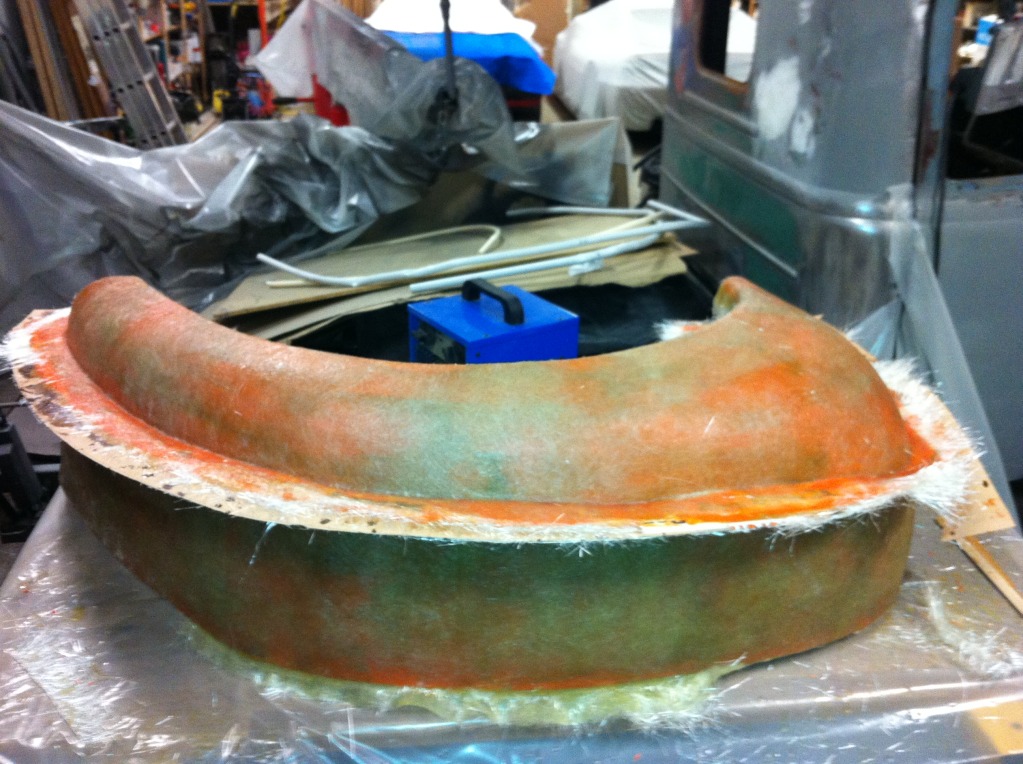

  14. Between all X-mas preparations I managed to take my first stumbeling steps in the world of gl*** fibering(!).
    5 times wax and 2 times release agent and 3 times gl*** fibre matting. 450gr/m2.
    Should be enough for the mold. There will be some reinforcements added too, but I ran out of time...

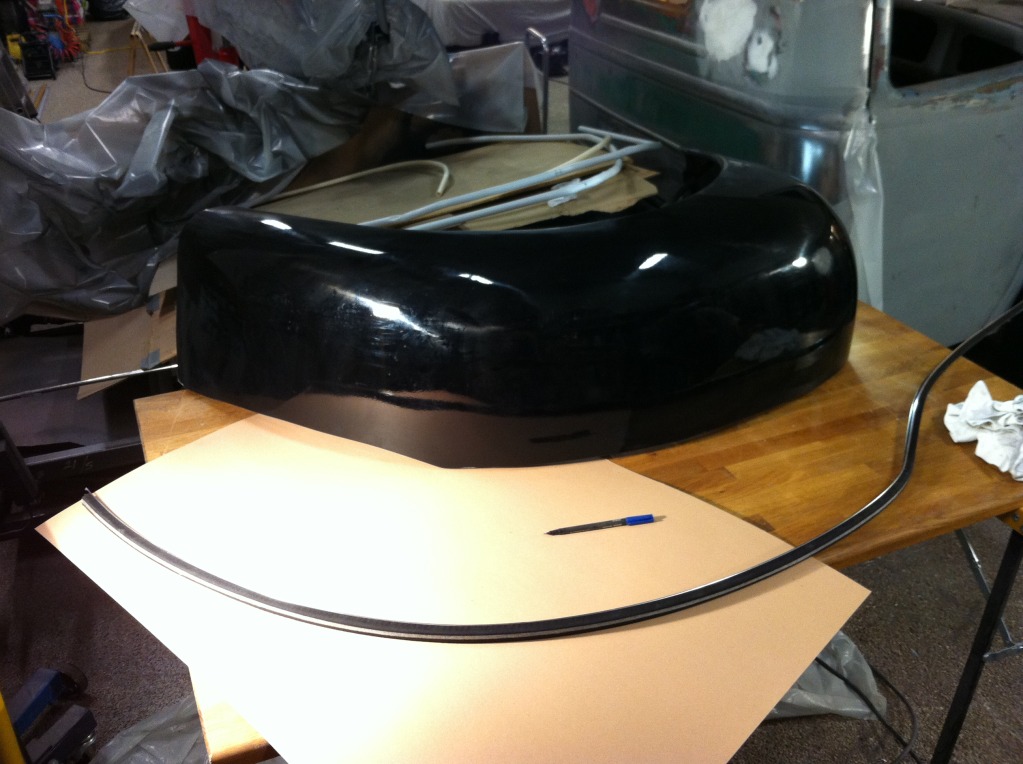

  15. Ta-daa!
    First fender out of the mould!
    Don't get me wrong, steel is real and I'm a true sheet metal guy, fibregl*** is... cheating, in my book. (Sorry all Corvette fans!) But I'm too curious too learn how to do that.

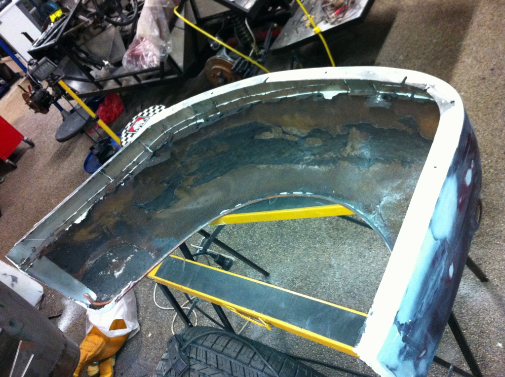

  18. And finally the second fender came unwillingly out of its mold...
    Got some "wrinkels" in the gelcoat though. Didn't see it when I worked with it. Just came out like that. Used Acetone to keep the brush soft between the sessions.
    Anybody know what that could be?
    Anyhow, now its time for some real work! The bed! In steel!!!

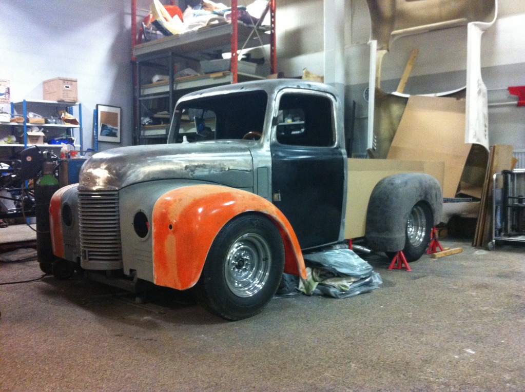

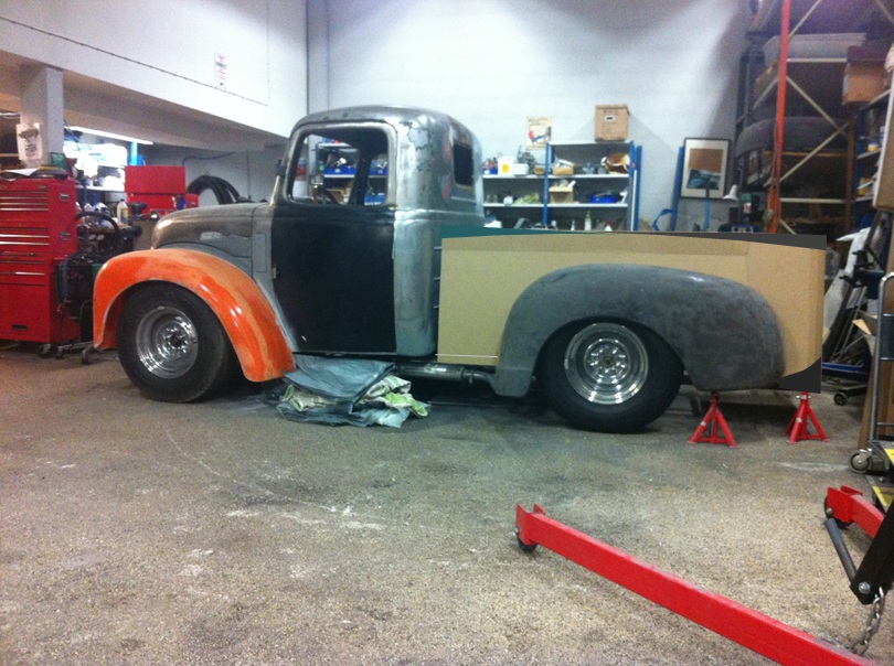

    Iv'e started looking backwards to the bed or "hood".
    I wanna make a bed with a more round shape, to match the rest of the truck. Not like grandma's bathtub but just a little to soften the corners a little bit.
    First attempt with cardboard and Windows Words...

    Nice proportions, really looks like a fun little truck you're putting together there.

    I like the side profile with the cardboard bed.
    The chrome wheels really suit the old truck.

    I,d chop it 3 inches and it will be perfect great job btw..............
  24. Thanks.
    Will be 2" to start with, but I have to check the proportions, see what the eye says...
