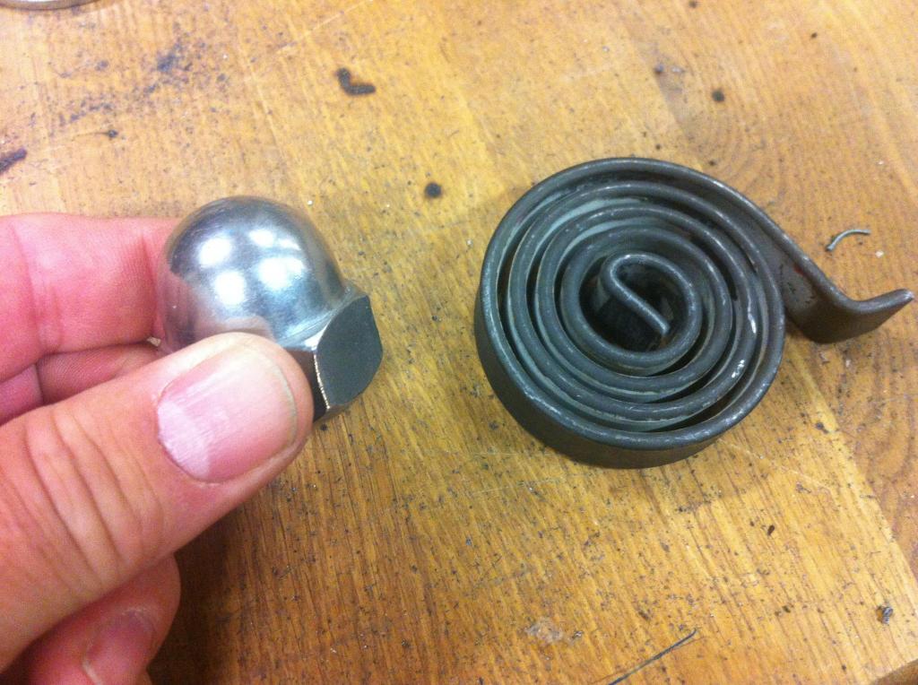

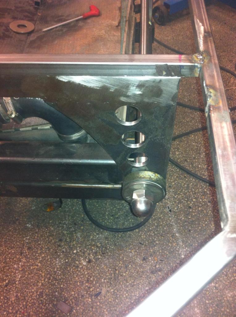

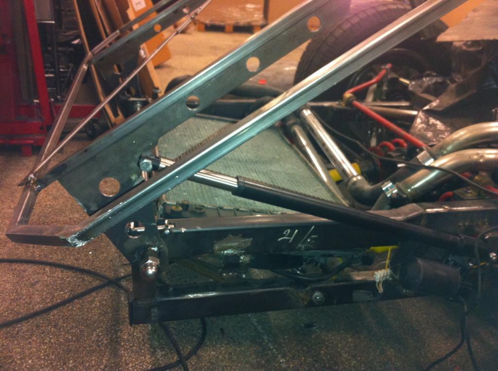

  11. Been working with the bed.
    I can tilt it with the help of an 24 volt actuator (got it cheap), an 12-to-24 volt inverter from China (got it even cheaper), 2 ballbearings, a spring from the backrest of a front seat (he will never miss it):eek:, 3 locking pins, a door solenoid and a hood release hook from an old Saab 900 (borrowed...):rolleyes:.
    Gonna build the sides and the bed bottom from alu sheets (!)
    I can take the whole bed off, by loosening 3 locking pins.
    Ok, with someone to help at the other end, then!:eek:
    Enjoy...

  17. Thanks all, Rog, the bed is my hood (said the blonde...). I need to tilt it to get access to da motor. And show off all those overcomplicated constructions Iv'e been waisted my time with... :eek:
