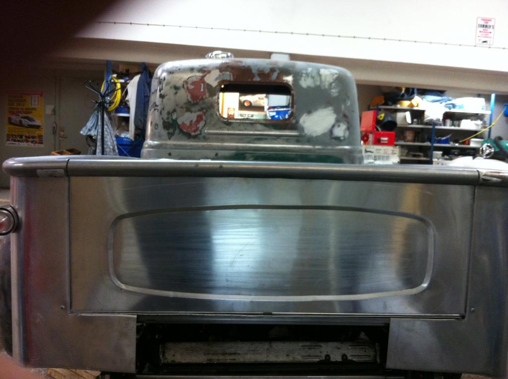

    I'm very curious how you made that depression in the tailgate with hand tools.
    I see no distortion at all. Not that the rest of the build hasn't been impressive..
  2. Thanks, mashed.
    I'll take some pictures tomorrow, I don't know how to explain it in words.
  3. So, I used my homemade english wheel to "pre-stretch" the piece and then rolled it in my hand cranked ... "thing", whatever its called.
    Pretty tricky to crank and guide the piece at the same time...!
    But I guess I have to do it all over again...
    Take a look at the picture where you see both the tailgate and the rear window.
    Thats ugly!!!
    A square and an oval...
    Ill do another one, more a combination of those two.

    Agreed...!!! One or the other needs to match...but I can't foresee the square part in the tailgate...

  5. I have an idea how to combine those two shapes. Let's see how much "fab time" I will get this weekend.

    Speaking just for myself, I think an oval rear window would be cool & match the tailgate.

  8. My first thought too, but thats a little too -20th for me.

  10. Done!
    The oval square is now permanently and for the whole eternity (and beyond) pressed into the tailgate. Bead rolled, actually.
    Learned from an extremely talanted "Sheetmetal wisperer" Stuart Smith down under, <!-- m -->http://www.lonestarbodyshop.com.au/
    to pre-stretch the piece before rolling the "oval square" to avoid oil can effect.
    This is how it came out.

    Now thats cool!

  16. Changed the tailgate... again! :rolleyes:
    When you are not 100% satisfied, why leave it so?
    Since everything else is done 3 times...
    This time I wont change it!!!

    The third tailgate is spot on.
