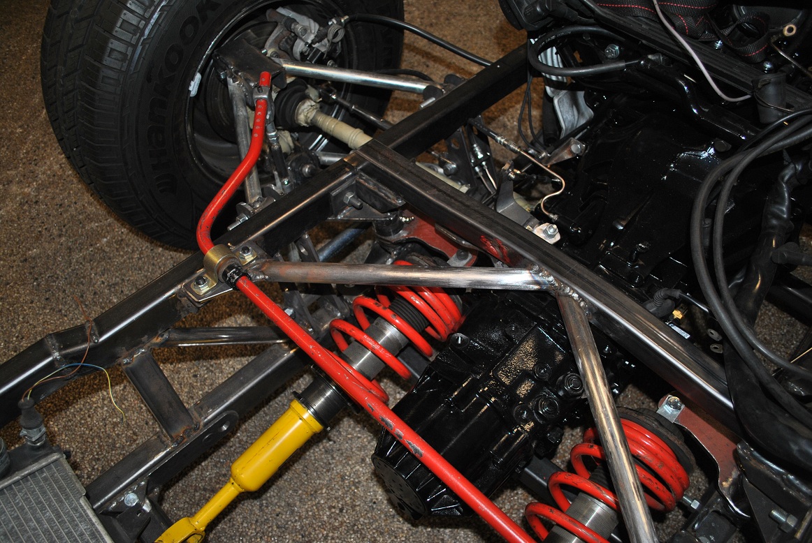

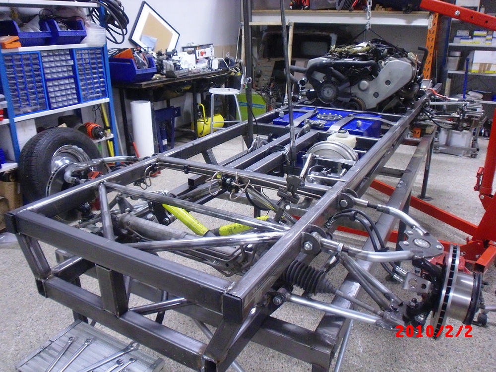

    Since Im gonna use the old engine bay as luggage compartment, I have to relocate the radiator to the rear.
    There will be a special feature for the air to get there in high speeds...
    The truk will also be slightly wider, since I have to build new fenders anyway.

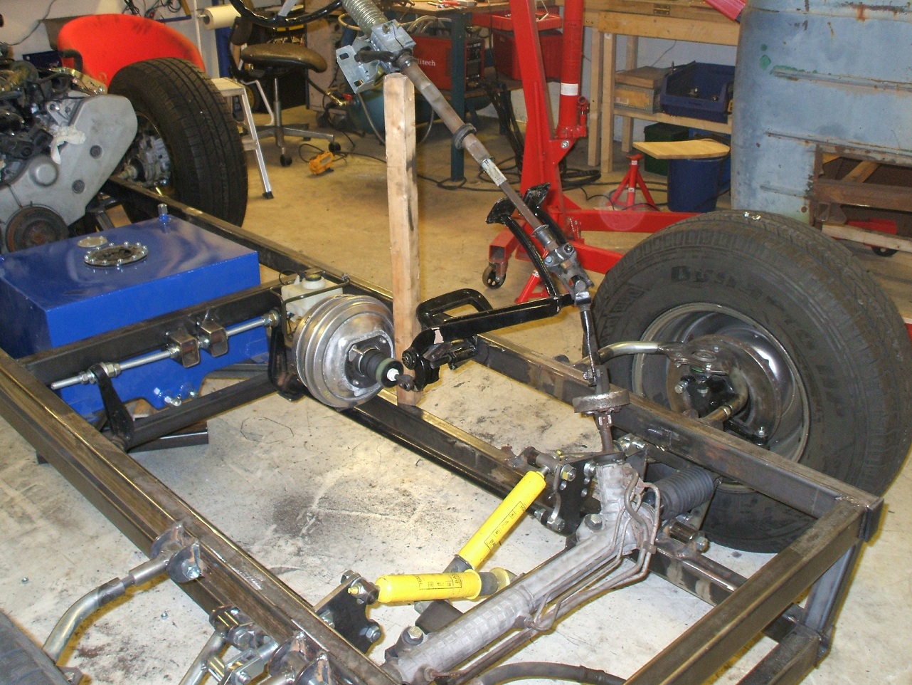

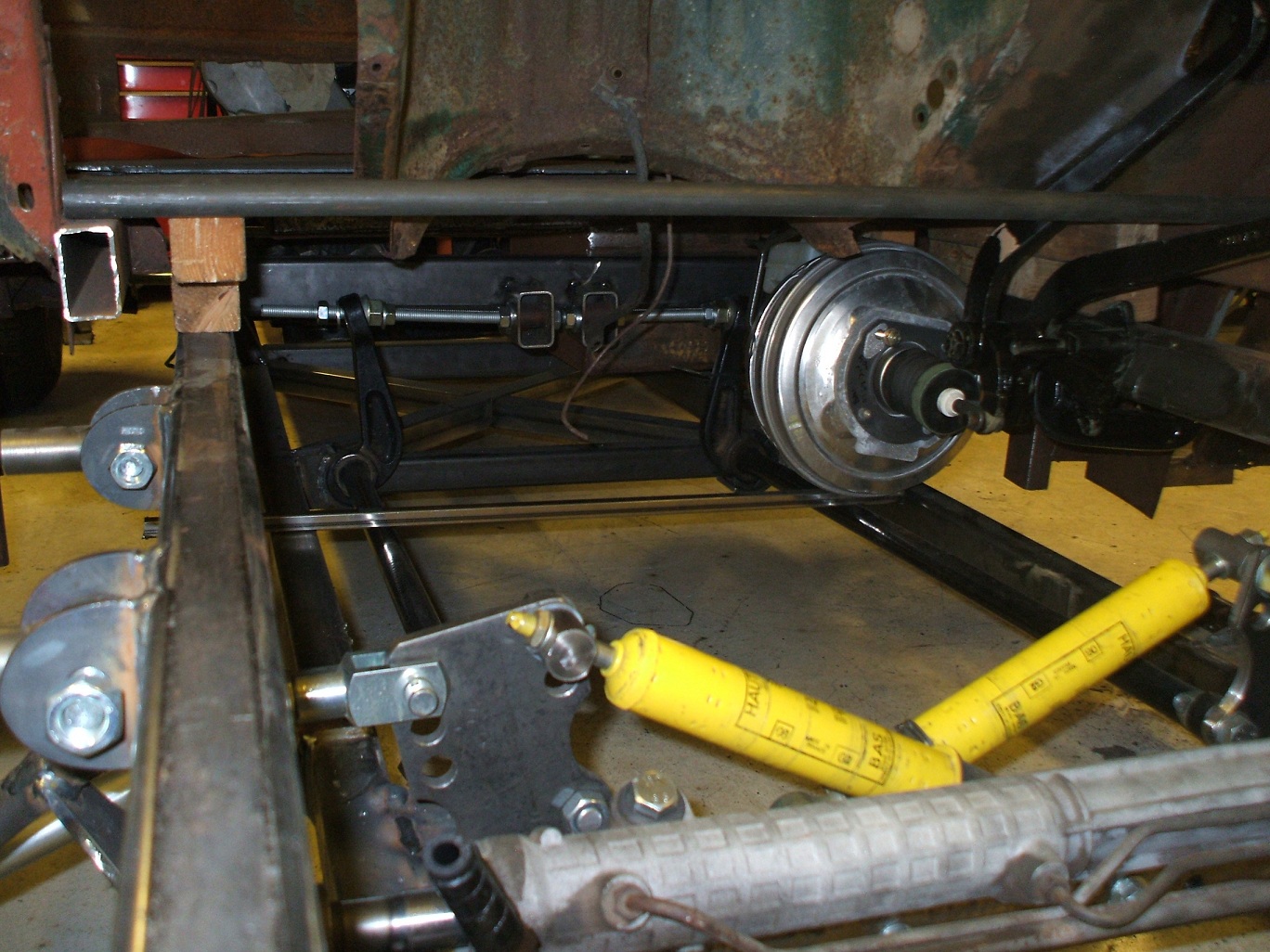

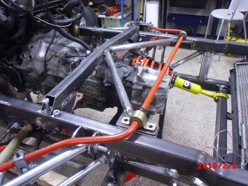

    At the middle and front end, a torsion spring system is made.
    Adjustable ride height and spring stiffness is always good.

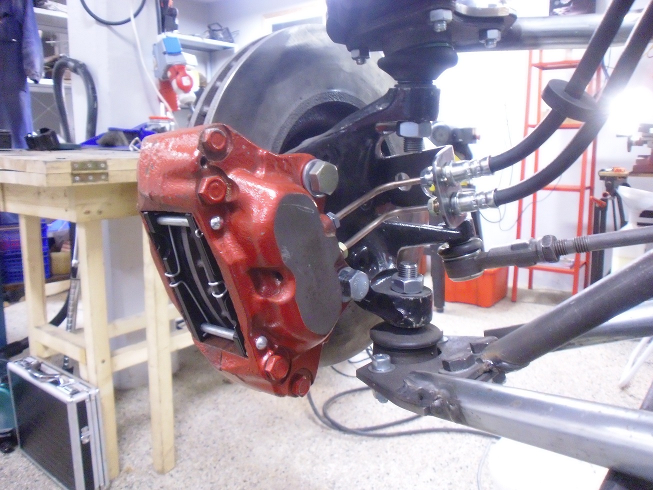

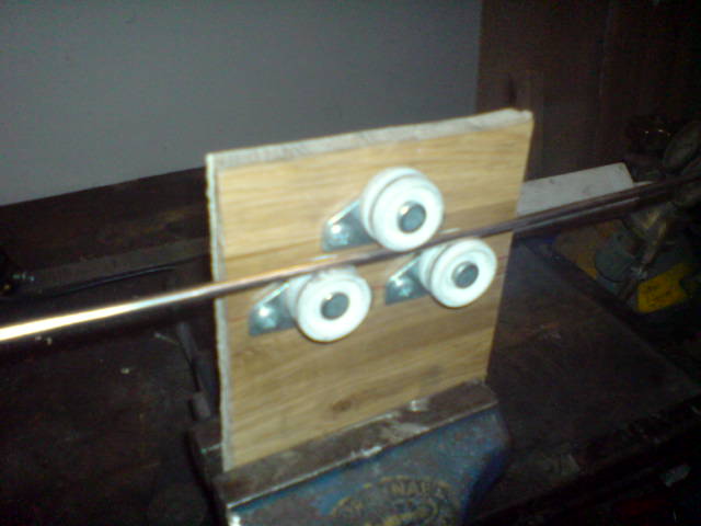

    The brake lines are fun to fabricate and since I choosed the old Volvo system, I got my hands full.
    Two separate circuits where the both front wheels and left rear are one and the two front wheels and the right rear is the second.
    Good safety, but a lot of plumbing!

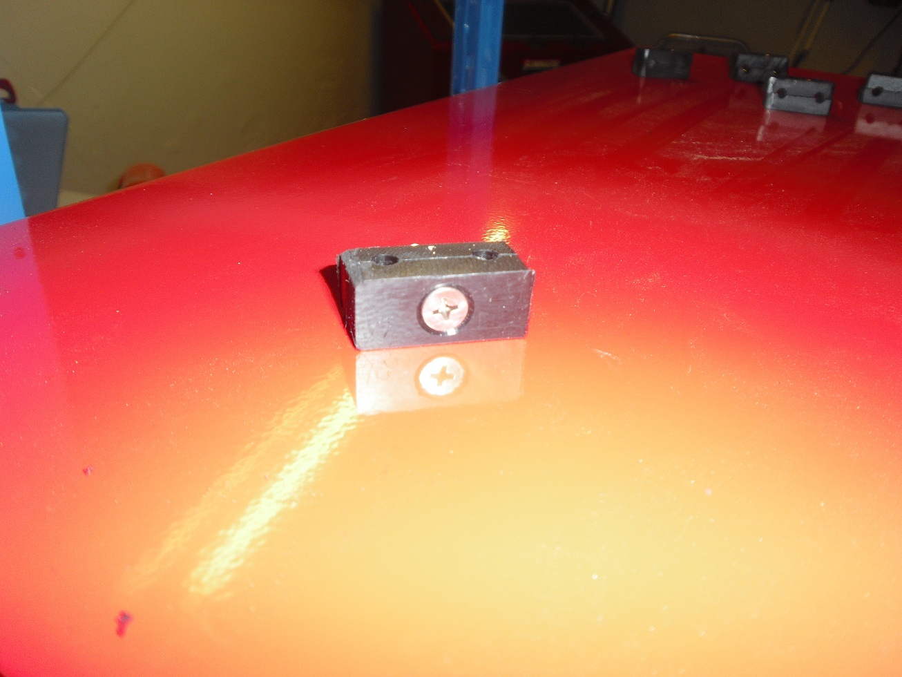

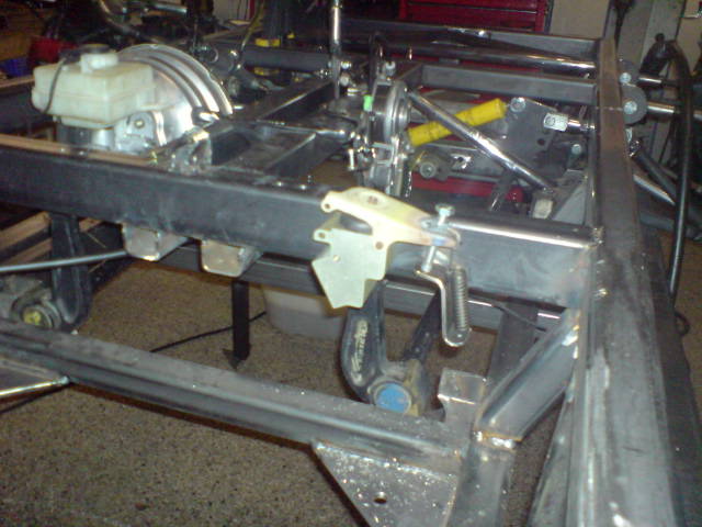

    The last pic´s for this time are more brake related.
    I want the exterior and interior to be as original looking as possible so I made some own solutions with the e-brake...

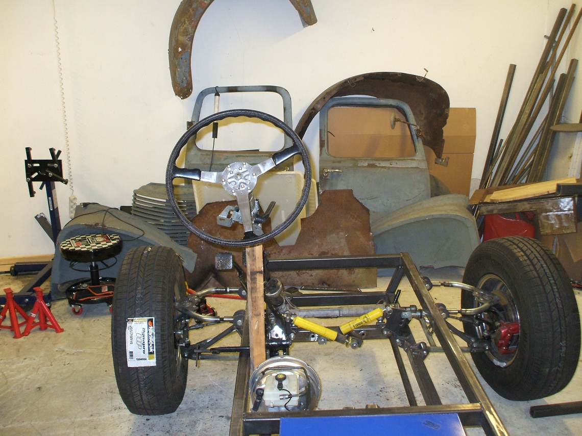

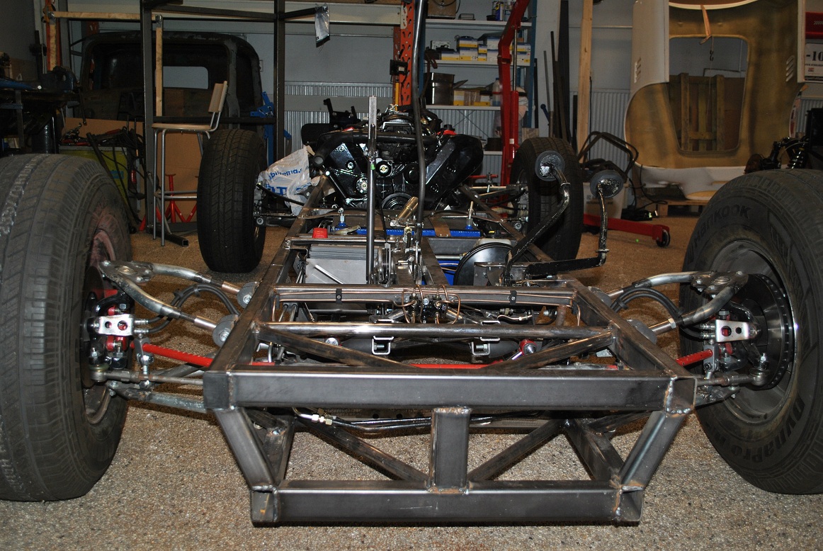

    Now for some pic's from today.
    The ch***is is now ready for the first inspection of three.
    In Sweden you are allowed to build your own car from scratch only under certain conditions:
    • When you have a rolling ch***is you call a guy from a non govermental ***ociation, SFRO. He comes to you and check your build. Welding quality, overall construction, front end geometry, power versus brakes etc. He is a "friend", nomally a car builder himself.
    • Next inspection comes when everything is ready for a test drive. Needless to say, you shouldn't have painted anything yet... A noise reading is also done here and the tip of the day here is, be creative! If your pride and joy p***, it's time for:
    • The last inspection, our normal, yearly vehicle checkup. Have the lights its E-marking, do you have an accident warning triangle, any rust on vital parts(!) etc? Done by the "enemy", payed by the goverment. They also check your paperwork. And loves to find something wrong. Exceptions exists though.
    So, here I am today, next post will either be about the cab :D or me redoing the whole ch***is :(. All depends how the inspection goes...

    Fantastic build! I guess you're some sort of fabricator by trade, aren't you?
    Just a little note; Looking at your suspension and the low ch***is, have you checked your scub-line...?
    You seem to have it all in check, but that thing just looks so low and the A-arms are already pointing upwards a bit...
    Good luck with the inspections.

    Just wanted to ask, don't you think that you would need anti-dive angles for upper arms?
