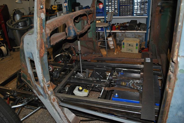

  4. Commer
    Joined: Aug 12, 2010
    Posts: 77
    Commer
    Thanx.
    No, I'm not fabricator, just crazy and curious. Self learned, mostly by doing mistakes!
    My garage only have the basic tools and machines, wich means everything is done and fabricated at least 3 times...
    Yes, you're right. With those wheels the scrub radius is 82mm, but with a wheel with better ET it will come down to more acceptable 40mm or better.
    The ch***is are a little bit too low in the picture, the wheels are going to hit the the fenders inside.
    The idea is to have one set of wheels for the looks (those on the pic´s, 235/75-15 and 265/70-15) and another set for "inspired" driving. 235/55-16 and 265/50-16 or something like that.
    Toni

  15. Commer
    Posts: 77
    Commer
    Good news!
    The ch***is past the first inspection with only 3 minor remarks. (One was a fogotten washer...!)
    Extremely strong ch***is design, the inspector said.
    Yeah, with supersonic speeds I'm gonna need it!!! (...when I probably will loose control over it!)
    Toni

  18. Commer
    Posts: 77
    Commer
    Ha ha, well it was the height of the steering rack that caused a minor bumpsteer.
    With a laser pointer attached to the front wheel, pointing at a white board on a distance of 1.8 metre in front of the car, the deviation was 5 mm sideways, from the wheels highest and lowest position.
    By raising the rack one 1mm washer, the three joints comes in perfect alignment = no bump steer.
    The stupid thing was that I had the washers there in the beginning of the construction, but after several on and off's they kind of disappered :confused:.
    I always seems to get parts left when i ***emble something the second time... sounds familiar???
    Now I only have to find the washer... and a milk crate!!! :D
    Toni

  22. Commer
    Posts: 77
    Commer
    Short update.
    The gas pedal is a mix of an old VW design and a side wheel from an old floor sander. Since the pedal and the wire moved in opposite directions I fabricated an over engineered ... thing... at the other side of the frame. Made of an old gear that I cut in two and then in halves. Hole drilling is a must for that fast moving controls... right?
    Now the job with the cab and all sheet metal starts. Will come back to that later... much later, cause as you can see from the pic's there is a lot to do.

  24. WOW, this guy is a thinker... Awesome job Toni.
    Make sure to cover up those open gears in your throttle linkage. The thought of something getting thrown up and stuck in there at supersonic speed...YIKES!
  25. Commer
    Posts: 77
    Commer
    Mike, I learned from the best!!! There will come more stuff!
    Exwestracer, thanks for the reminder, I will have a bellypan, but since the gears are so close to the wheel openings I guess I have to protect the cogs somehow.
