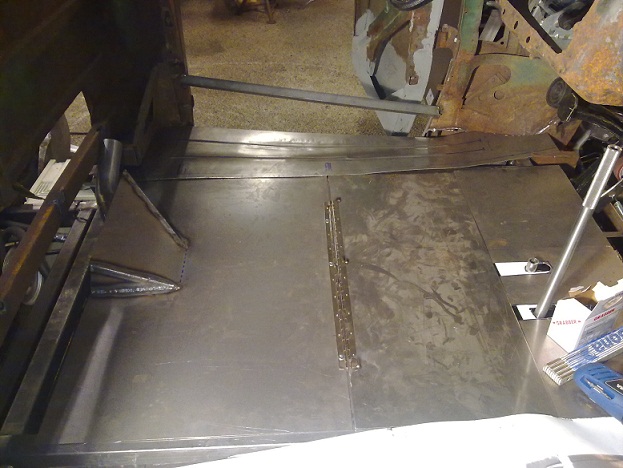

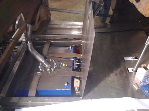

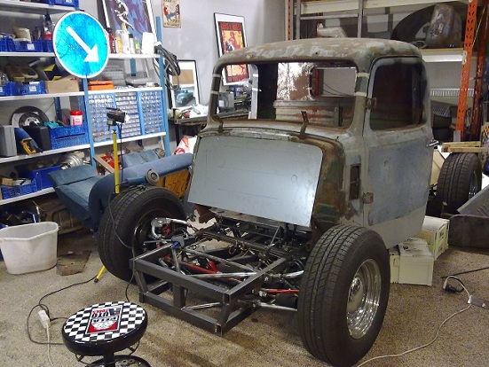

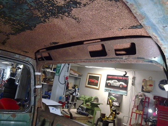

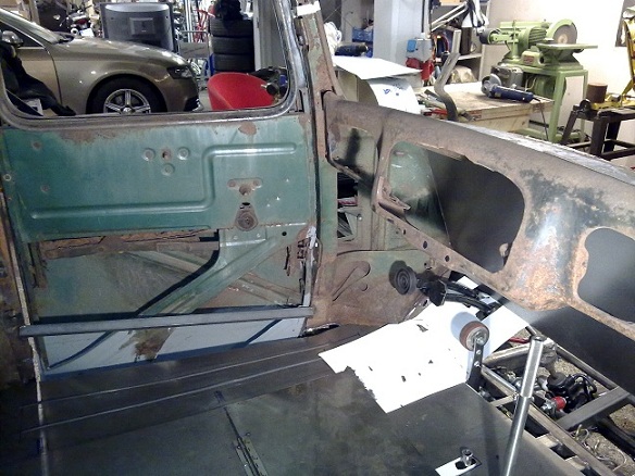

  5. Some small updates.

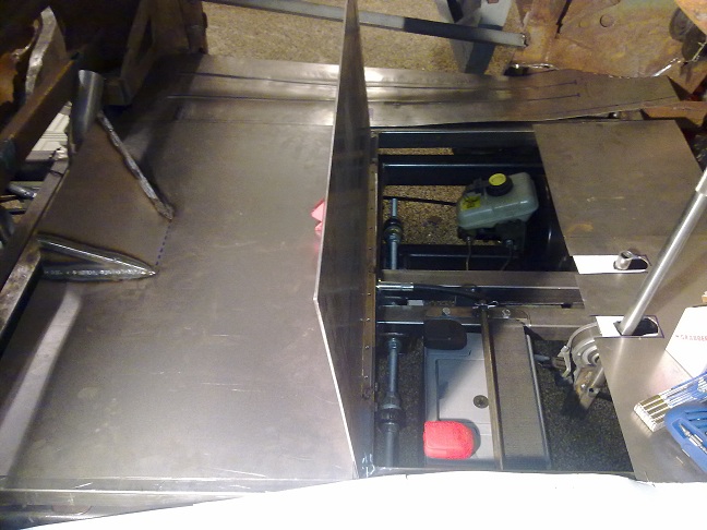

    The projects for the moment are fixing rust and put in a floor.
    I choose to make it as two hatches, to be able to reach the battery, brake fluid reservoar and gas tank.
    The fire wall will get a smoother apperence.
    And fixing rust...
  6. The fire wall will get some grooves for better stability and sound dampening.

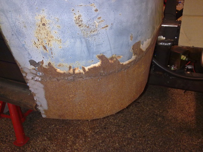

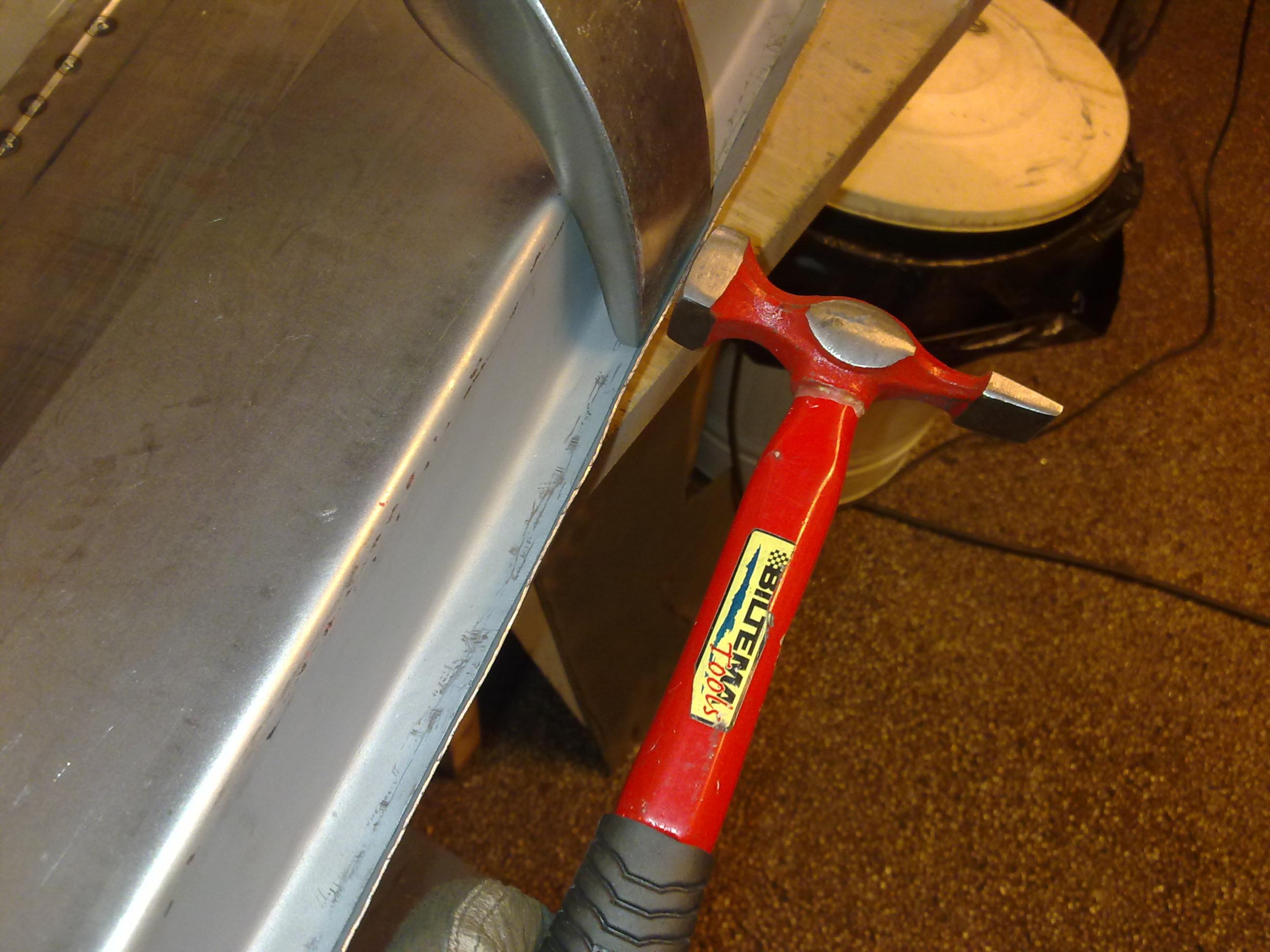

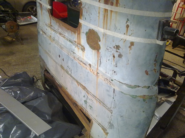

    I have to admit it, I've been cheating!!!

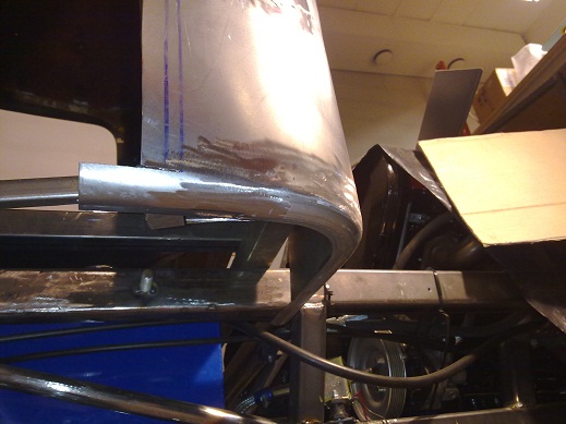

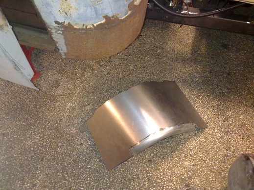

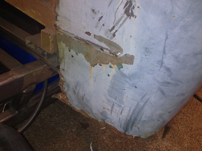

    I run out of sheet metal trying to learn how to form a lower cabcorner!
    So this is how I did it:
    Cut a piece of exhaust pipe into four, lengthwise.
    Bend that last piece of sheet metal over your knee.
    Weld it together.
    Cut away the last owners attempt....
    And weld the whole piece edge to edge to the cab.
    Cheating... yes but what the...

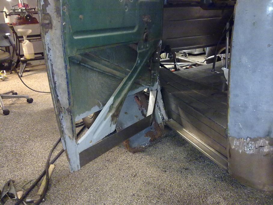

    Closer inspection shows that the lower part of the door was worse then I expected. It didn't even fit in the opening...
    So, before I swing the axe, the doors have to be rebuilt.
    And yes, I'm gonna try to weld right in the middle of the doorskin! :eek: The metal is very thin too. Probably around 0,8 mm.

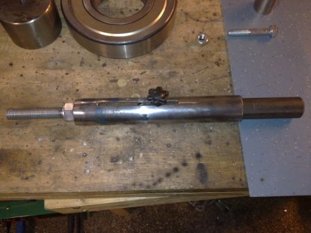

    Just realized that the lower parts of the door skins must be "double curved" witch requires an English Wheel or something...:mad:.
    But that Internet came to my rescue in form of this site:

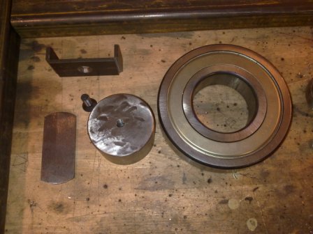

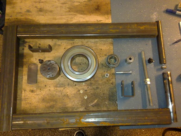

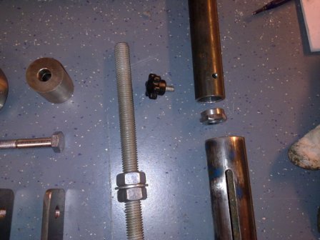

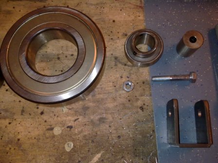

    http://www.roddingroundtable.com/tech/articles/12ewheel.html
    I just followed Frank Kocinski II and Frank Kocinski III's instructions and now I have this tool too.
    Thanks Frank and Frank!

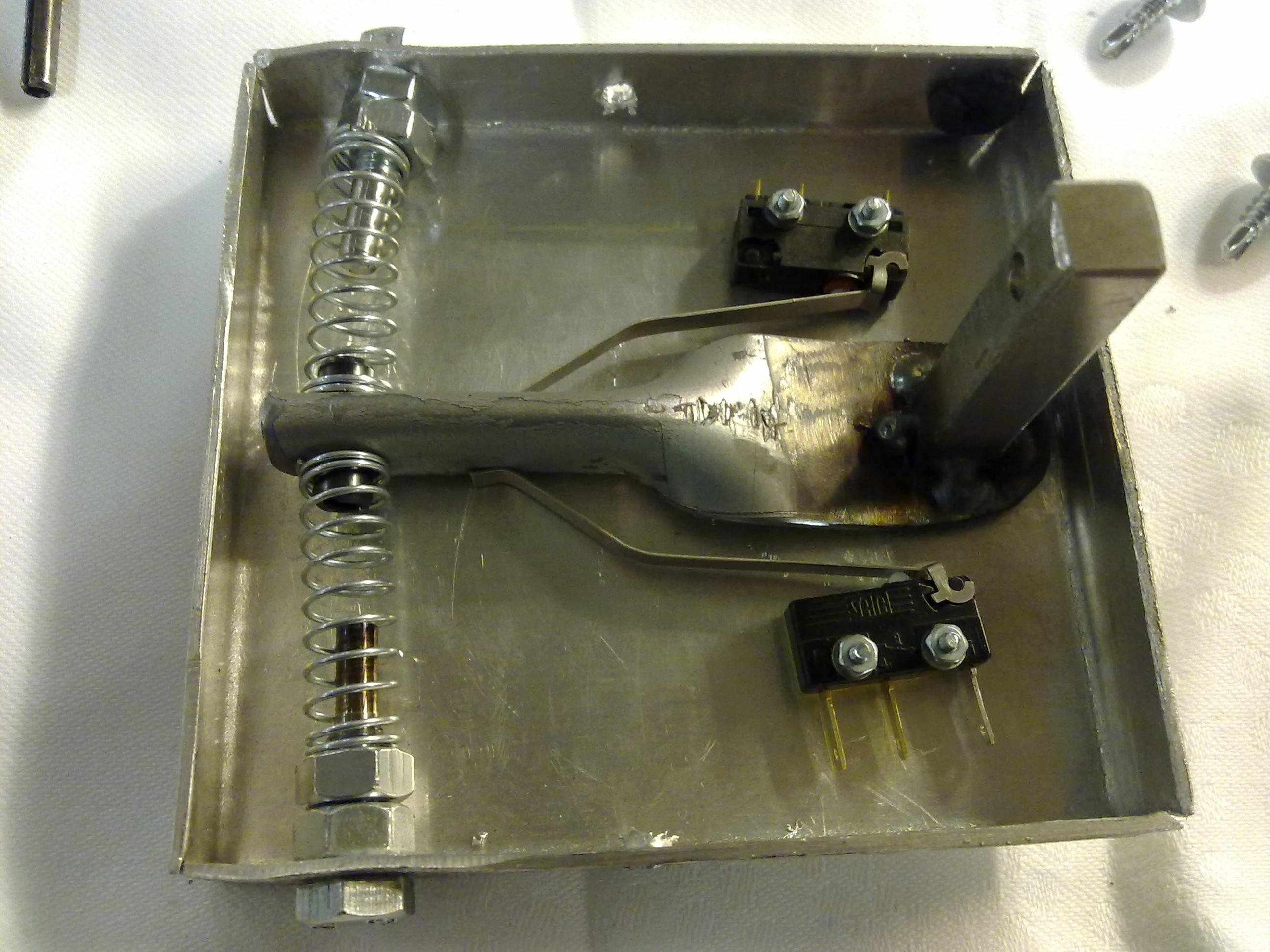

    Been on the road for the company a lot lately, but here's some things I been experimenting with...
    The thin doors created a slight problem when it came to put in power windows. After some hours at the junk yard I fond some from a SAAB 9000 rear doors who fitted fairly well.
    The switch is camoflaged behind a Volvo PV crank.
    Also changed the locking mechanism (Renault Clio) and took away the outer door handle.
    Am waiting for some used solenoids from a Security safe money bag (!) to manouver the locks.
    Also welded and folded some sheet metal on various places on the doorskin.
