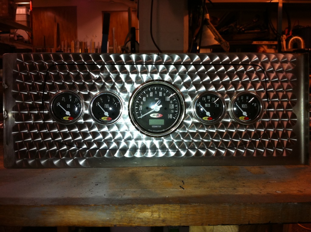

    Today I managed to remove the dashboard and sandblasted the rusty inside, well at least I tried...:mad:
    The little tab at the bottom of the dash is where the chain for the radiator curtain ran. You could hook up the chain in the little groove and by that regulate the amount of cold air that hit the radiator. A must on all cars in Sweden at that time... Aka "knee crusher"!
    Since the look of the truck shall be as original as possible, with exception for some small details, I deceided to fill the two glove compartments and the gauge "hole" with home made (of course!) rose polished(?) stainless pieces.
    Made the polish tool from a steel bar, double sided tape and Bona Scrad, a Scotsch Brite type of pad, normally used for hardwood floor sanding.
    Made a punch "tool", cause I thought I needed a lots of them...
    but I used only one and it's still not worn out.
    Will be continued...

  15. This is how the low cost, ol' style, racing inspired piece of s**** metal, turned out.
    Only worry is how to get km/h scale inside the speedo. The crome ring is crimpt on the case...
    Oops, turned the gauges upside down, compared with the dash opening sketch... :eek:
  16. Is that a drill press you used to make the polished dash insert with? Very clever. I guess a valve could also be used as a base to hold the scott pad and that should fit directly in the press.
    Klaus
  17. Yepp, a drill press, a coordinate table(?) and an old steel rod. A valve is of course the optimal solution, but I couldn't find any lying around.
    Little tricky when I had to move the piece on the table, cause the table movement was not big enough.
    I have seen small café tables with the same pattern on the top, about 60-80cm in diameter... :cool:
    But they would probably miss them quite quickly! :eek:

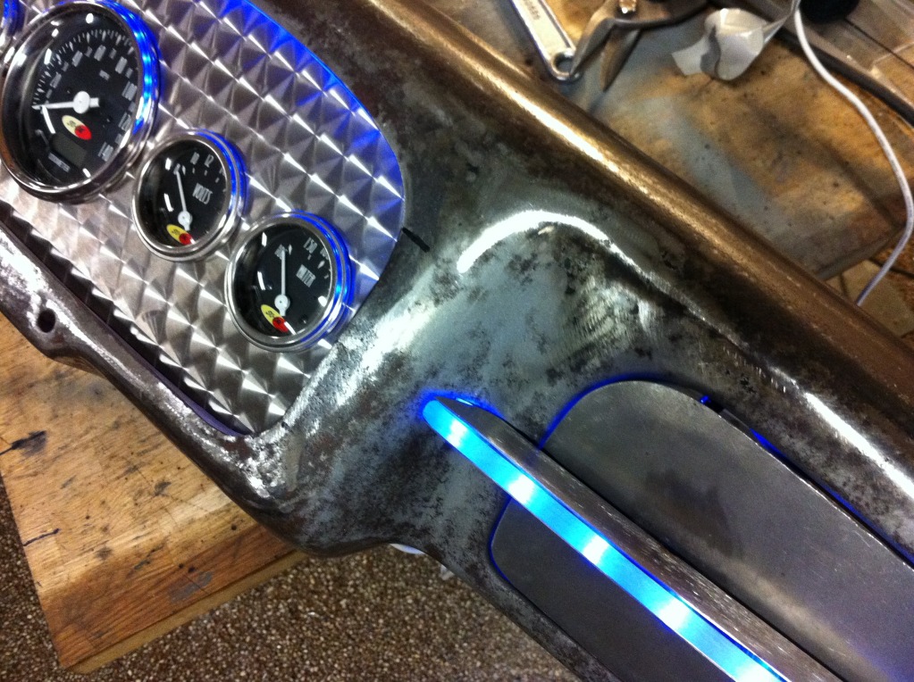

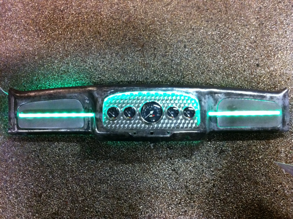

    Did a test with some LED strips (from Radio & TV accessory shop, cheaper there!) and some Lexan leftovers from a shelf divider.
    Brushed the Lexan matt and placed the LED's behind.
    Made two glove box handles out of some stainless scap pieces, wich I also brushed, inserted the LED strip and put more Lexan on top.
    The light is not so intense as the pic's shows.
    Was planning to polish the glove box hatch too. But it would probably be "too much". Will paint them instead, same colour as the dash.
    Or maybe weld them flush...
    16 colours, dimmer and remote control, the ladies are on their way!!! :D

    Pretty cool & interesting build "from the get go", it will be a unique ride and yet have a traditional appeal once finished! Beautiful job of engine tuning on your dash panel, I don't think turning the other two would be "over the top" if you really wanted to do that. Your lighting is cool but [only my personal taste here], I think the center panel which will be viewed indirectly is somewhat more effective than the side bars which are seen directly, and would have plenty of visual impact on it's own.

    I like the blue LED's. Red is a little much.
