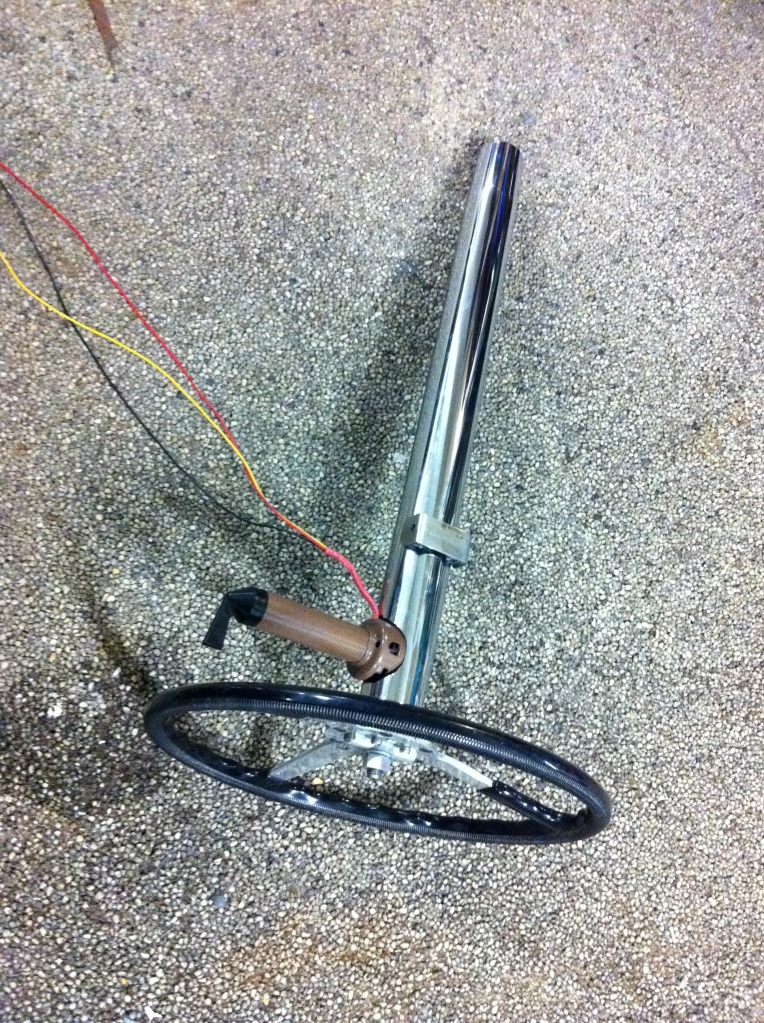

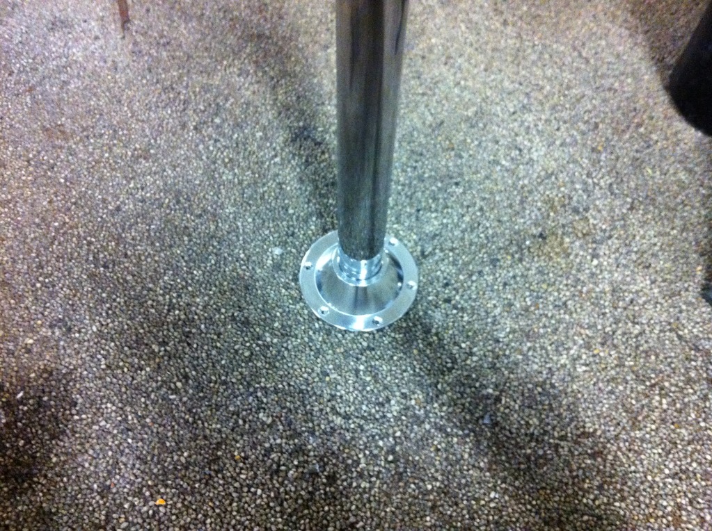

  1. Made a steering shaft column out of a table leg...
    Ididit... my way!
    A hose clamp holds the Ford steering tube in place inside the leg and also works as an attach point for the dash.
    The turn signal "thing" is an aftermarket NOS twist ****on device, wich even have a tab you put on the steering wheel so the "thing" get self retracting!
    Some more detailing is still left, like the horn ****on and the wiring.
    By the way, the steering wheel comes from a Fiat 1100 from 1958.

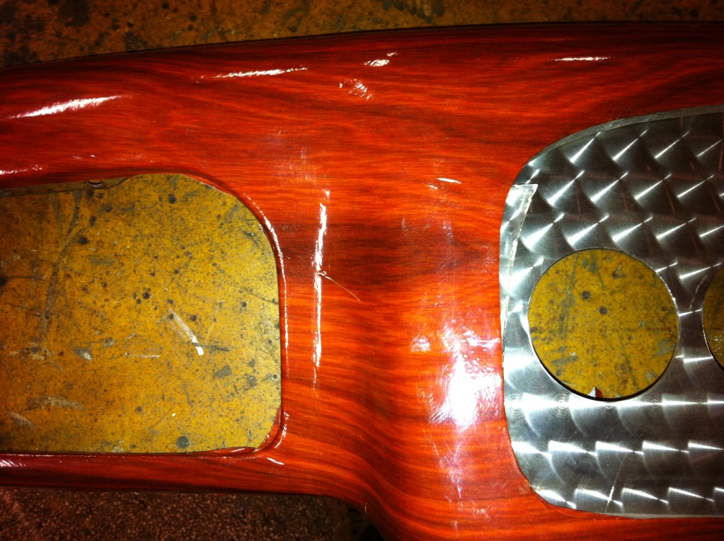

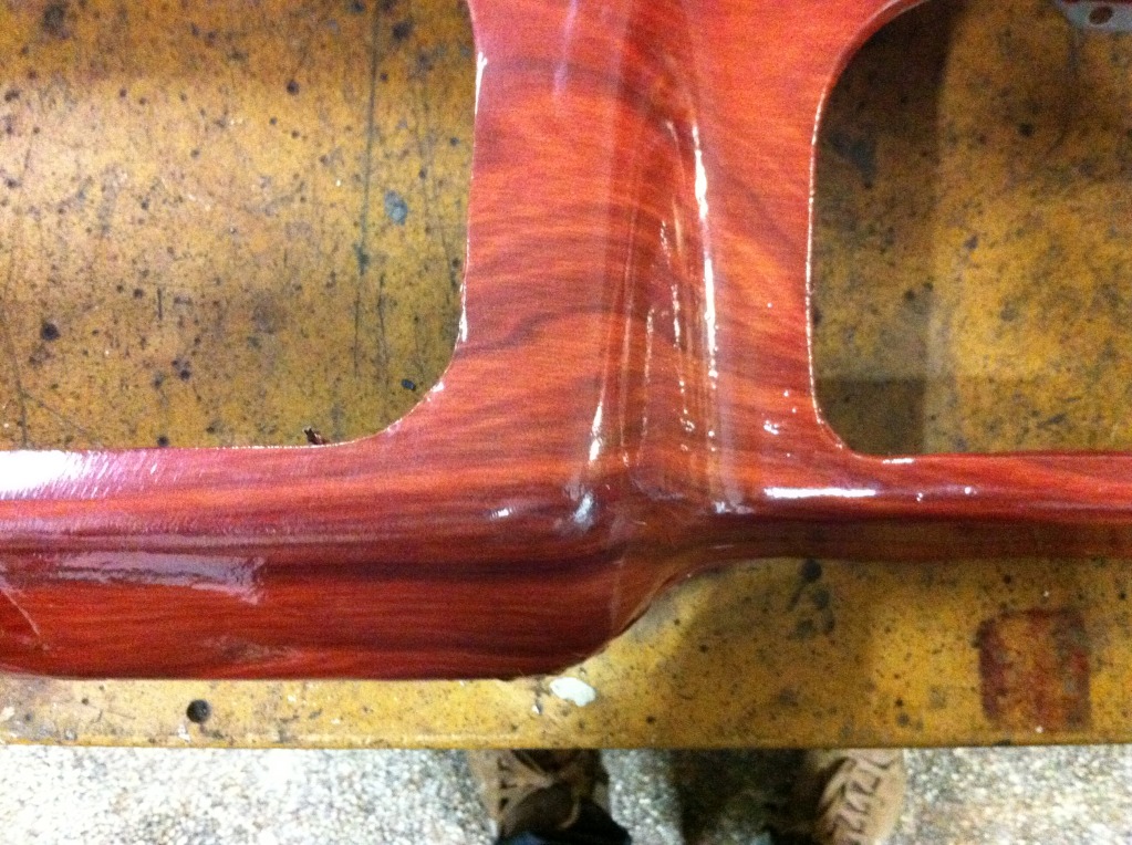

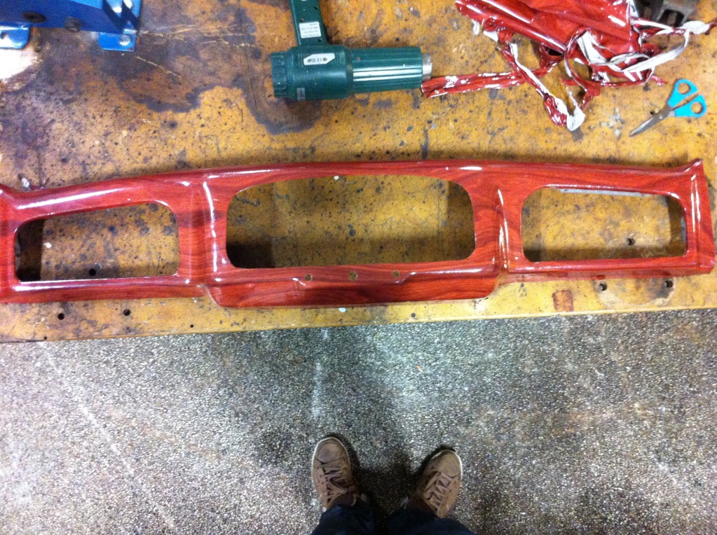

  5. Since my shop floor is digged out for some drain work, not very much have happened the last weeks, but I wanted to find out how hard it is to do wood graining on the dash...
    It´s damn hard!
    It came out looking more than a pile of dry sea weed, than mahogany...
    So, what to do?
    The same as before... cheat!
    I wrapped the dash in some cool foil that you can form with a hair dryer. Wasn't easy either, will redo it, but works for me.

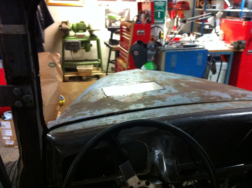

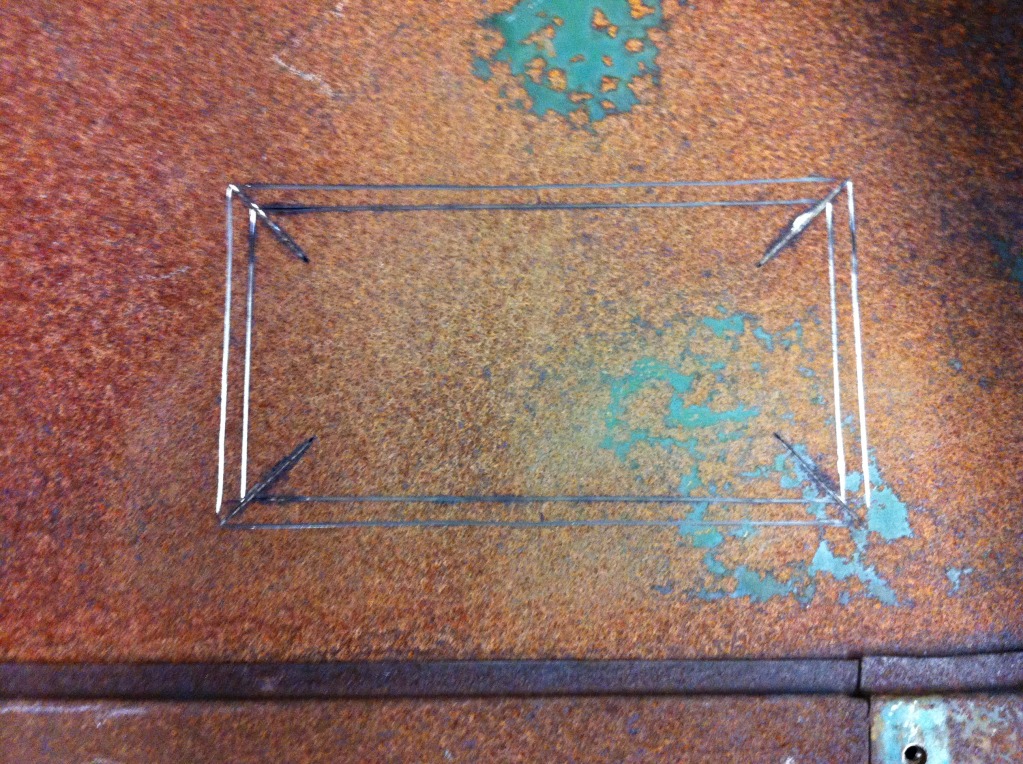

  12. So far, so good...
  13. Thanks Claymore.
    The whole idea behind this part project is to have an unvisible tach that becomes visible when necessary...:D
    On the hood.

    This is how it ended up...
    The rack is connected to a choke wire. Pull it and the gear spins the tach round into sleeper mode...:cool:

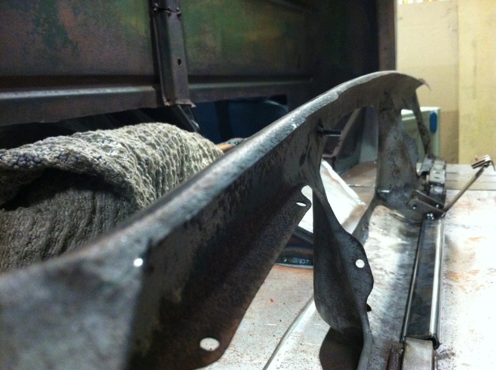

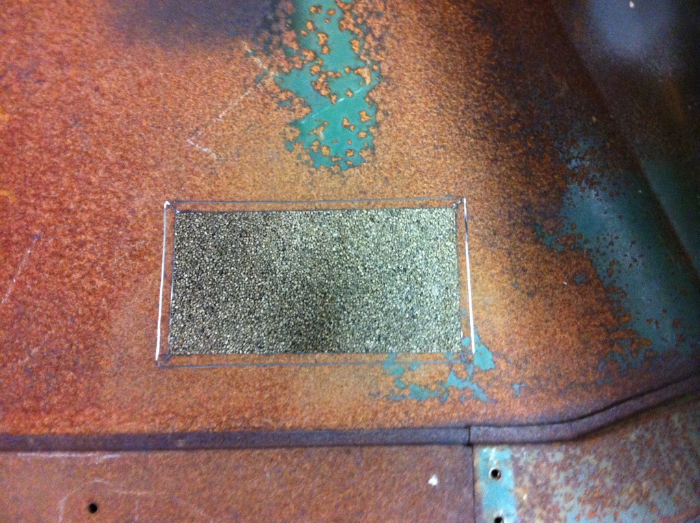

  19. Floor is ready with the two inspection hatches in the middle, dash rebuild from 8 fastening bolts to 2, a 2,5" exhaust pipe converted to.. an umbrella compartment!
    And the weeks rust picture!!!
