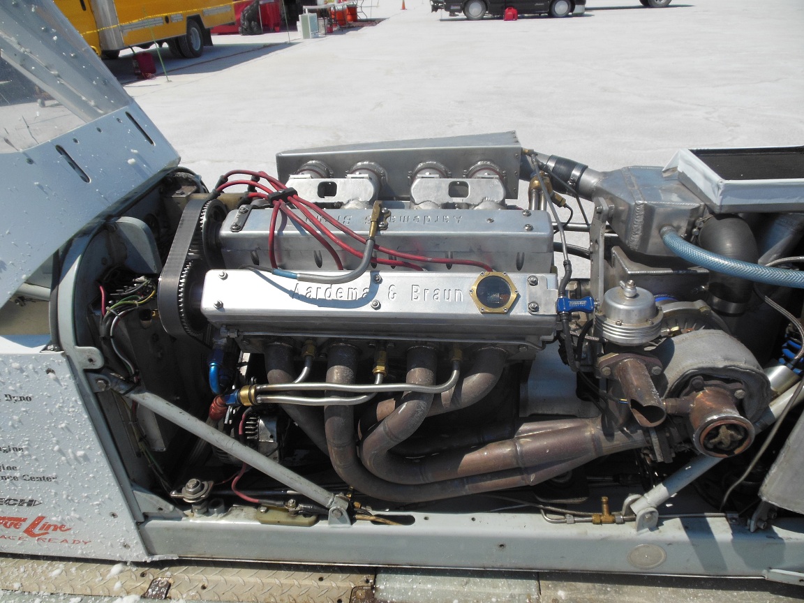

    It's a Model A block with a billet Aardema/Braun DOHC, three valve head, made in three layers to accomodate water jackets. Turbo at 10 PSI and race gas.
    I'll try to get Kevin to post up some pictures of the engine during fabrication...yes, fabrication, all done at Pete's home shop in So Cal.

    No, this engine was built entirely by Pete and Kevin in Pete's very well equipped home shop. It's worth a thread of it's own!

    Here's a shot of the engine
