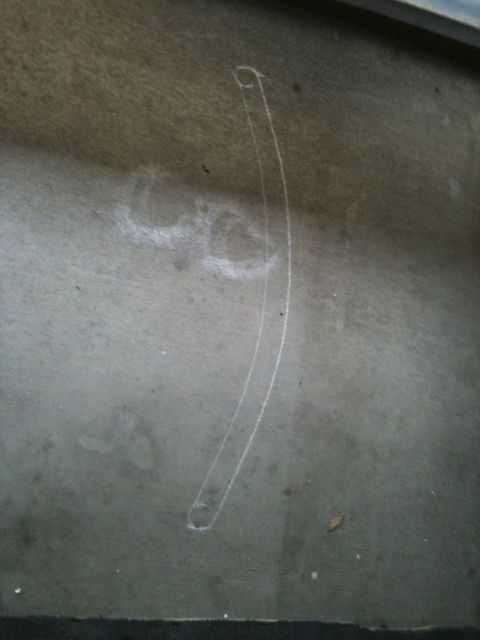

    I wanted to stay pretty true to the Era, but I'm no expert so I went ahead and lowered the front end. I reversed the eye on the front main leaf with the help of my friend Chopper and his press.
    We traced the original spring arch on the floor of his porch for reference. Then we marked a line every inch on the leaf and put it in the press. After it matched the original arc, it was ready to install, less a couple of other leafs left out.

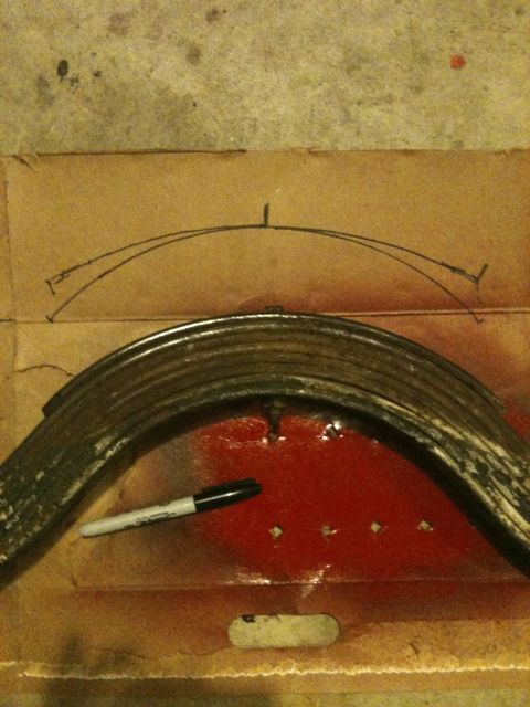

    Now for the rear spring. I got a T spring, lot a couple of leafs and stretched it to the perches. I probably got about 2" down.
    I was concerned about the smaller area of contact with the crossmember so I traced the arcs and cut rock maple shims to make up the difference in the arc and disperse the weight across the area of the crossmember as originally designed. installing T spring in rear.jpg

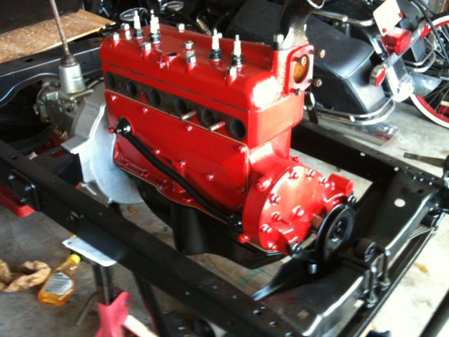

    getting the chassis and engine cleaned up.jpg getting the chassis and engine cleaned up.jpg
    Here's the engine, ******, and frame cleaned up and painted.

  28. Is this an issue? Im running a model A spring with some leaves removed and never thought about the contact area. do you think it may crack the crossmember?

    Ha ha. Apparently a common thread here.
    Thank you. I'm making the necessary repairs to the metal, installing new wood, and eventually, the leatherette top. No current plans for a chop or channel.
    I guess I figured it out. I might be dumb, but I am not stupid.
    I was only concerned with the T spring because it has a tighter arc, and therefore a smaller contact area with the crossmember. Nothing to do with the removed springs. I'm always a little cautious however.
