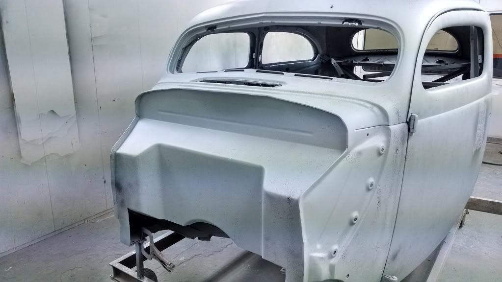

    Well here's the finished product, Got her in primer ready for the blocking. Now need to find a drivers front fender to have everything together. Oh and BTW, if you go up a couple posts and look for meatcleaver, he's the guy that did the chop and metal work.

    The correct chop!

    Here ya go Ed. I'll tell you though, and Im sure you know, Its cheaper and easier to have it done right than to fix it after some else has tried!

  18. trailer-Ed
    Joined: May 15, 2002
    Posts: 2,004
    trailer-Ed
    from JC, MO
    Thanks, I'm a sheet metal worker by trade. I'm not scared, just needed a reference. Those pics help very much! Thanks.
