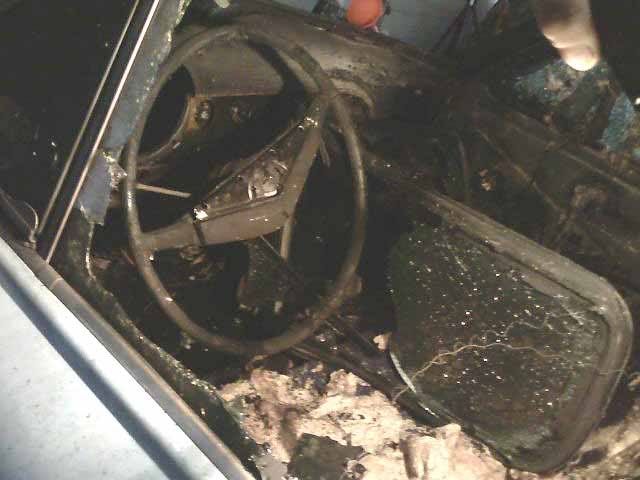

  1. so... i was going to post some pics of my new glass i just had installed last week... looked very good! i was happy and ready to start getting interior decisions going... well... here it is...

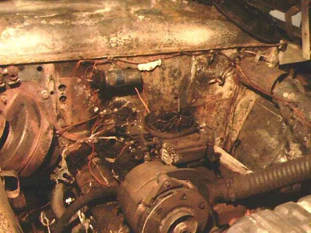

    ha... man is she beautiful... then i installed a new holley carb. brand new... took it down the street for a test drive and it ran a heck of a lot better than my old worn out carter i had on there... whole new car! well, was going to take it to my brothers to mess with it a little bit and as i got off the highway, it died... my guess is the float stuck open and when i tried to start it, it back fired out the carb and boom, fire... when i popped the hood to try and put it out it was already too late... that fast... thing was engulfed in fire and i just had to stand on the side and watch her burn... fire department finally showed and here is what had happened...
    and the new glass...
    luckily it didnt buckle anything nor hurt the engine... but shes down for the count... and it hurts... i couldnt even stand watching her burn... ive had it since i was almost 16 and built it myself... :(
    sucks, just plain sucks...

    Sorry to hear this, but on the bright side, it looks like none of the sheetmetal is totally ruined.

    That hurts for sure. That little '51 looks a lot like my first car. Fire damage sometimes looks a lot worse than it is, get her cleaned up and see where you are. Good luck.

  21. Buy one, and replace it every couple of years, they go bad sitting around. Cheap insurance. Make sure it's an ABC type for all sorts of fires. In fact, if someone has a decent level of expertise a tech thread about fire extingusihers would be a good idea.
    One question: Were you running some type of air cleaner on there?

  23. i did have an air cleaner on top, had a K&N filter in it... dunno if that oil on the filter is flammable or not... but im sure it helped feed the fire...
