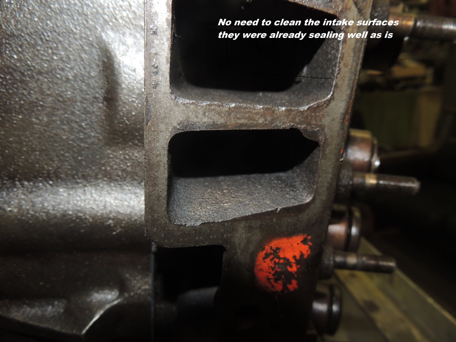

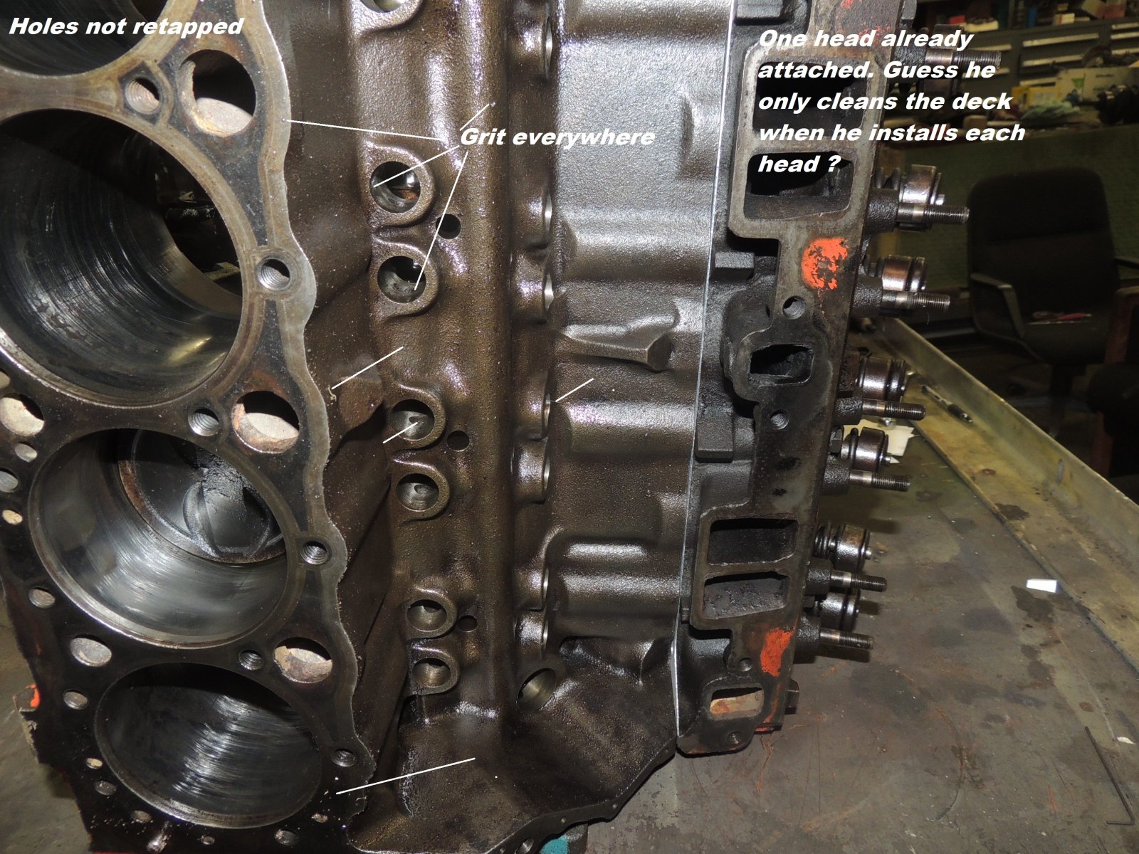

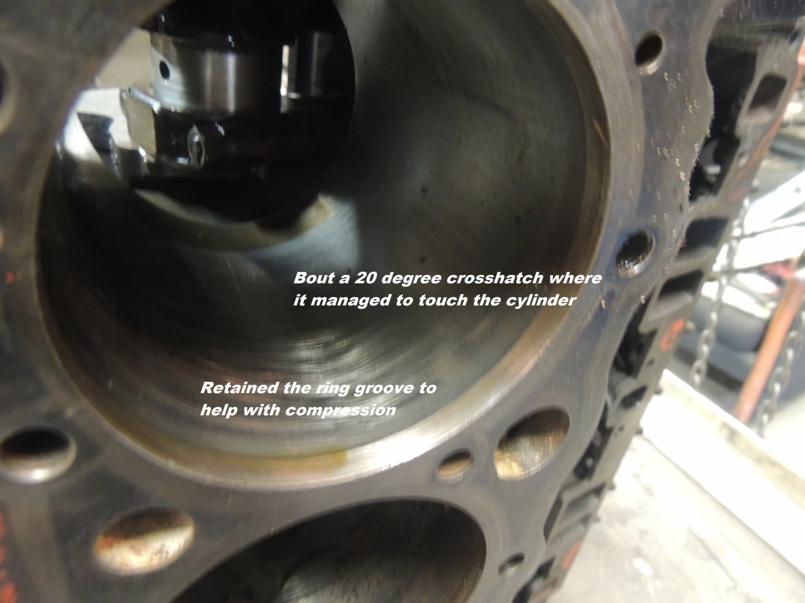

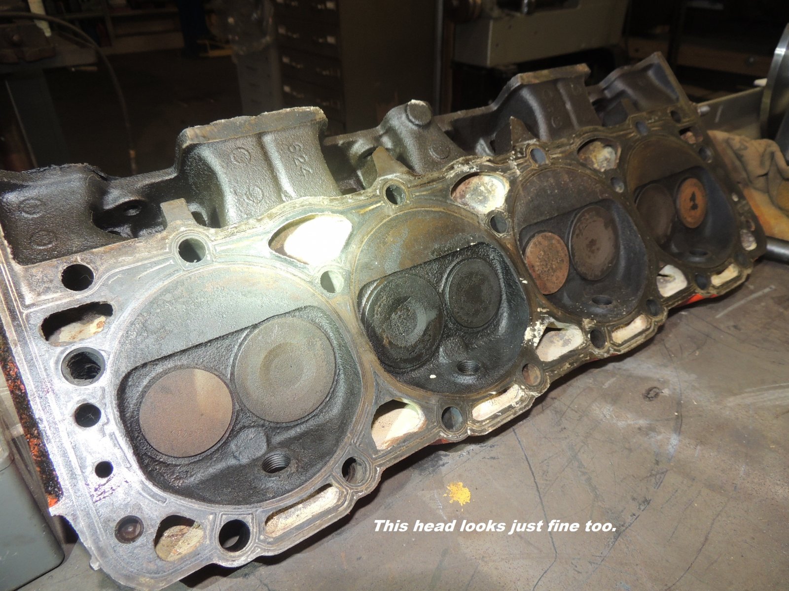

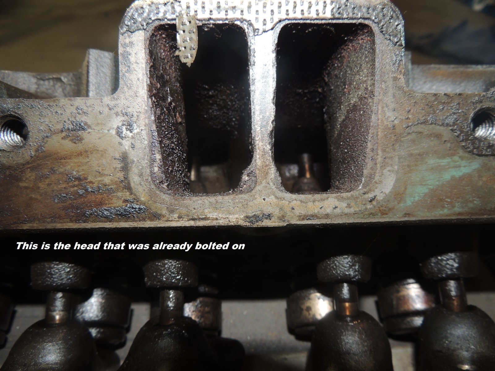

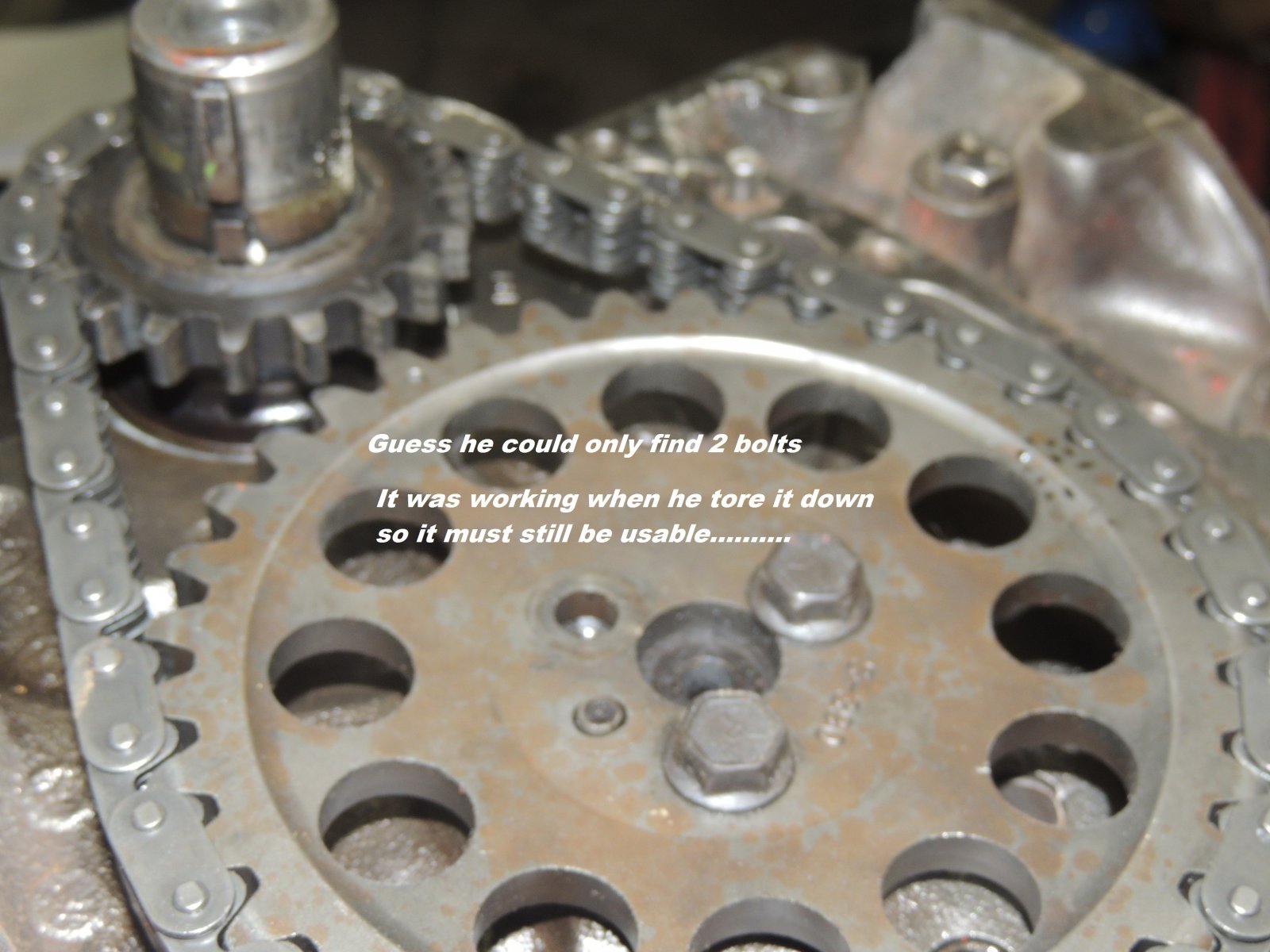

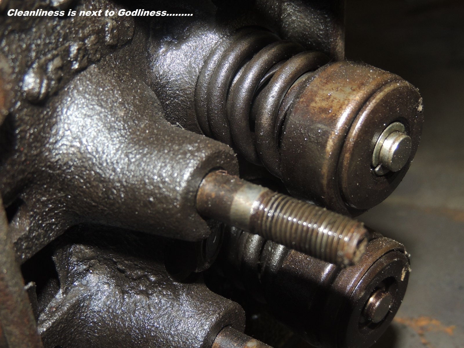

    Who is the worst mechanic you ever saw or dealt with..............
    I used to think it was me back when I was 16 years old, but today I think someone took my ***le and it wasn't even close. I decided it would be nice to pick up a 350 core to save for someday. Perused the local Facebook Marketplace and found a likely candidate. Sent the guy an offer.
    Then I saw another one that had an aluminum intake with it. So I shot him an offer too. Both guys accepted. First guy was moving and wanted to unload it. Fairly knowledgeable guy with a neat 51 Chevy coupe he was driving while modifying. Already had a 350 in it.
    Second guy was much younger. Worked as a mechanic (* don't know what else to call him) at a tool rental place. Very nice guy. He explained that the block had new cam bearings he had installed, honed the cylinders, new rings and bearings (I think) and one new (used ?) piston. Anyway he was pressing a pin into the rod/piston and managed to ruin the piston, so he got frustarated and decide to s**** the project.
    Now I'm not complaining cause I got everything for $200 and I figure the aluminum Weiand intake is probably worth a hundred. The thing that amazed me was the complete lack of effort to build the engine in a manner that would even give a marginal chance for it to survive for 5 minutes......... Below are the photographic details. :(
    And we wonder why camshafts fail........

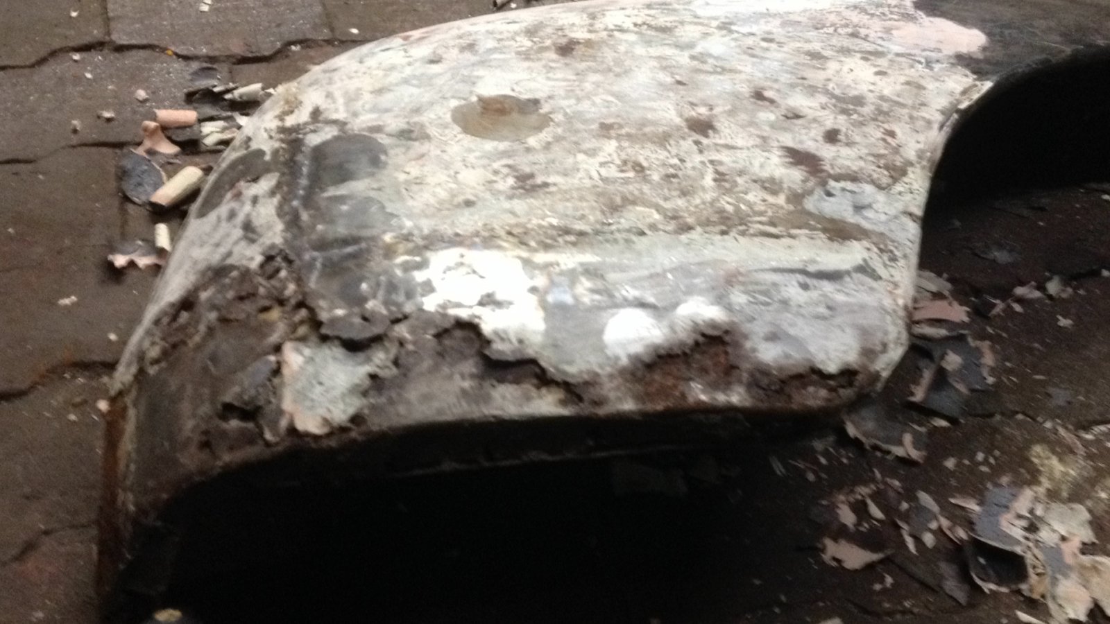

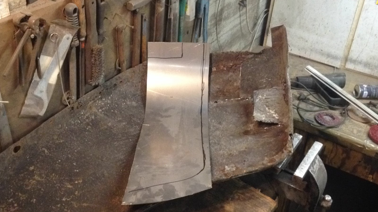

    I guess that's why I always end up taking apart the cars I buy from other people. I try not to, but it snowballs. Some folks just have no real ethics.
    This was in the rockers of a car I paid good money for, so that I didn't have to start from scratch. So much for that...

    That 350 looks like it was worked on by one of the kids would be in the Honda motorcycle shop I worked in during the summer of 1964 buying rings and gaskets for their Honda 50 or Honda 90 or other small bike and then Mom and little brother would show up on Monday with the bike laying in the back of a station wagon and the motor torn apart and in boxes or a dish pan with leaves mixed in. It was my job to take all the parts out of the boxes and clean and sort them and lay them out on the bench so that the mechanic could see what the real damage was. I told them that they should post a sign saying that there was an additional % fee added to the repair bill of any bike that was brought in in parts to be put back together and I think that there is still a sign to that effect over the parts counter in that shop.
