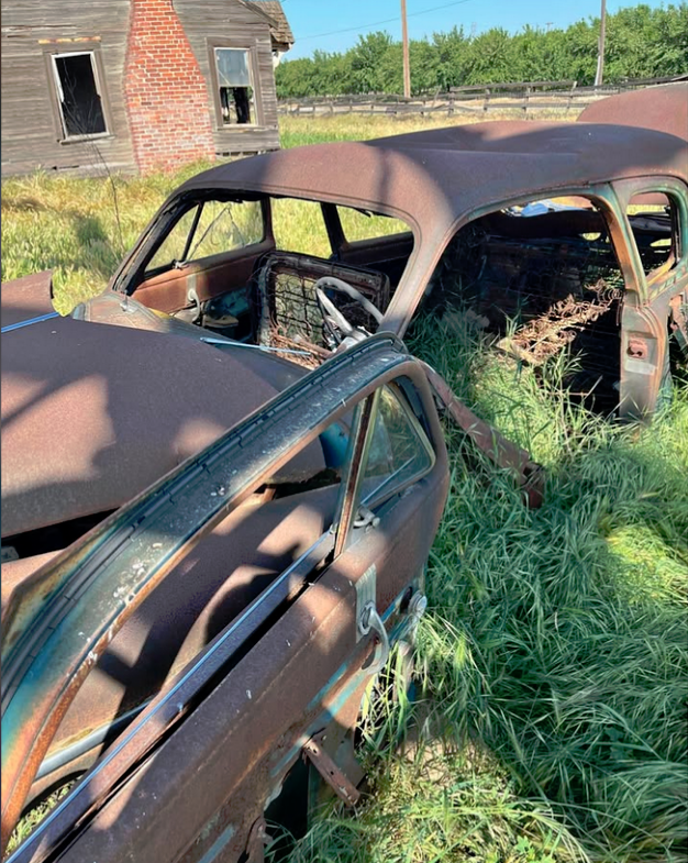

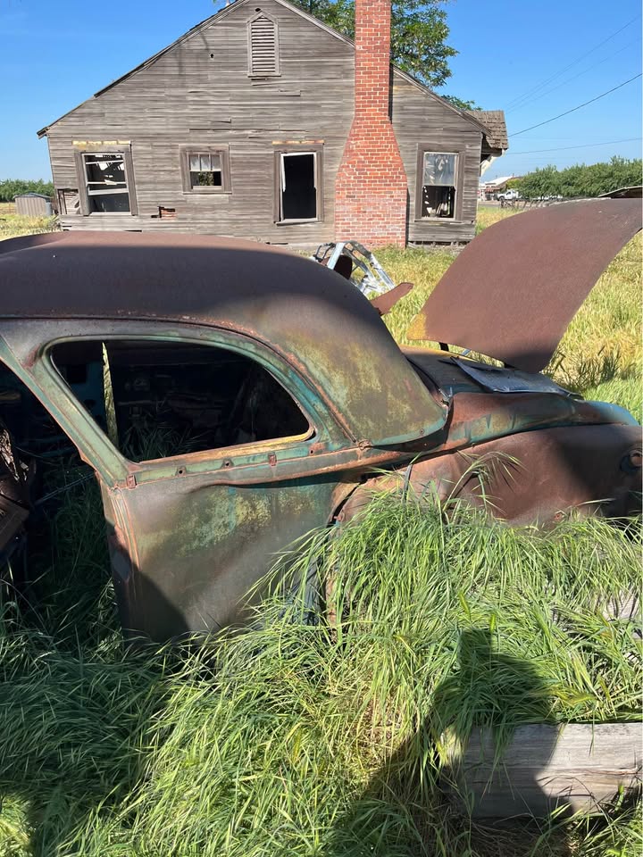

  3. Oops, it's a coupe.

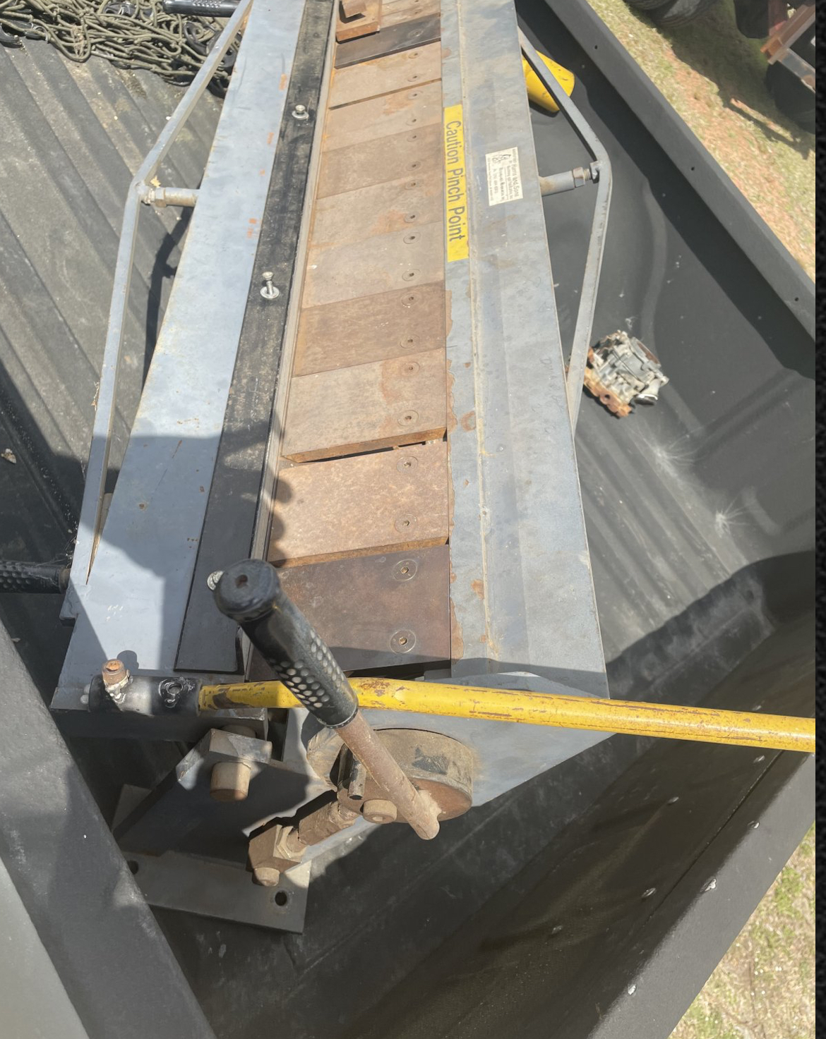

  5. I missed out on this one. I have no idea what brand nor how useful it is. But it's cheap, I'm pretty sure I could easily move that by myself, and it has a small footprint.

    The only thing in that pic worth touching are the chimney bricks.

    To me, someone couldn't give me that "brake". You will probably ruin more metal than you make good parts. Brakes are designed to handle a certain thickness of metal. Generally bodywork needs about a 16 gage which co-incidentally is about .060 or 1/16 inch. Thats what most people have. Siding brakes for house trim are for thinner metal and they will flex and bend when thicker 16 gage is put in them. A brake with a straight bar from each end is called a "leaf" brake. Don't know why. (Edit: A "siding brake" is one of those portable brakes used for installing thin aluminum siding on houses and is not usable for what we do)
    A brake with removable fingers is co-incidentally called a "finger brake". The removable fingers allow you to bend shapes like boxes which is very handy ..........make that "necessary" for the kind of work you want to do. Don't buy some home made brake as you will most likely regret it. Plan on spending $500/$800 for a "used" finger brake. You can always get your money back if you decide to sell it.
    Get at least a 16 gage finger brake.............
    I bought and sold many brakes in my life.....one as long as 14 feet when I had delusions of building my own airplane. Later I bought a 10 ft brake because the 14' was limited on how thick it would bend, and I gave up the airplane idea. The 10' was at an auction and I tried to convince a friend of mine to buy it. He wanted one and had the money but wouldn't raise his hand. Minimal bidding and looked like it was gonna go cheap......so I bid on it. Couple bids later it was mine. Then he offered me a $100 profit to let him have it. I declined and took my $800 prize home. Used it for about 10 years and then resold it for $2k. Had 3 people wanting it and I actually sold it too cheap. Right now that same brake will bring double that or more.

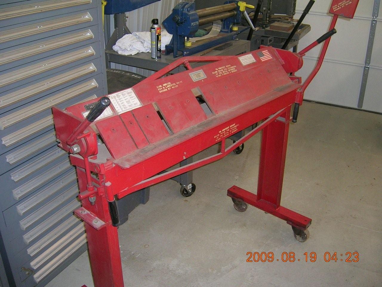

    One of my first cheap brakes.

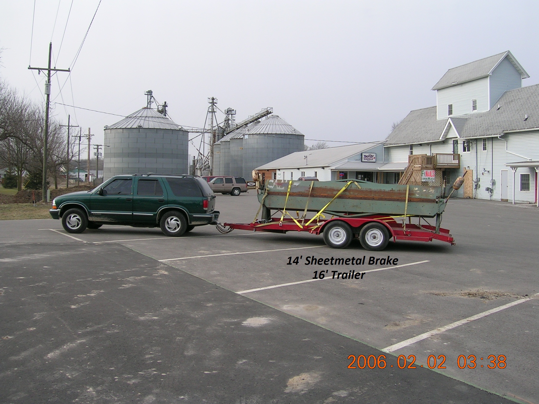

    My 14' brake I hauled home from Michigan. Semi ran me into the emergency lane during a rainstorm..........

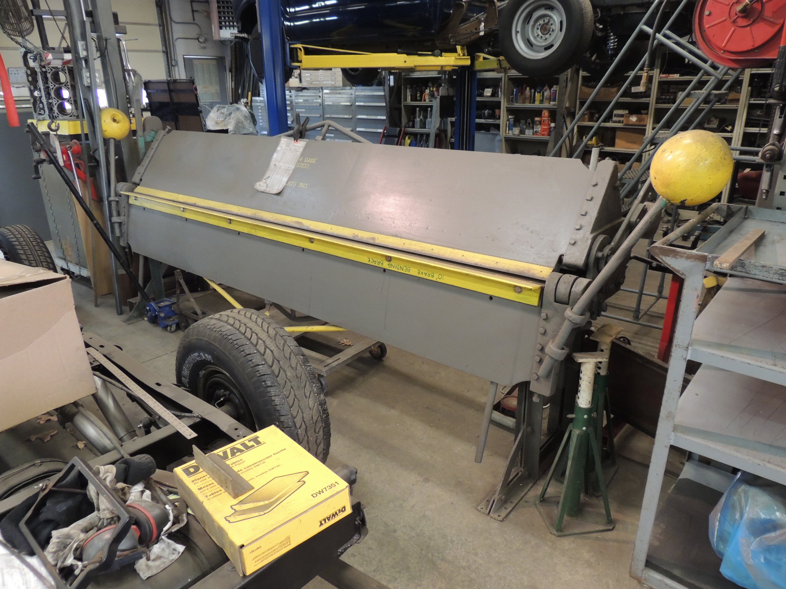

    The 10' $800 brake

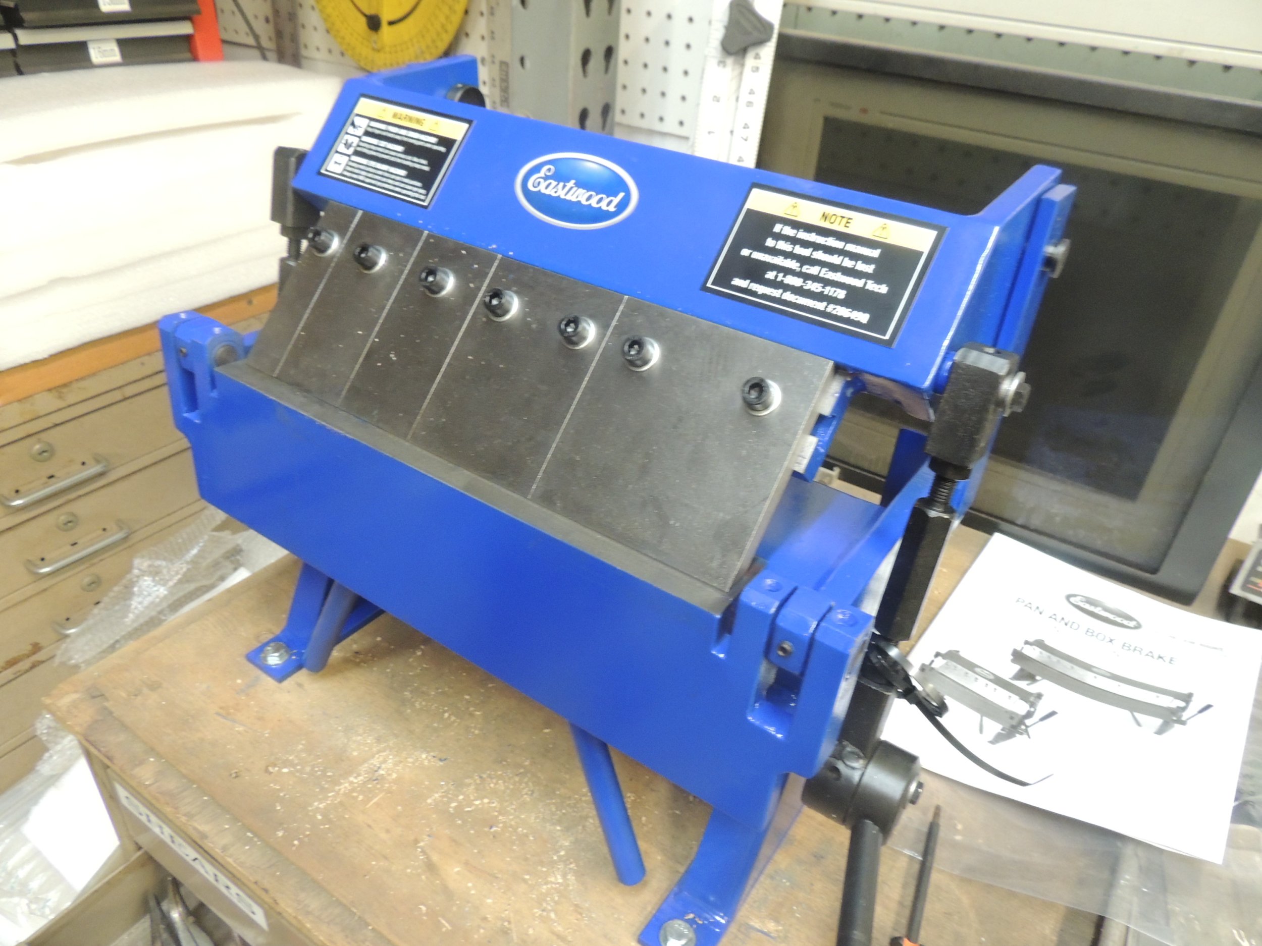

    and my newest addition...........now that those big ones are gone.
    I just find it handy for small thin stuff and I got it on sale. It's limited on thickness but its easy for small brackets where you can get a little thicker.

  15. There’s better breaks out there.
    I’d probably make a homemade one from angle before buying that one
    Got this US made finger break for $200. Decent for 20 gauge or less. Ok on 18

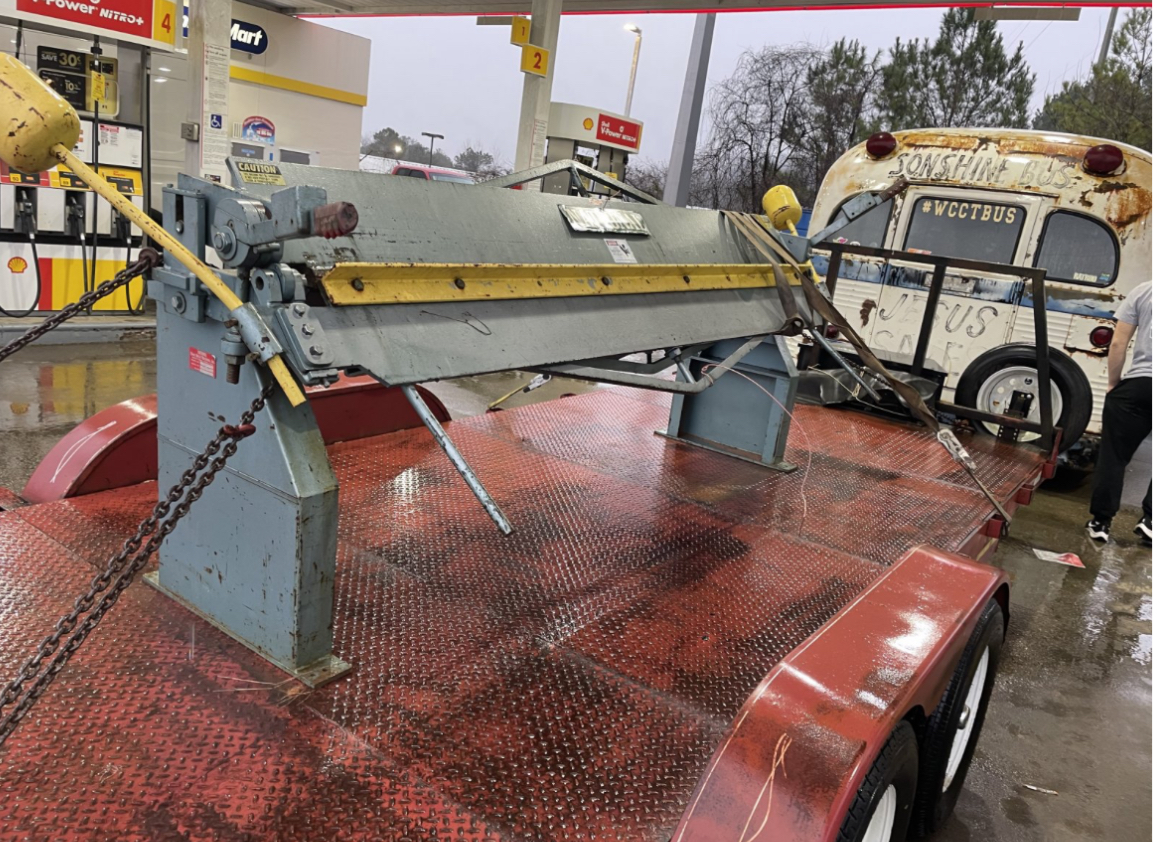

    Looking at the OP’s old car, I think it would be great to learn on. Get some basic tools, take the dents down to bare metal, watch some videos, and get started on a lifetime of learning.

    Most big metal working tools have nuances that aren't easy to spot starting out. If something pops up, ask here. One simple rule though is if you can move it by yourself into the bed of a truck, it's not strong enough. Compare the one you posted to the others. Even the Eastwood benchtop model is big thick castings, not tube legs.
