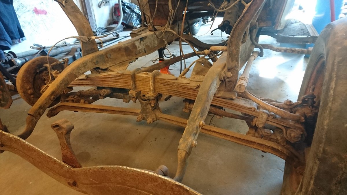

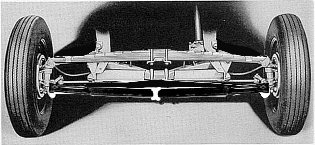

    And, looking around the Hamb some more i found this: Some European company has done this before on a production car (i think it's a Peugeot or other French brand)
    This design left me with 2 questions, which led me to create this tread:
    Would this be considered as an accepted suspension for a fenderless Hot rod? I mean in the context of something like a T with track nose and full hood (like the example above, but with a proper track nose instead of that squared one), where the mounts are hidden and only the spring and beams visible.
    You don't need to tell me this would look atrocious all exposed in something like a '32 with no hood.
    The other question is about the geometry- to locate the axle longitudinally, a simple solution would be split wishbones, very common, right? My question is, They wouldn't work with the wishbones mounted outside/under the frame, right? i did this quick drawing, and to my inexperienced mind, the suspension would pivot around the dotted line, which would cause all kinds of binding and alignment issues...
    They would have to be more or less in line with the beam pivots to work (like the very first picture on this post), or am i seeing it wrong?

    Well, that's exactly the point i'm trying to make, on my design the ends pivot, so the camber change should be similar to a double wishbone setup
    Thanks for the link, i had not seen anything about torsion bars on a solid axle
    Well, it seems some guys are missing the point i'm trying to make-
    First off, i'm not asking if a one time thing is traditional, of course it isn't, i'm asking "if you guys saw this setup at a car show, in an otherwise traditional car, would you notice it like you do with a modern ifs or would it blend in with the traditional style?"
    Second, i tried to edit one of the pics i've sent, to better illustrate my design. keep in mind my image editing skills are subpar at best
    Ok, so here we have it. it's the same concept of the roadster, but with I beams instead of whatever they used
    To further illustrate, i've included the pivot points. Lines in blue are the wishbones, Red dots are lower arm pivots, and yellow the top "arm" (spring) pivots.
    Now, i know the center yellow ones are not pivots, but they are about where the spring movement gets restricted, theoretically making it a pivot of sorts
