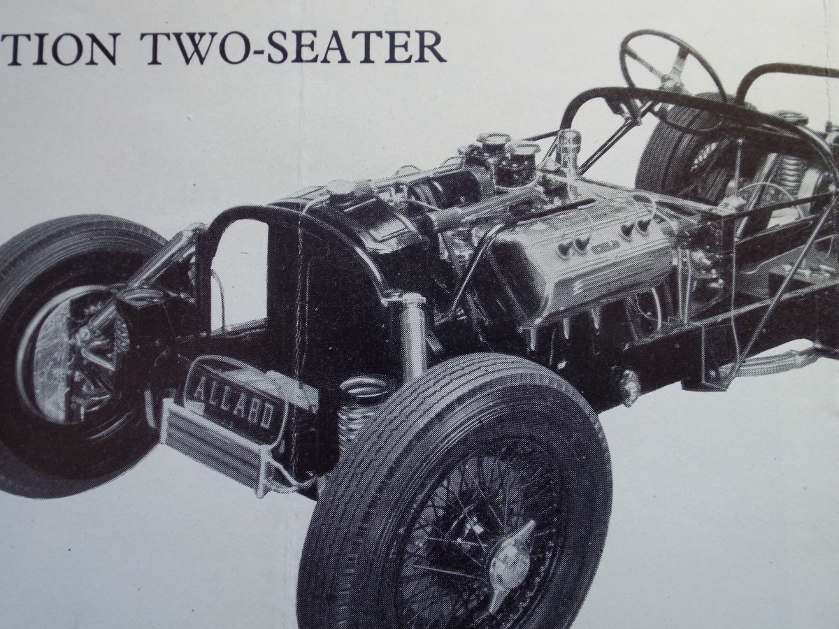

    DSCF0122.JPG DSCF0121.JPG There will always be room for an Allard here. Bob

    All of the examples posted except the ford twin I beam have the same problem. The axles are too short. They need to extend to the opposite frame rail. The point where they crossover would be the roll center. Without the crossover point the front roll center may or may not end up somewhere between the axle pivot point and the load center of the spring. Couple that with a roll center too low on the rear and poor anti squat and you will end up with a car that packs the front wheels in corners.
    It's geometry folks.

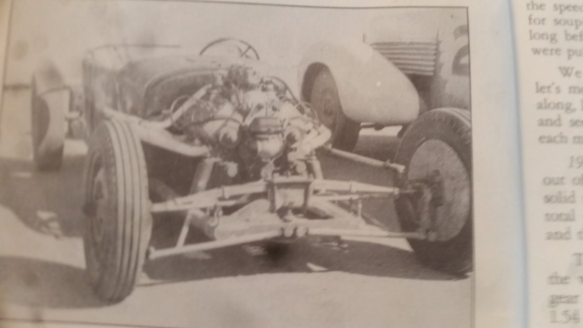

    :rolleyes:...a period suspension shared...
    :rolleyes:...Nates seemingly inspired modern offering shared by @hudson48...
    I have looked at vintage patents and many of them were beyond ingenious and went on in whatever fame they garnered...Many times those in the know can in fact recreate past Excellence and offer it up again with successes not realized back in the day...
    There are also other suspensions depicted here and this one by Nate's may have evolved in inspiration from several directions but it certainly is much more plausibly Hamb friendly noteably lacking that non accepted here billet look...
    I reference the Blair Roadster as it truly is a period Hotrod and it always disturbs me to see genius tossed out in the trash so to speak...AND it actually looks pretty sharp...I wonder how it performed...
    Anyone know?​

    Anthony I don't like to debate Traditional but I know a Bonified Vintage Hotrod worthy of Hamb presence when I see it...Again I like the Kooky face on Blairs Roadster because his genius certainly inspired the evolution...
    Hokey *** is My playground because I enjoy the BIG Picture...;)

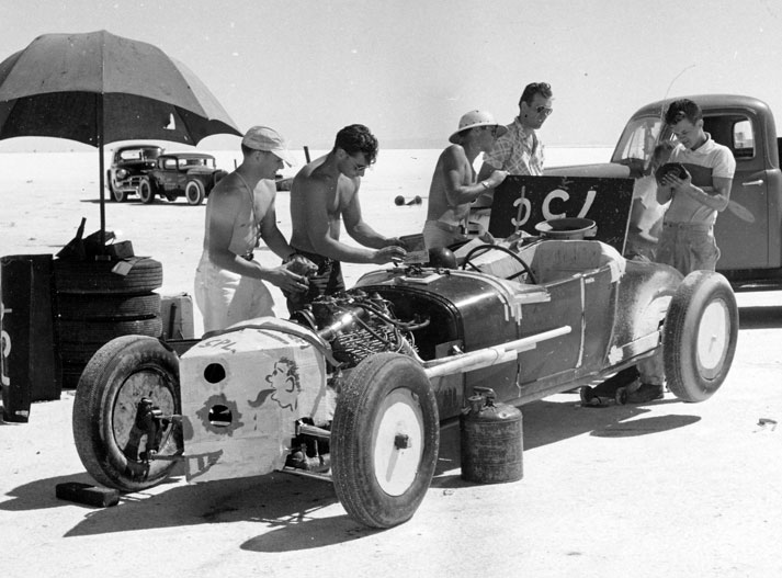

    :rolleyes:...@GraeffSS thanks for bringing this alternative to the revered more commonly used front suspensions...I don't believe Blairs Suspension effort was a Hack job by any means...he utilized a similar duty/weighted front suspension out of a period vehicle available at that time and mounted it much like any of the numerous swaps to modify Hotrods at the time were performed...Remember not ALL were Hacks...
    He was known to be a modifier that wasn't brand conscious so to speak and he went on to become quite a successful Racer, Hotrodder and Businessman...
    I have witnessed and shared this Dry Lakes Roadster many times in the Homogenized Thread trying to Correctly Identify what he actually used...I can't remember off hand if we did have a match to date...
    Sorry long winded but again I don't believe hack was in Blairs repertoire...I'm making an ***umption here but I defend his innovation...
