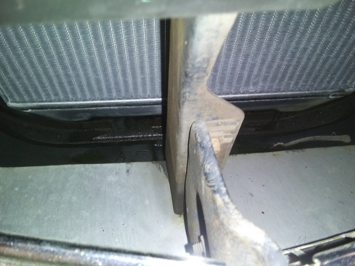

    Had the radiator in the six cylinder position so I had to cut the splash pan,now going back to original location so would this be a problem. I do have the piece I cut out or just wait until I tear apart for final body work. 20210206_085224.jpg

    I think it will; the original has a rubber seal and I would add one even if you need to do it underneath. They really help along with the upper radiator to hood shield with a rubber seal top. Forces all the air thru the radiator when moving and at idle helps the fan pull more thru if you don’t have a shroud..

    Trying to find the upper part right now,might have to buy another to find it and trying to figure out how to put that piece back in the splash pan without removing it.

    I think I came up with a way to put that piece back in but its going to be a rig,I do have another I will use but that will happen when I install the NOS front fenders.

    Since the radiator is not fully in place I took it out so I can fix that hole in the splash pan.

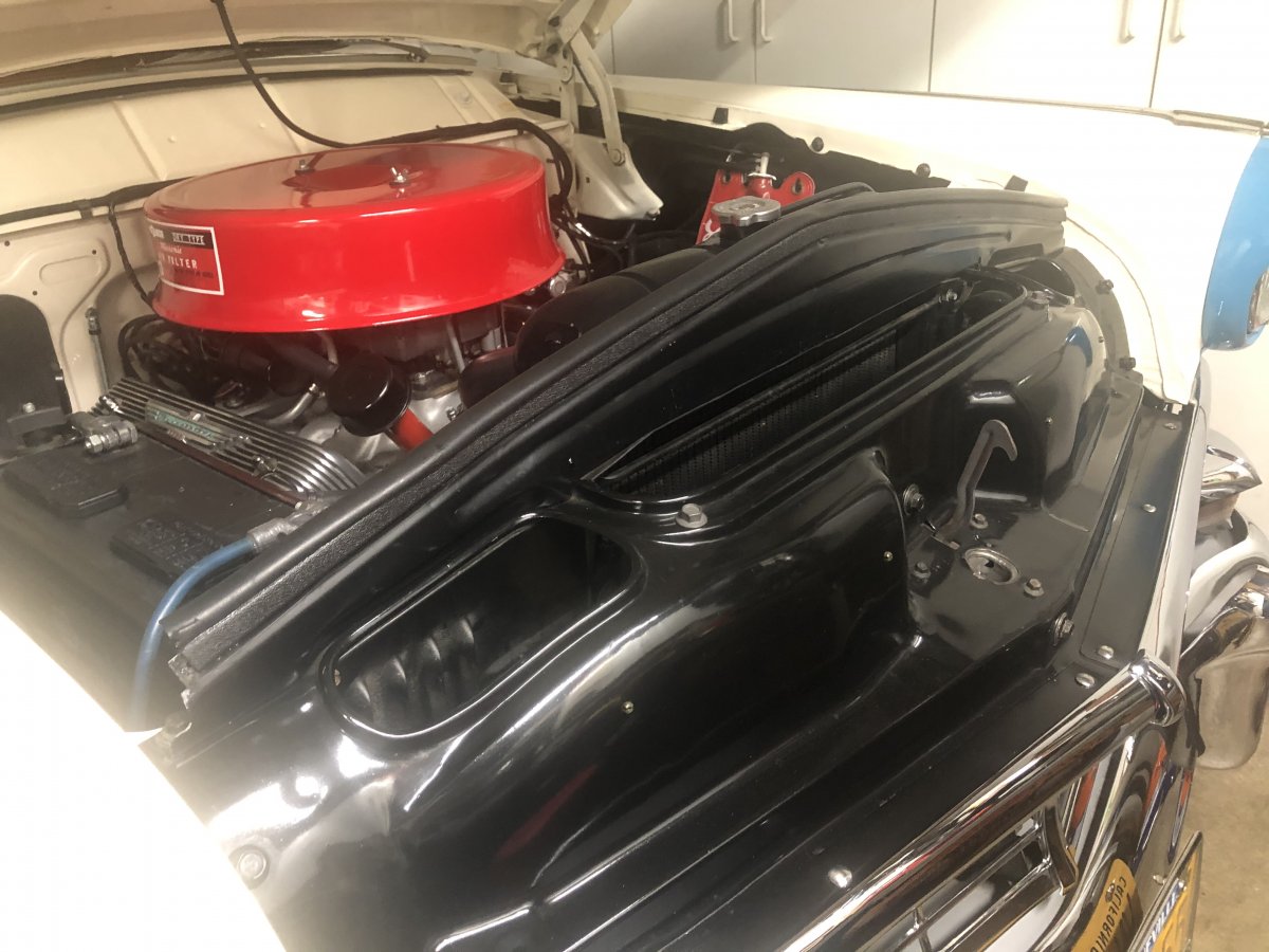

    Jeff. I’ll get some butcher paper and copy the upper shield if you want and mail it to you. One would be easy to make from steel or aluminum. They attach with 4 cap screws. I no longer use the stapled rubber seal. I bought a few feet of tube seal from Mc Master Carr that works fine. It helped with my cooling along with the smaller water pump pulley on my Y block. 9641C856-24C1-42DF-9562-E094F3798B98.jpeg

    The upper shield works for both 6 and 8 cylinder radiators, you just need to use the 6 cylinder
    er radiator brackets.

    Rigged the piece back in the splash pan.
