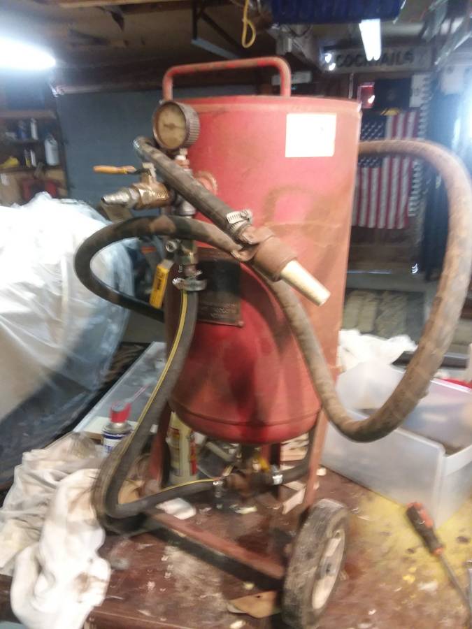

    I'm looking to sandblast rust from my '64 T-Bird, and want to use crushed gl*** medium.
    Found this blaster for sale near to my home, it is a gravity feed but not sure if it would take crushed gl***. I've also been warned in the past, that gravity feed blasters take too long and are too weak as opposed to pressure blasters for big jobs.

    that is not a gravity feed blaster that is a pressure blaster just use a fine grit.

    I use crushed gl*** in one shaped exactly like that. Mine came from Northern tool. Works fine. Make sure you run it through a screen.

    You will want a compressor that can move some air. The larger the nozzle opening, the more air you need. The nozzles wear larger over time as the abrasive runs through.

    Even a blast cabinet with a small nozzle will put a stress on a decent air compressor. That style of blaster will give you plenty of rest time while the compressor rests or fills the tank back up with air. Unless you go rent one of the big gas powered industrial compressors expect to spend plenty of time in the same pose as Laroke showed in post 9. Sometimes that isn't entirely a bad thing as you are usually ready for a break pretty quick anyhow.

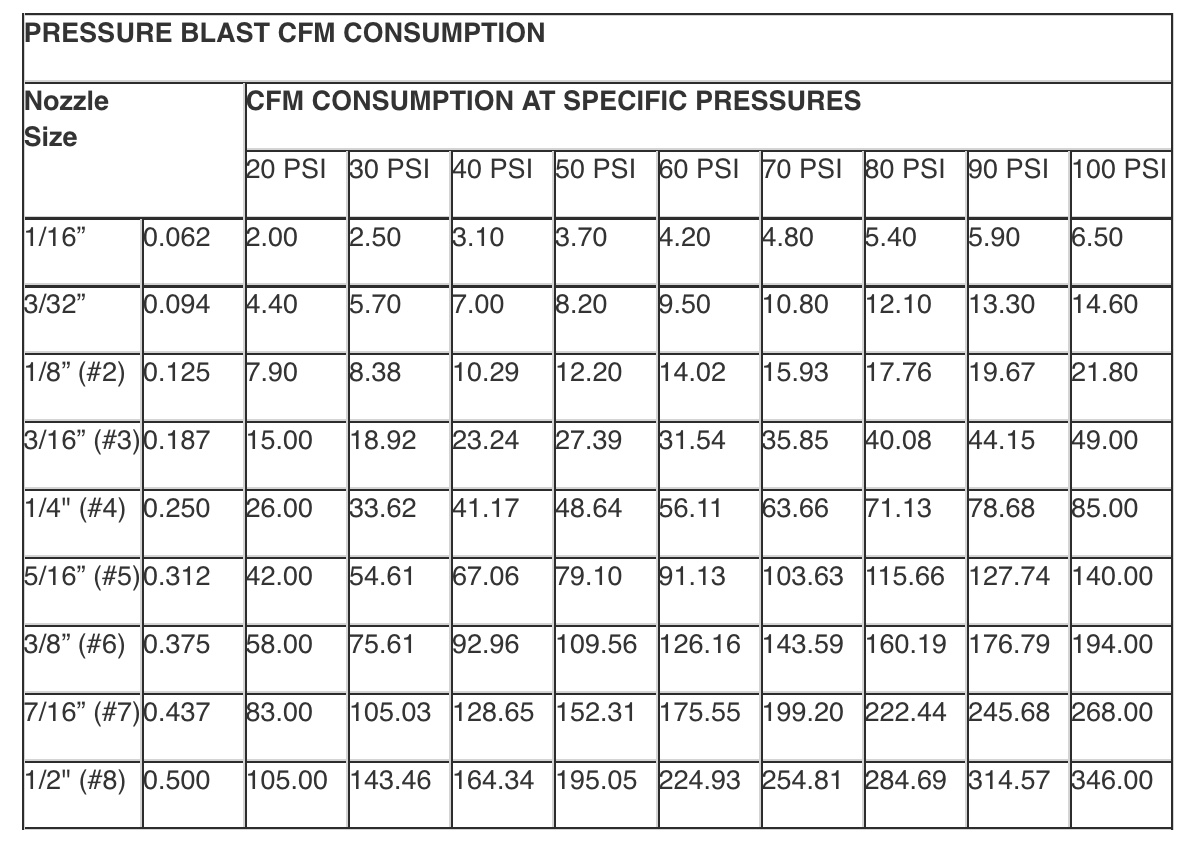

    You may be a little short of air. I've got a chart from Clemco that shows a 1/8" nozzle will use 11cfm at 50 psi. That jumps to 16 cfm at 75 psi.
    It all depends on how much blasting you need to do, and the time frame involved. If you plan to do it all at one time, you could rent a 90 cfm diesel compressor for about $110/day, or $300/week and use a 1/4" nozzle on the same blaster to really get with the program. Might seem expensive at first glance, but doing a lot of blasting with a small nozzle and too small air supply can get really frustrating real fast.
    For comparison purposes, I've got several different nozzles for my blasting rig so it can be used with various compressors. With a 1/4" nozzle and our 100 cfm compressor, I can blast an entire car frame to clean white condition in 3 hours or less, ***uming I'm starting with something that's been pressure washed or otherwise free of oil and grease. If I brought the blaster home and bought a 1/8" nozzle for it, I would easily expect to spend 3 days of blasting and waiting on the compressor using my home shop compressor that's about the same size as yours, to end up with the same results. Once you stick your head in a blasting hood, its not just a matter of having whatever time is required to do the job, but rather dealing with the discomfort of the hood which gives a whole new meaning to the word miserable.

    True, but you've got a compressor that's big enough to feed a 1/8" nozzle. The OP doesn't. He said 11 dfm @ 90 psi which equates to an actual 3.5 hp regardless of whatever the label may say. A true 5hp compressor will do 15 to 18 cfm, depending on the particular model. He'd need roughly 50% more air than he's got in order to operate at 75 psi.
    I'll freely admit my 3 day estimate wasn't based on having actually blasted a frame with too little air, and I don't intend to try it. Running at 40-50 psi is a waste of time, and stopping to allow the compressor to build back up to full pressure so you can maintain 70-75 psi minimum pressure will take more time than the actual blasting time. The ratio is pretty simple really. Using air at 75 psi and 16 cfm, and stopping at say 70 psi for the tank to build back up at 11 cfm to 125 psi, with a 60 gal tank you'd get about 2 minutes blasting time followed by 3 minutes of wait time. This ignores the fact that the compressor isn't going to deliver the full 11 cfm at the upper end of the pressure range, and ignores temperature effects as well. My WAG is that, in steady state operation with the compressor up to operating temperature you'd have something closer to 2 minutes of blasting followed by 4 minutes of waiting. The air delivery being rated at 90 psi would indicate a single stage compressor, hence the ***umption of a 125 psi cutout pressure.
    Not that hard to make a 3 day job when a shortage of air makes you spend 2/3 of the time waiting.

    Alright, I've been looking into a few sandblasting companies over the past few months. There is a company called MBA (Media Blasting Abrasives) and ALC Keysco, and they give these charts on their website.
    https://www.mediablast.com/sandblasting-compressed-air-chart
    If these are at all correct for their products, my compressor gets 13.5CFM at 70PSI. I am contacting the company to confirm what the requirments would be, I would not mind their 1/8" but would prefer their 13/64".

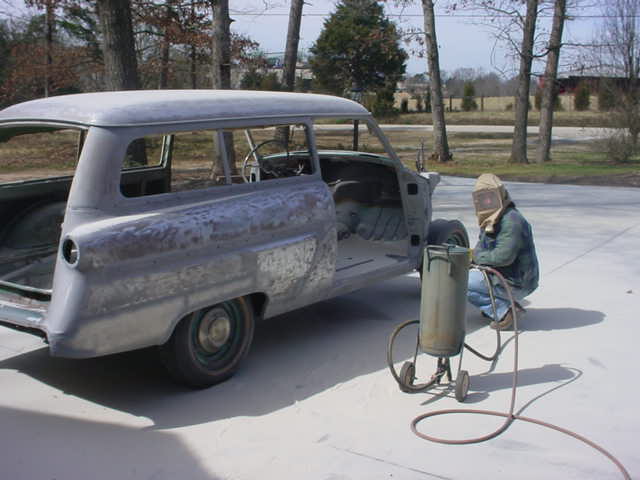

    I just used medium recycled gl*** and was surprisingly pleased on this Scout
