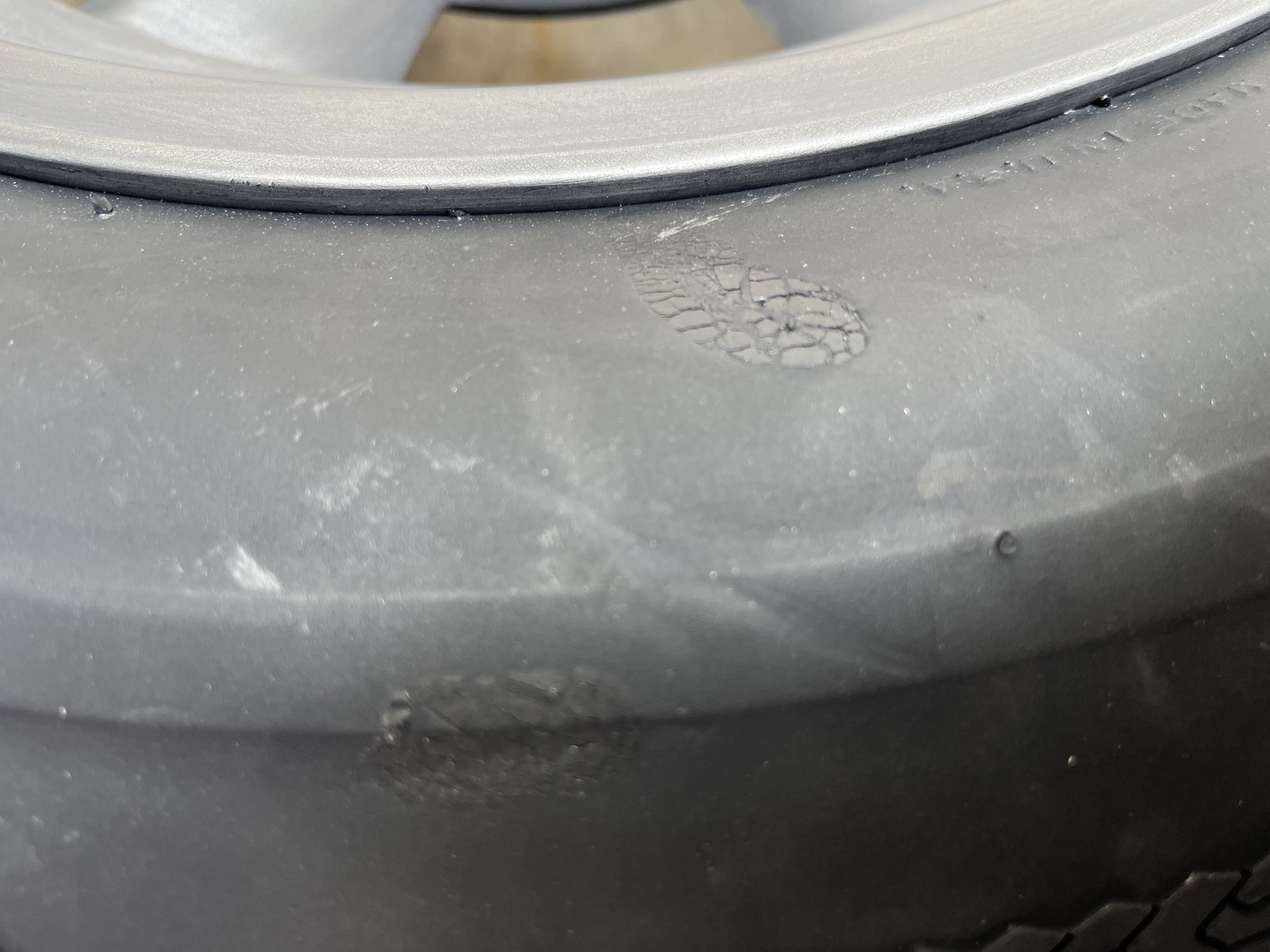

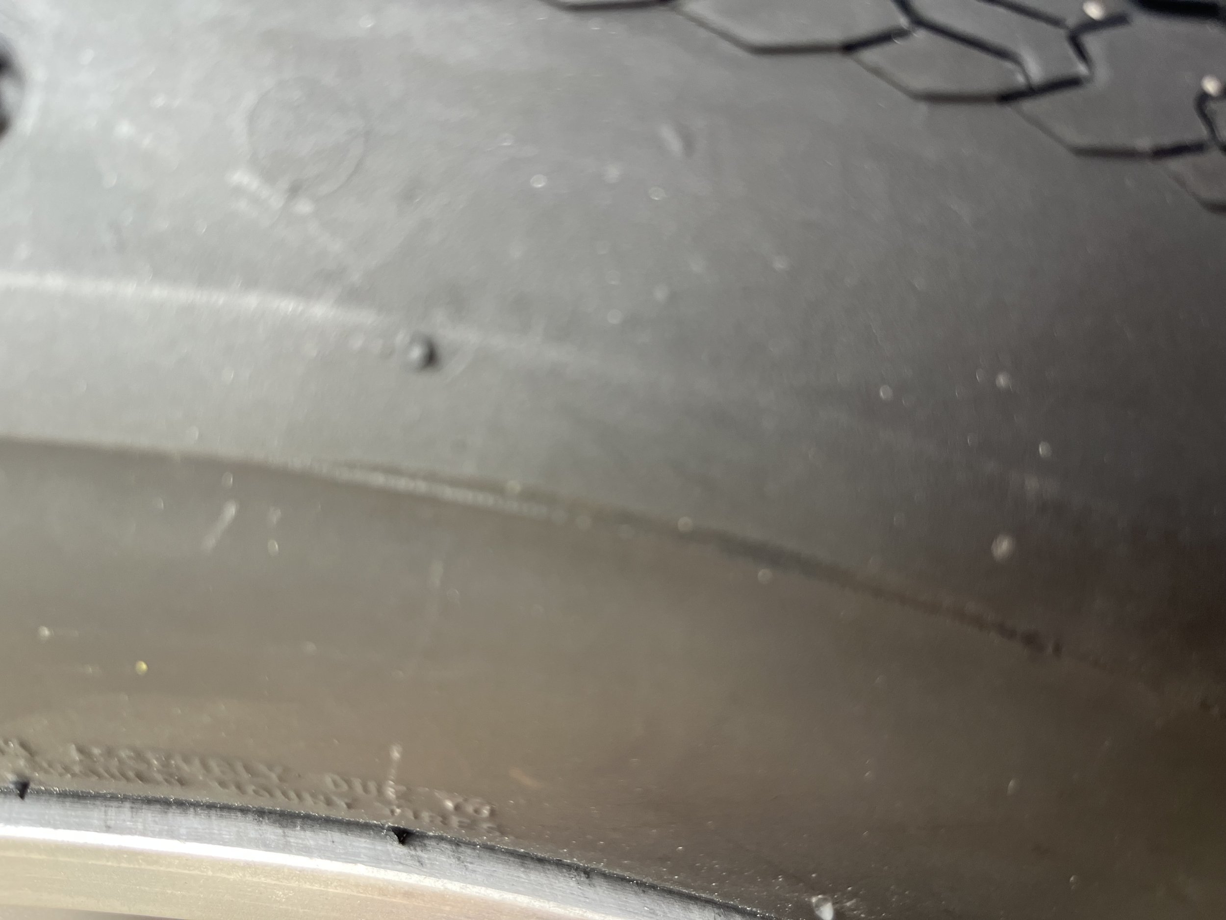

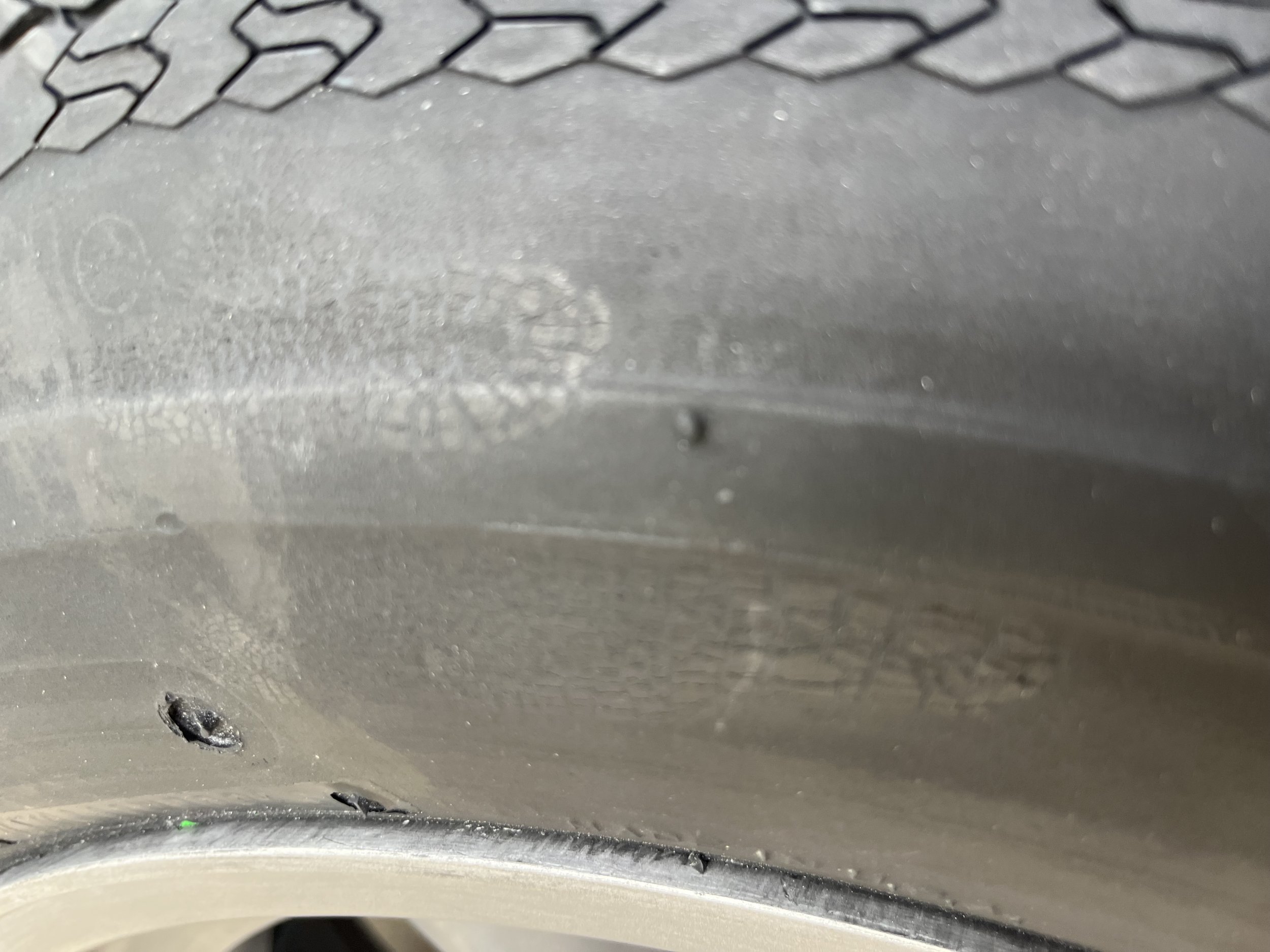

    So I bought some new skinny Pro Tracs from one of the mail order speed shops…I dropped them wrapped in the plastic to my local tire guy and picked them up a few hours later..for over $500.00 I was expecting something better…they have gouges in them, lines separation on the sidewall, and what looks like something dripped on them and “crazed” the sidewall
    Not to mention the crazy weight they needed to add to 1 of the rims to get it to balance out..
    I’m hoping I’m not SOL due to the fact they’ve been mounted…but man talk about lack of quality control

    I’ve seen some of that damage before…..kid at the tire shop used a box cutter to take the wrapper off. The rest….???

    I think you have accepted them by having them mounted. Half that stuff is arguably caused by the shop installing the tires and pretty much impossible to prove other wise since you didn't inspect them before taking to the shop. .Not to be a **** but inspecting stuff you have shipped to you immediately upon receiving it is pretty much buying 101.

    Yeah I get it..but not sure how the installer could drop something on the sidewall that would look like dried up material or splits in the sidewall

    I've had the booger splotches on tires, usually washes off, same with the white scuffing.

    The cuts and the scuffing they can easily blame on the installer. The other (maybe spots where too much mold release was added to the molds?) I would say there is probably about a 99% chance they will just say it is a cosmetic defect and has no effect on the performance of the tire and you should have checked before installing them.

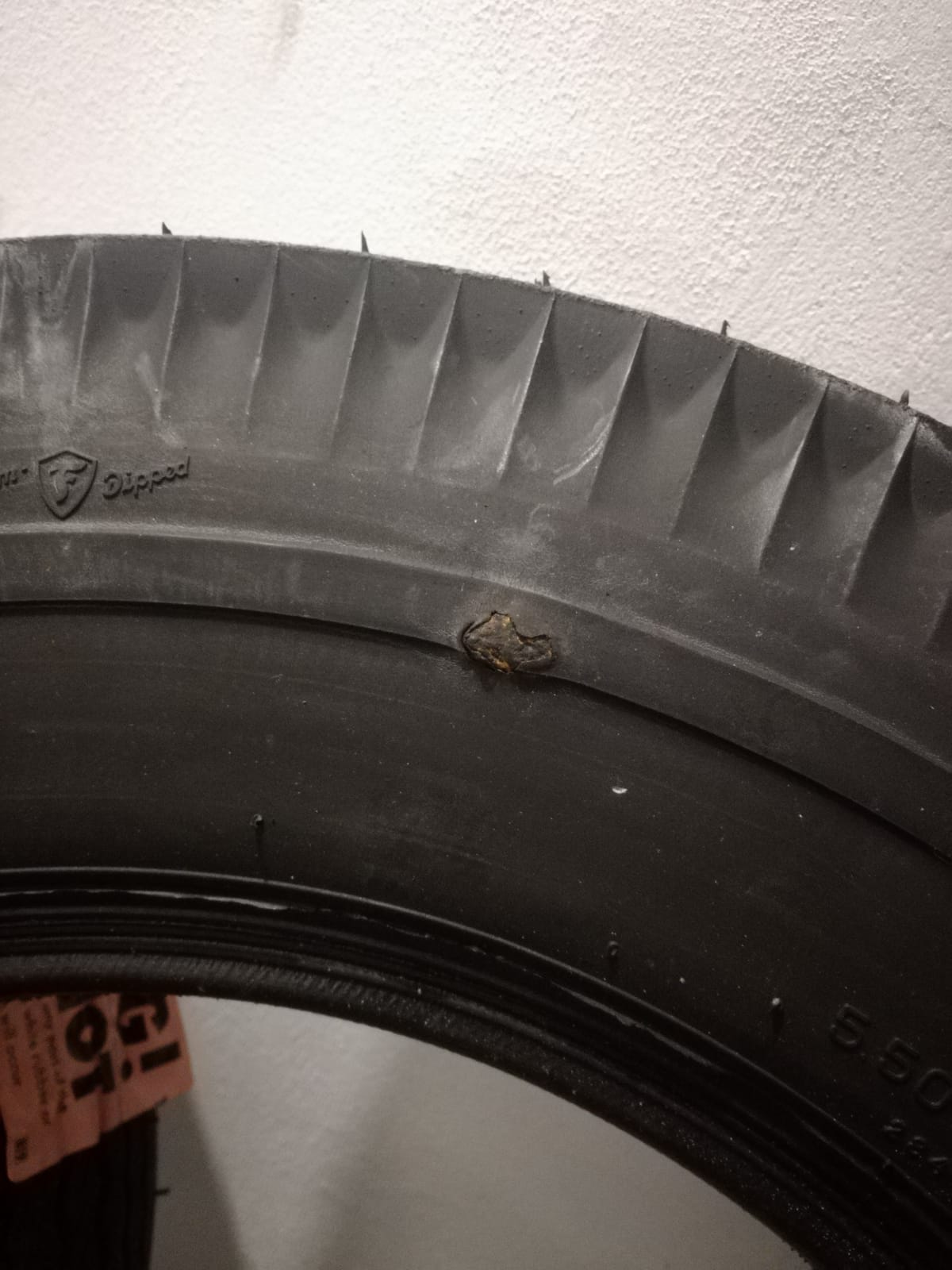

    I have something better - Firestone with stone molded in .

    That stoned Firestone above is too awesome funny. Hopefully fixed.

    After a lifetime of being in the tire biz, I’ll chime in, FWIW.
    A lot of the blotches look like trash or other contaminant in the mold that stuck to the raw rubber when it was cured.
    The scratch/cut COULD be from installation issues. Or from cutting the wrapper on the sidewall instead of in the cavity between the beads. At least it’s on the scrub ring and not on the thinner area of the sidewall. How deep is it? Is it on the inside or outside of the car?
    The excess weight begs the question: did the tech rotate the tire 180* on the rim and see if it would change, or just throw some weights on it and call it good.
    Big “if” that the seller will let you return them, once mounted. Worth a try. Send them the pics.
    I would be talking to the people who did the service about the cut.
    If you totally strike out, the trash, blemishes etc., may come off with a fine Scotchbrite pad and some rubber buffing solvent.

    That Firestone is a cl***ic FUBAB! Wonder if Coker would tap dance around that?

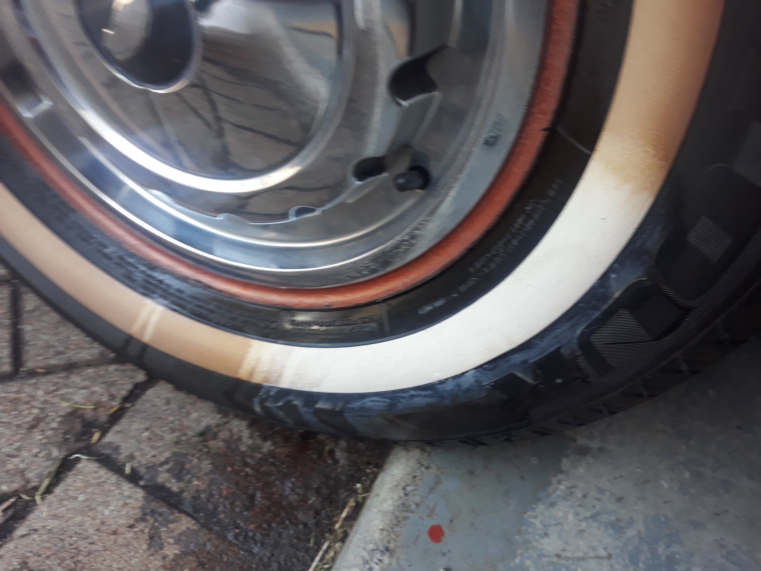

    Spray some "concrete cleaner" on them and lightly scuff it with a scotch pad [then wash the tyres]
    They'll look new
    Here's a semi finished example

    Old dirty molds bound to press out crusty tires.
    Light cracking where the black /white /wall ridge is almost looks like they used a case under with a recapp.
    What I have learned about balancing is when we see a lot of weight used, take the tire back off and spin just the wheel only with out a tire on it.
    No one does that, and I've learned that in some cases the wheel itself is not balanced. Crazy I know but some of the both steel welded and aluminium were not turned evenly that you cant see unless you ran a dial indicator around it.
