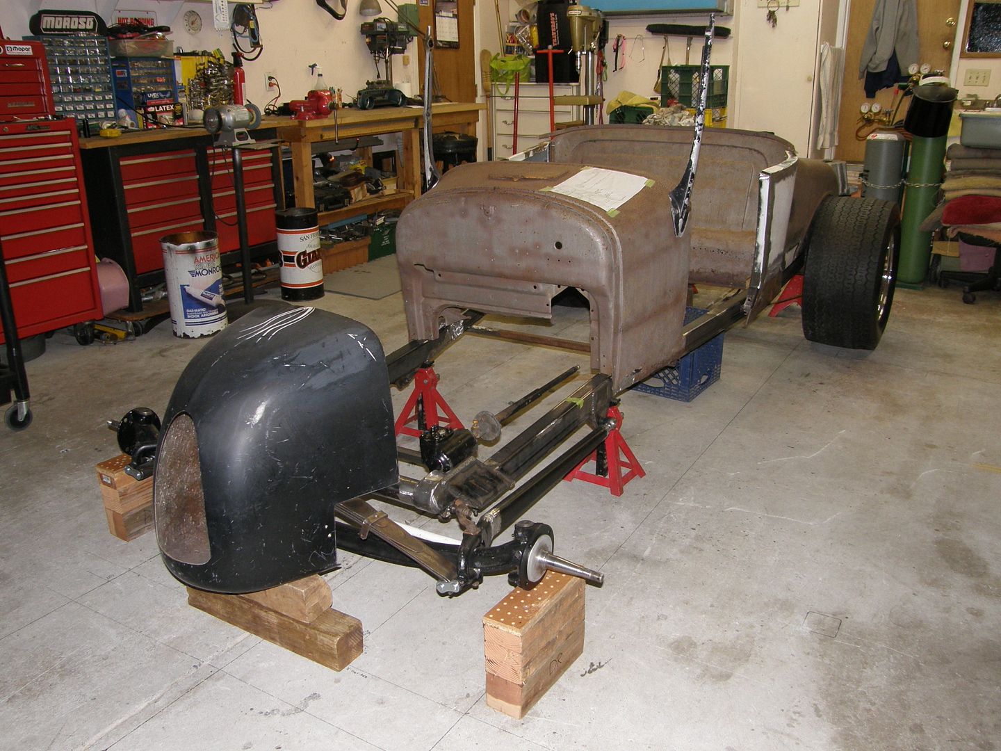

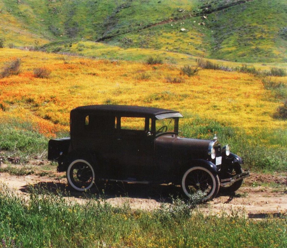

    I like the idea of keeping a 4 cylinder engine in a car that came with one.
    I am putting Mercury Marine 4 cylinder engines in my Model A Fords and in my 1965 544 Volvo.
    They will sound and look right and will perform very well.

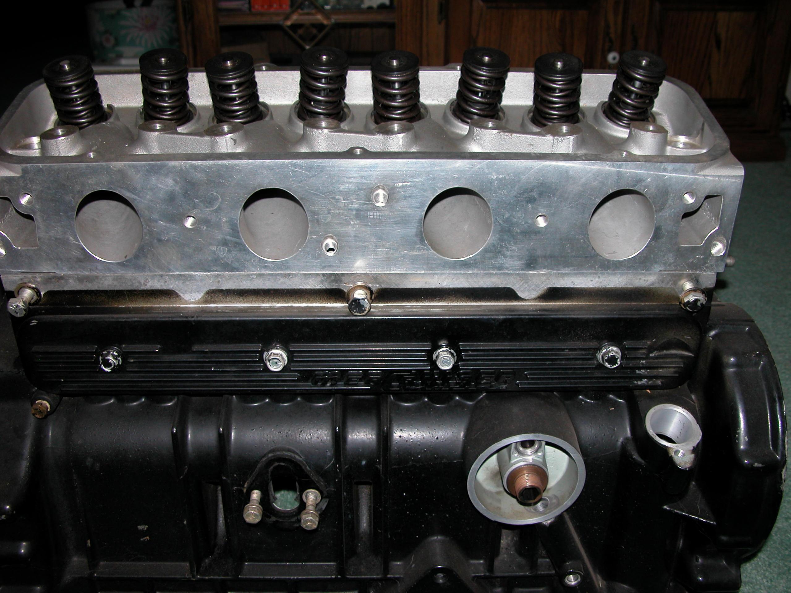

    The Chevrolet based 2.5 and 3.0 Mercruiser 4 cylinder put out 120 to 140 hp and will make a 2300 lb car Freeway safe.
    The 460 Ford big block based aluminum 4 cylinder can easily put out 190 to 225 hp and weighs about 300 lbs dressed. They will make a 2300lb car scream.
    Turbocharged the big block 3.7 liter Mercruiser will pump out over 300 hp and 300 ft/lb of torque in a mild state of tune.
    The 4.36" bore and 3.75" stroke together with the QuadraJet 4 barrel carb make for good torque.
    The aluminum block weighs 75 lbs. The intake valves are 2.19" with 1.75" exhaust with a low cost aftermarket 460 Ford aluminum head and these engines have produced 500 hp with more sophisticated aluminum heads.
    YOU'VE PROBABLY SEEN THIS YouTube 29 MODEL A BUT HERE IT IS AGAIN FOR THOSE WHO HAVEN'T.
    http://www.youtube.com/watch?v=iFSGSL3Nrmc

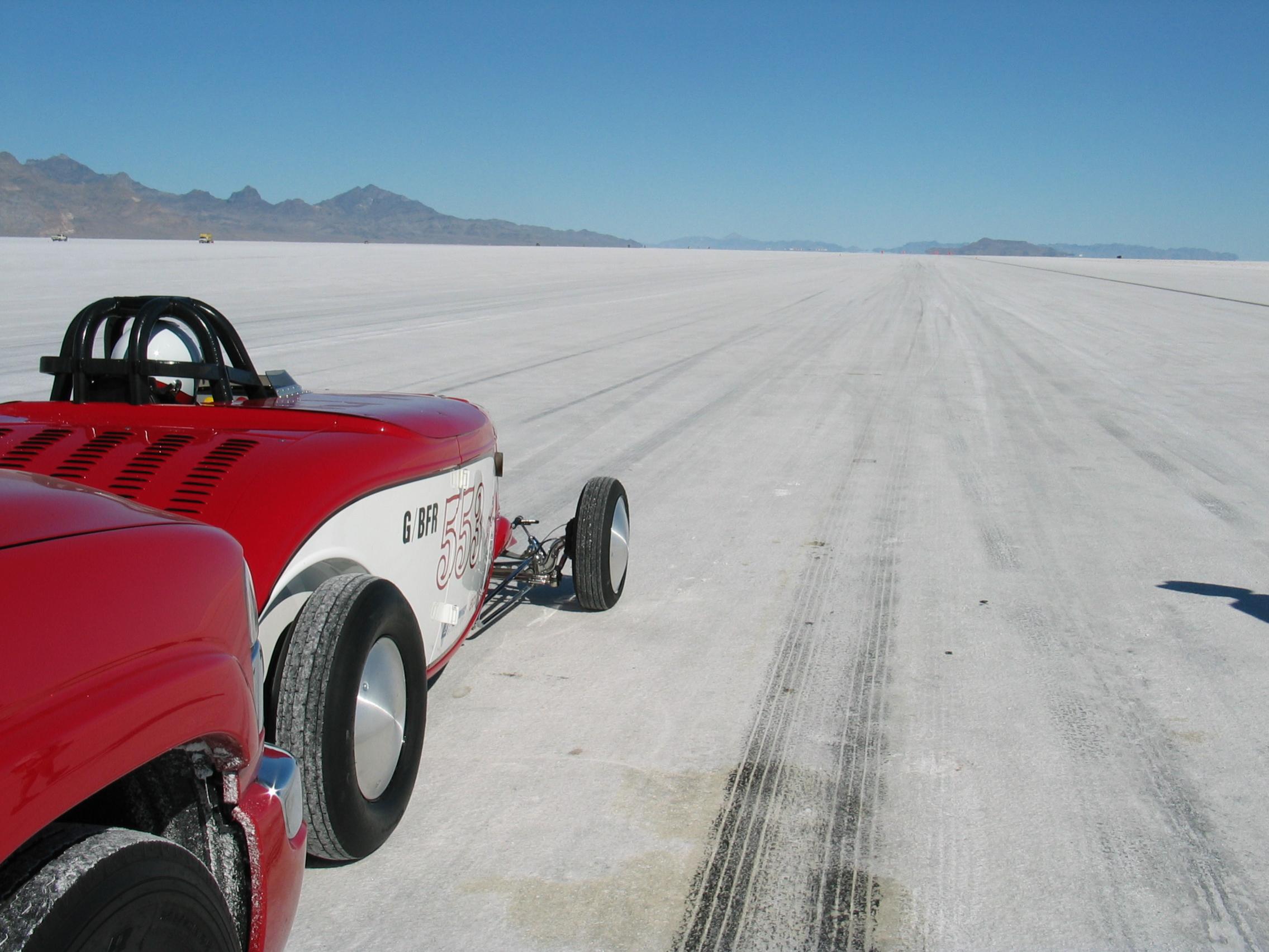

    I would. And we have. I've posted this before but I feel the need to defend the Ecotec. Here is a Dyno run of our roadster. It holds the G/BFR and G/BGR records at Bonneville, with a best of over 212mph. Makes about 950 hp. We drove the car over 700 miles from Pomona to the Salt Flats and went 207mph on the first p***. Just my opinion but I'll take those numbers.
    http://www.youtube.com/watch?v=nfPORMFZ-VA
