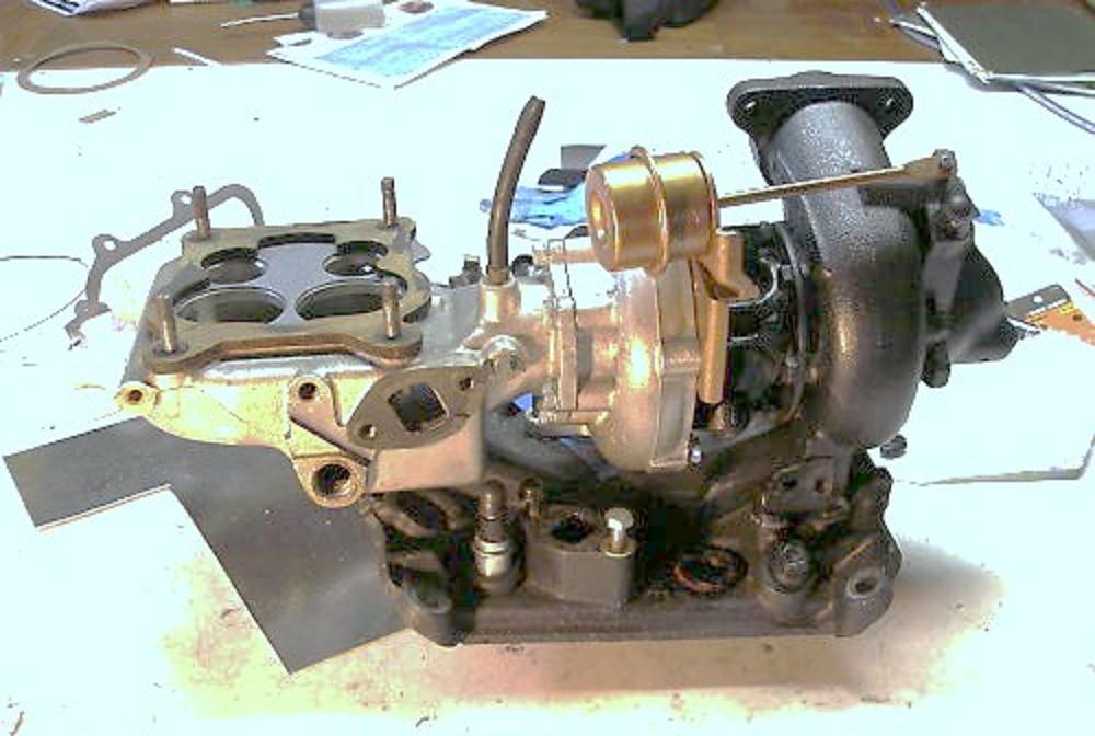

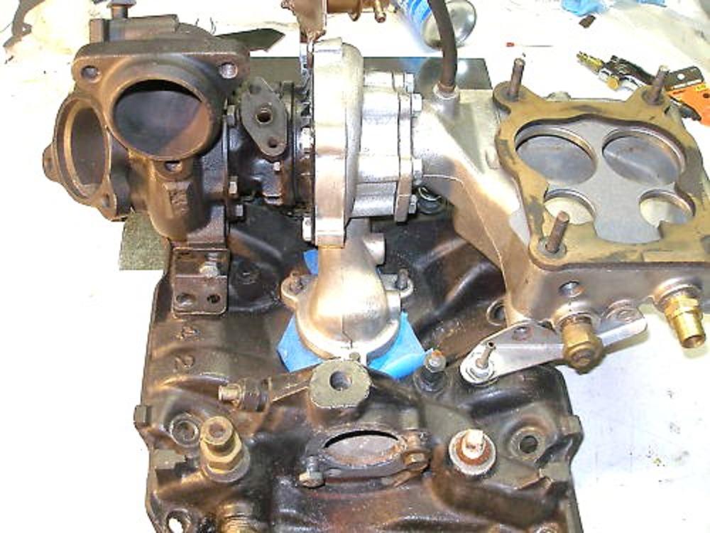

    Mercury Marine engineered this engine using their own 75 lb. die cast aluminum block, cam and crank. They used a Ford 460 head, pistons, rods and other various Ford bearings and flywheel parts to create a 224 ci (3.7 liter) 4 cylinder boat engine.
    In a Mercruiser configured inboard outdrive style of installation they produced 165 to 190 hp at 4600 to 4800 constant rpm max.
    With the conversion to a car configuration including an aluminum head and other slight modifications they will produce about 225 hp at 5500 to 6000 rpm using the Mercruiser 4 barrel manifold and Rochester Quadrajet that came on the 190 hp Mercruiser.
    The engine came with a 8.8 to 1 compression ratio which would lend it's self to Turbo charging.
    With a mild Turbo I am sure that they will produce a hefty 300 hp and gobs of tourque.

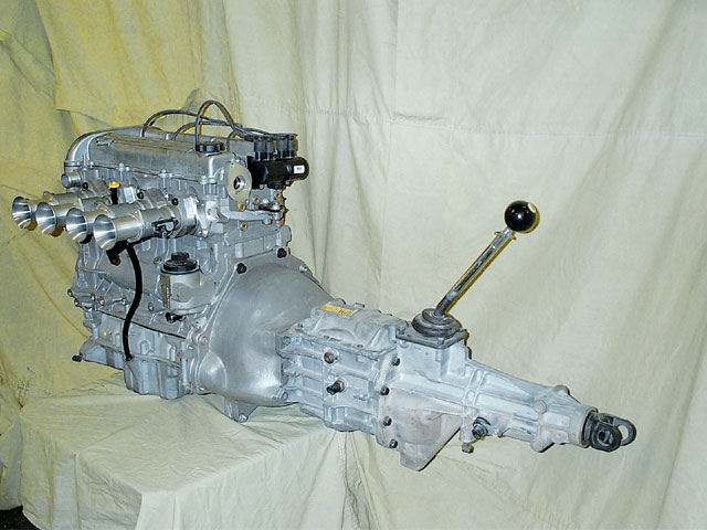

    Another bonus of these engines is weight savings.
    The complete engine and a T-5 5 speed weigh about 365 lbs.
    The 300 to 400 lb weight savings over most V8 engines equals extra hp especially when installed in a light weight car where the power to weight ratio is good.

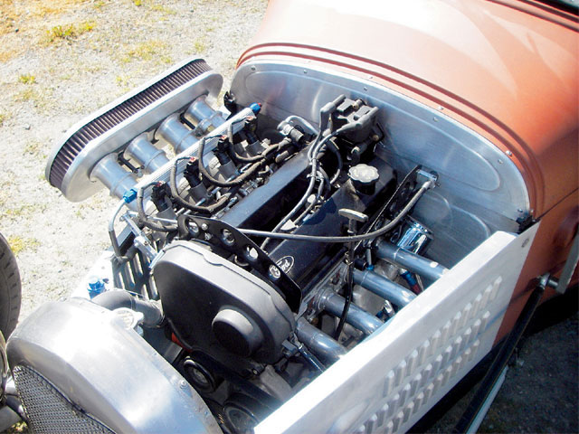

    of course, dunno why i didnt think of that....and that one in the picture you posted is super nice.
    There you have it! for all of you guys that think a 4 cyl would self destruct ina old truck!
