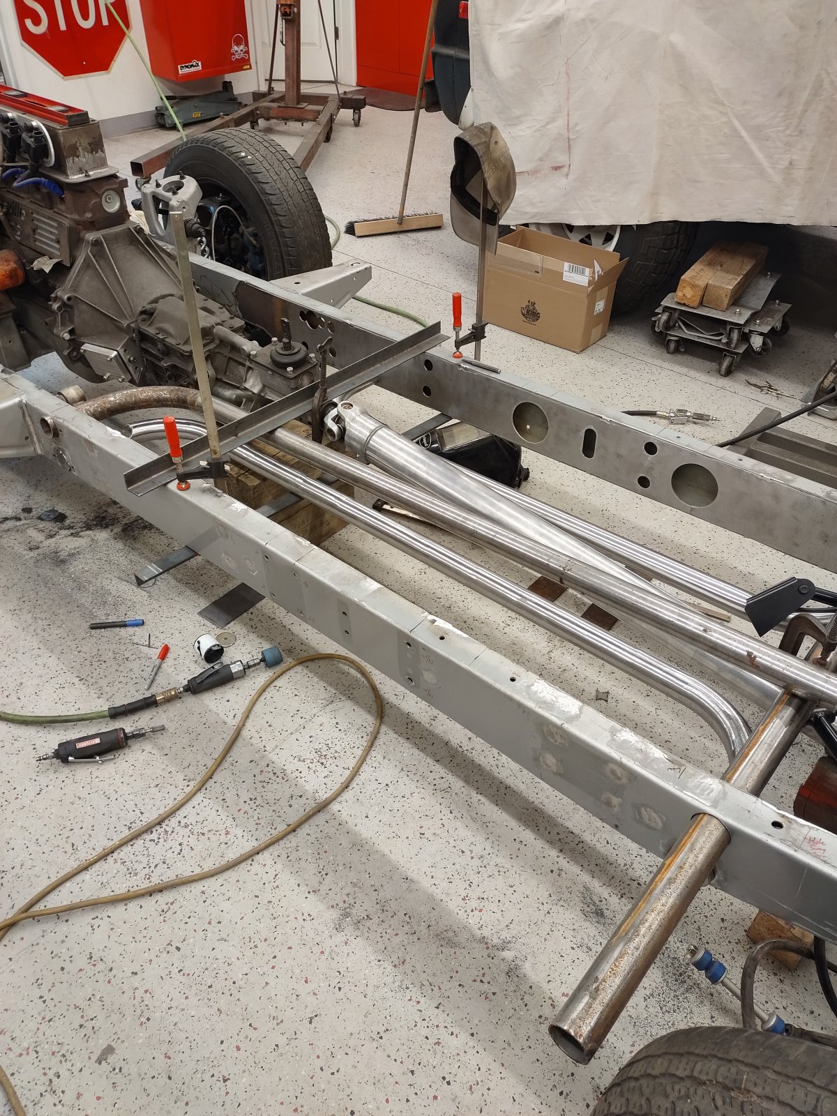

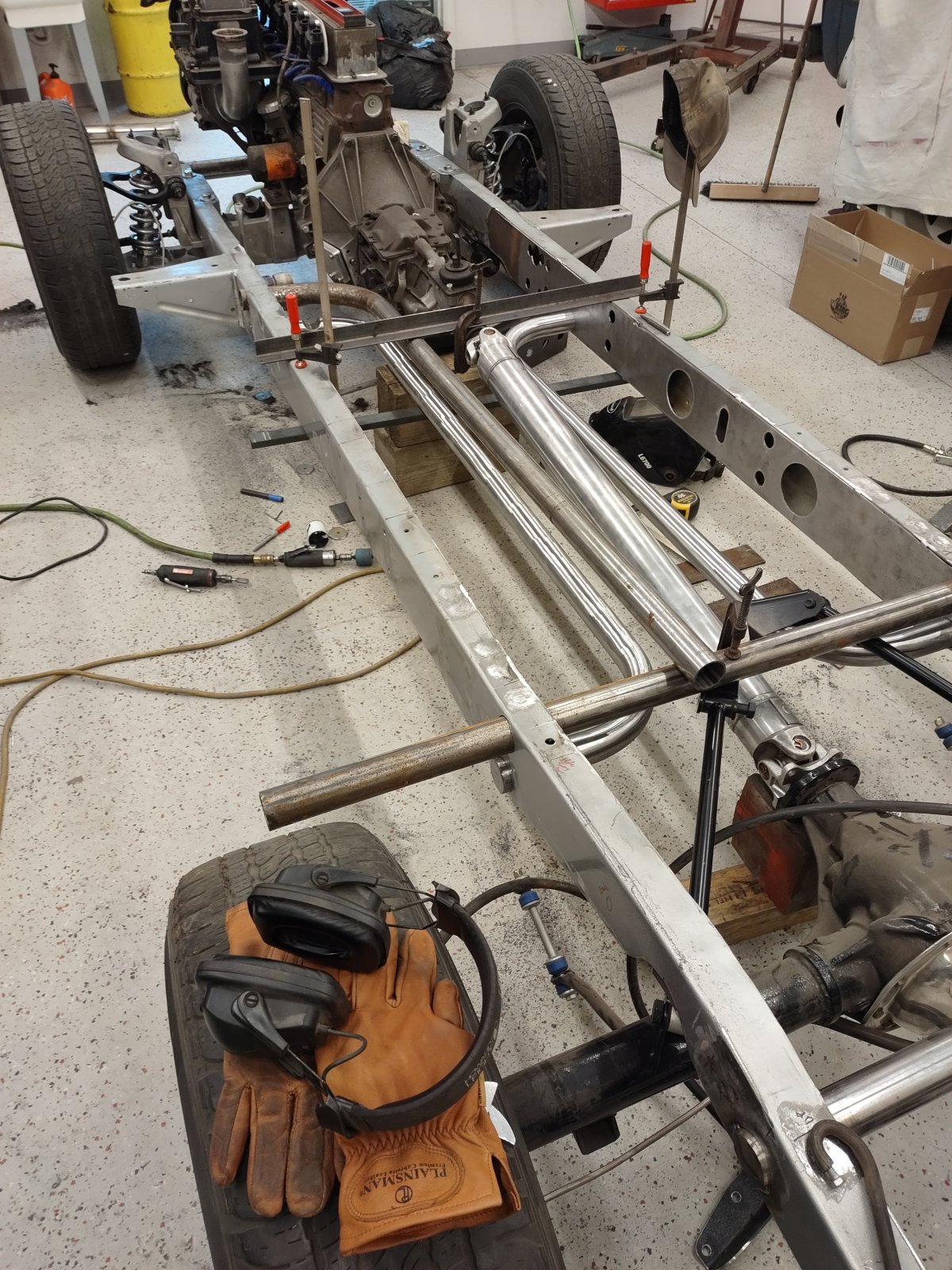

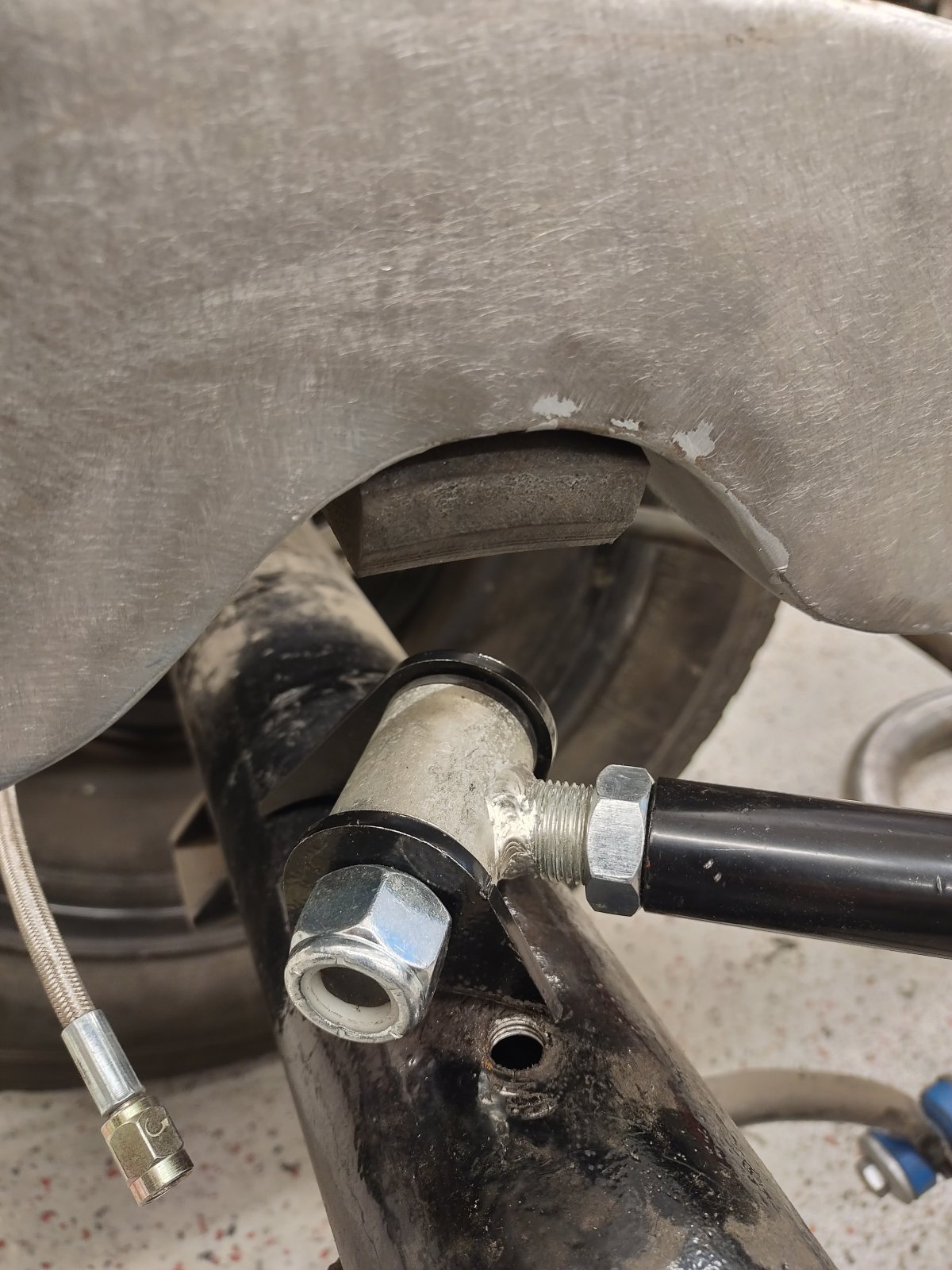

Technical Would you guys have an issue with integrating your bump stops into the 4link?
Discussion in 'The Hokey Ass Message Board' started by tlmartin84, Dec 29, 2021.
  1. tlmartin84
    Joined: Jul 28, 2011
    Posts: 1,068
    tlmartin84
    from WV
    1. The tabs would be boxed, so contact would be made on the top of the tab "box" and not the tabs alone.
    2. There is NO chance of the link contacting the frame. Even if the bump stop is missing nothing can contact the link, or end link. Even with slight side to side movement, I still have a 1/2" or more of clearance between the frame and bar
    3. I know this probably isn't ideal, but I can't see how it could hurt anything. It would have to completely collapse the tabs. If they are boxed, I can't see that happening unless something else catastrophic happens.
    4. I would prefer not to do this, but I can't get enough angle on my bars if I don't. I also have a brake cable mount I'd have to move if they are moved inward and would prefer not to have to touch it.

    In my view bump clearance would be a little short, raise run height to give around 3" and should be tolerable. I wouldn't worry about the boxing.

    Integration is not the way to think of this. Interferrence? I'd put the mounting points on either end of those diagonal bars some place else, no matter what else you have to move around to make it happen.

    Why? If these aren't bump stops, and I move them in, I have to make bump stops...
    The shocks only permit 3" of compression. So I have to limit travel somehow, or the I'll blow the bottom out of the shocks.

    That is about 3" of travel. That's why in my mind this is a winner.
    It acts as a bump stop to keep the shocks from taking a beating, and gives me a good angle on the uppers.

    If it were me, I would move both ends of the bars in, closer together and get them inside the frame then build the bump stop on the frame right in the relief you have cut out.
    It's not going to hurt moving the bars in as long as you keep the angles.
    It looks like your trying to keep the front of the bars on the tubing but I'd have no problem whatsoever building a bracket off the inside the tube and mounting the bars to it.

    Take a deep breath and a step back. Looks like the link is a certain size and you're trying to make it work.
    Move the rear end mounting point inboard, so the frame clears the mounting point. 1) this gives more suspension travel 2) it won't distort or crush the mounting point and cause the ***embly to become un***emblable. 3) this will require the bar length to change or the hoops to be modified.

    The shock is on the outside of the frame rail. About 2" away from the frame and mounted vertical. 3" of travel at it would actually be slightly less at the bump stop.
    It actually equates to around 0.12". So I need to make sure the bump stop is less than that to make sure I don't ever bust a shock.

    If you move the links inboard to clear the notch you will gain more suspension travel. Then get different shocks that won't bottom out. This allows you to lower it more if you want, or just have more suspension travel for big bumps or with people in the back seat. More suspension travel is always a winner.

    I'd shorten the bars enough to get the ends inboard of the frame rail. I ***ume your shocks are coil-overs, outside of the rail, and vertical. If you angle them back slightly you gain a little more travel at the axle. And a little better ride.

    Sorry, but shorten the upper links, quit trying to attach to tubes on the inside of the frame, make a crossmember and transfer your forces forward correctly.
    You can change the CG by the elevation of the top bar in the z axis vs the bottom link bars, Putting the top bars angled down when the bottom are straight helps m***ively on the way the 4 link wants to bite. Your looking at 3" up travel, and 2" down probably in max setup, I would give a bit more than 3" down for loads of heavy people or other things. You notched the frame like you were going lower? Why not go lower then instead of trying to justify a bad setup and raise it up to fit link bars in? I would put the coil overs inside the frame, personally I hate seeing alot of coil over sticking out back in a car.
    Pinion angle from max compression to max drop is negligible here in the setup if you shorten the upper links a few inches. That's all it will take how I am seeing it. 6" off the total length of the bar will fix your issues.
    Definitely read the two links above, the upper 2 bar angles are not rocket science, 30 degrees will work... 25 degrees will work....
