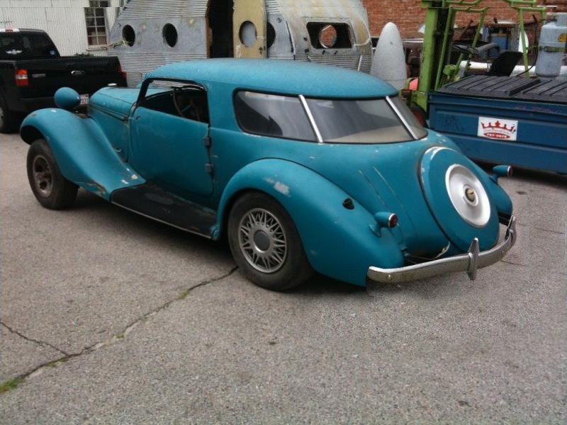

    CUSTOM!!!!!!!!! Since it doesn't seem to be anything famous,i'd change it up a little ...
    The rear gl*** makes it look lika a booth at a bar! I would put a wrap-around seat back there...

    Update: So far, no one on the Studebaker Drivers Club forum recognizes the car, but the feedback is all positive! I will let you know any info that comes up.
    And I think keeping it as close as possible to this version would be way cooler than anything else you could dream up. You can't say it's not unique!

    Wow, that is one wicked Studebaker! From the rear it looks like a 1930s station wagon with those windows. I just had to do a quick photoshop of it with some brand new firestones and a little lowering... I like it in a twisted sort of way. The car looks like something that could have been featured in those first custom trend books. I will keep my eyes open for it in the future reading through my old books and magazines.

    Bobby, I think it would be a shame to cut the top off. It survived this long, and it looks pretty cool, especially with the photchopped wide whites. It deserves to live on, not be cut up to look like every other prewar cut down roadster with a European influence. I know the roof is late '40s but think of the art deco potential inside with that configuration.

    If you do leave the roof, It needs some door frame around the window. that hole is way too big....

    I'm down for restore to "as new custom" state.
    That doesn't look like too bad a color either...
    Fixing the door frame/front window opening so it lines up better with the back window would help the look too.
    Just took a look at the first pictures; repositioning,the headlights, lowering them at least, would help too.

    I'd take a good hard look at the lines, and fix where the original design goes off the mark. As 'Plowboy' mentioned there's a need for improvement at the window opening. If you look at the upper rear window line and continue that line around the turret top the side windows should have the same line. They don't, the line jumps up at least a couple of inches! 'Plowboy' thought maybe doorframes would be the answer. I'm thinking either that or adding the 'missing' metal back into the roof at the top of the window opening. This would have the adverse effect of lowering the headroom for entering the the vehicle, so maybe 'Plowboy's' right about adding a windowframe, as that is attached to the door and keeps the opening taller.
    This bodyline is just one line, but it's an important one! If a bodyman with a good eye for design were to go over this 'Kustom', I'm sure there would be a lot of room for improvement. It would probably be less work to fix than to start over, but not by much! However, the vehicle's place in history is worth something to some people. If it was me, I'd probably chose to start from a blank sheet of paper. There's just too many things that I would 'need' to fix. This kind of early 'Kustom' was a neat attempt at designing something special from existing parts. I refer to this kind of 'Kustom' work as 'Body-blending'. Many of the early 'Kustoms' were a bit lacking in the planning stages, which lead to some rather 'off the mark' designs. They weren't completely awful, just didn't ring true for continuity of the design.

    I like it a lot but get those wheels off of it as soon as possible. It would be too much work to change it back to a roadster - leave it as is with minor corrections where necessary.

    i like the chop idea... i think it could do the car some justice, and you could get rid of a little of the "hump" in the roof

    I leveled out the window and pulled in the bumper a few hundred feet closer.

    I'd love to get turned loose on that...I love it! The Ford 170-200 six appears to have a mercruiser valve cover on it. I'd have to dump the engine and go with a modified stude V/8 like has already been suggested. I wouldn't change the top or rear windows but it needs a ton of "clean up"..

    The faux spare on the back appears to be a '59 Plymouth "FliteSweep" trunklid piece, fondly nicknamed the "toilet seat". Judging by that and the engine this was probably built in the later 60's when stuff like that would be easy to find in a junkyard.
    I wouldn't be too eager to cut it up or make any major changes until it's history could be found. Some wheels and some mechanical work to make it road worthy would be on top of my list if I had it.

    For those who cant read my chicken scratch, here's a breakdown of how i would attack it... :D
    Roof:
    -Chop it 3" in the front, 3.75" in the rear
    -Add door frames to close in the space, and make it feel like less of a disconnect between the later era roofline and the earlier body style
    -Lean the b-pillar forward
    -I've left the angle of the back gl*** alone to save some aggravation. They're just cut down.
    Body:
    -Lower the headlights (and consider smaller buckets). Right now, they sit so high that they scream dune buggy instead of cl***y *****.
    -I figured I'd add some kind of venting to break up the nose. My thoughts are something along the lines of the 41 Buick style hood side vent, but running the length of the hoodline.
    -Skirts that follow the shape of the newly extended and re-shaped rear fenders.
    -Ditched the pedestal TL's for something a bit more streamline.
    -New rear bumper is shaped to follow the rear contour, with exhaust cut outs at the corners.
    The whole point of my redesign is to make the car feel a bit more ...designed. Right now it kinda feels like a mishmash of stuff, and the hard section paired with a unchopped (or at least high on that car) roof line looks weird and disconnected to me.
