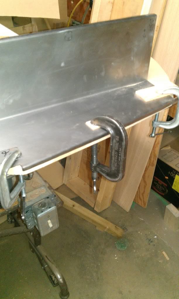

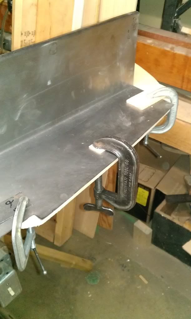

    Alright I got a little bit more done. Working on the tailend this time. I am using a Briz bumper out back as well so I needed to make a pan for the back to fill in the space.
    I started by getting some bends put in a piece of sheet metal I thn cut the shape of the bumper out on the leading edge and then used a hammerform to turn an edge down to give it some strength.
    And then installed with taillights. Sorry for the ****py picture but the sun was at my back.
    Now I have to put a couple of holes in the bumper to run the exhaust through and I will have pretty much wrapped up the backend.

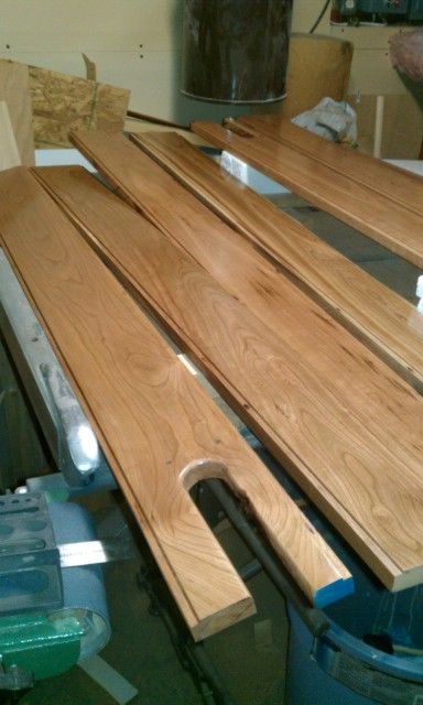

    Here are a few pictures of the bed wood cleared. I did most of the coats by hand and sprayed the last couple. Kind of tough to see much in the pictures but it definitley brought the grain out in the Cherry. I still need to sand and polish them to get them perfectly smooth but they don't look bad as it.
