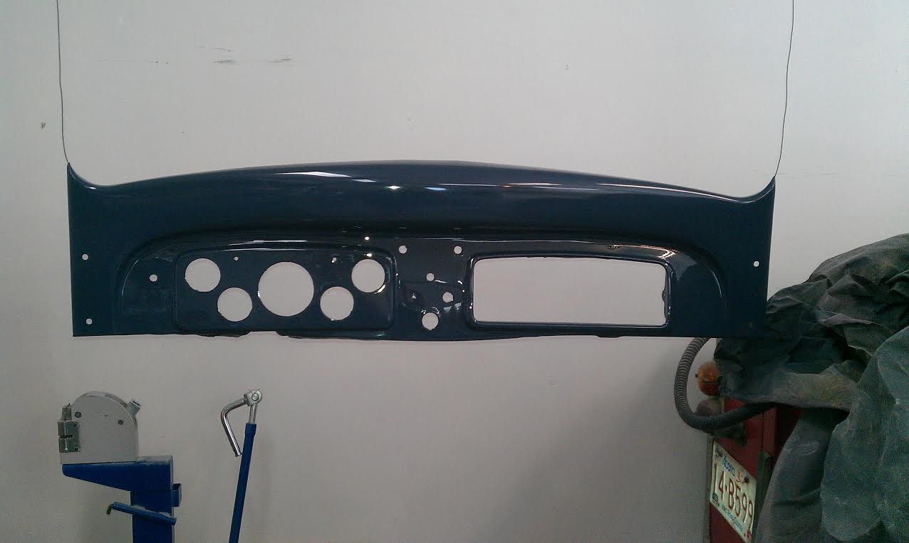

  8. Got some paint on my dash as well. The blue was mixed to match the blue fabric in my seat inserts.
  9. That's a nice looking blue . It will look good once all the dash gauges are reinstalled . Stay at it .

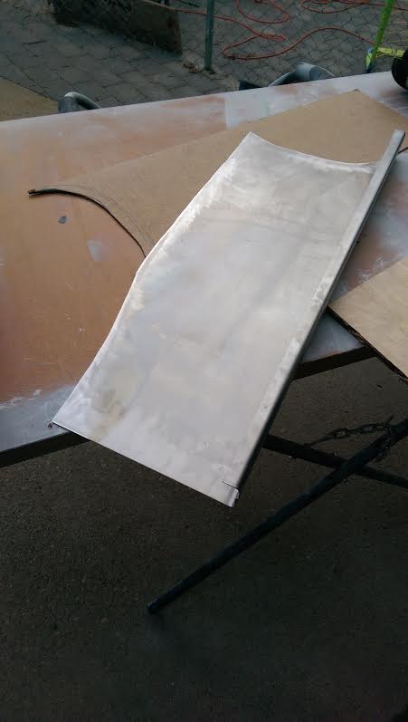

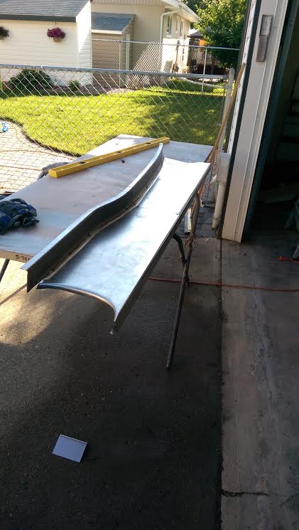

  10. Quick update. I bought some fibreglass running boards ages ago when I first started this build and to make a long story short they are shit so I am going to make new steel ones. I have to do them in multiple pieces because I don't have a long enough brake but this is what I have done so far.
    I am doing each section in two pieces because the upper flanged part of the running board is curved to match the bottom of the cab so they could not be bent in a brake.
    First I cut out the steel then for the upper flange I bend it 90 degrees and used the shrinker to get the shape I needed to follow the cab.
    Then I ran it through the bead roller with a tank roll in it to start the large radius 90.
    Then the bottom. I rolled the bead for the bottom edge and made the two 90 degree bends.
    Rolled the corresponding flare to match the flange.
    An finally mated together.
    Now I have to repeat the process for the back half of the board and then attach the stiffeners and mounting hardware to the bottom.

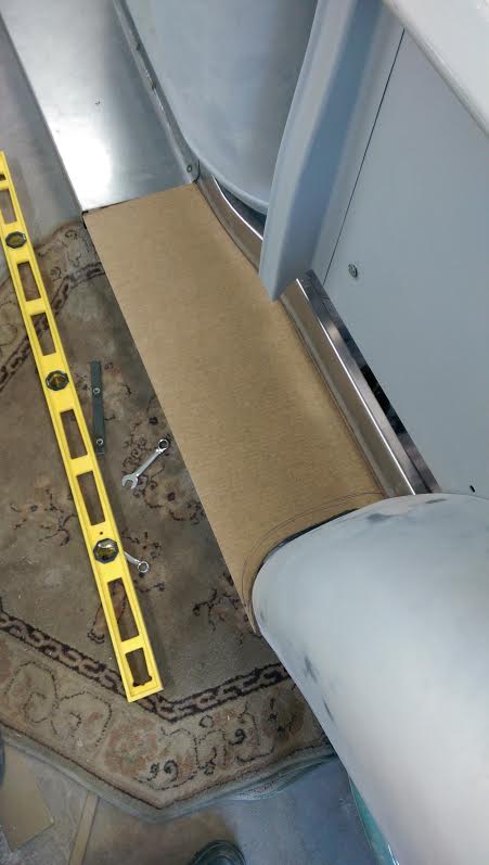

  12. Well not sure if anyone is still watching this or not as my updates have been far a few between but I have made mor progress on the running boards. This is kind of a hodge podge of pictures from work on both sides so if some things don't seem to match up that is why.
    After getting the front tacked together I started on the back. Basically the same routine. I modified the shape of the back of the running board to kick in to run under the bed side rather than need a filler piece that comes away from the plane of the bed.

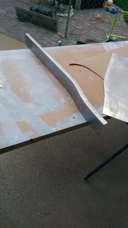

    First I bent up and shrunk and stretched the vertical flange so I had an idea what shape the flat of the board needed to be.

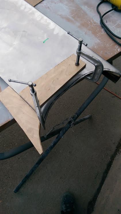

    Then I made a hardboard pattern for the top of the running board and bent up bead roller and then cut out the shape.
    Then I made a hammer form to turn over a bit of the end that meets the rear fender.
    Then I rolled the curves on both the flange and base portions a fit it all together.

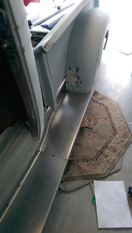

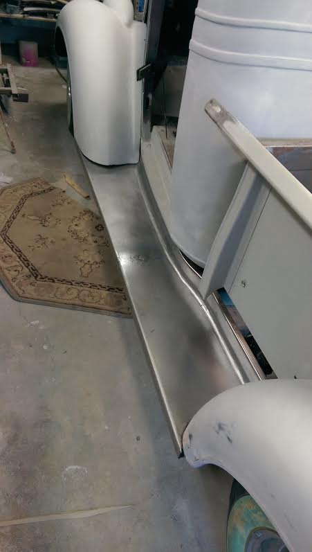

  13. And finally see how they fit on the truck.
    Now I have to weld them all up and put the bracing and mounts on the bottom and then modify the stake pockets from the way I originally did them as the piece I had originally planed for the space between the bed and the running board is not being used.
