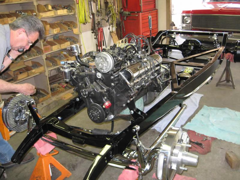

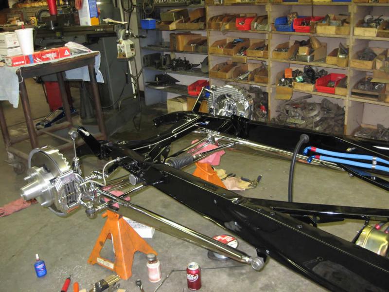

    new Keith Bush Deuce Chassis - Frontend.jpg new Keith Bush Deuce Chassis.jpg
