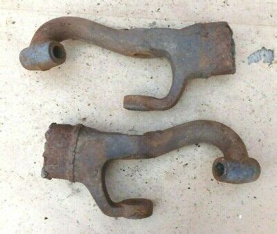

  5. woodsnwater
    Joined: Apr 4, 2016
    Posts: 502
    woodsnwater
    from North Al.
    Look how thick the 36 is up top.

    Cut the bottom lug off, ***emble, weld the lug back on.
    They weld really nice.
    woodsnwater likes this.

    Cut it all off the top part as this is only thicker because of the canter lever for the spring mount, this will let the perch bolt have more of the shaft in contact with the axle and make sure the perch bolts are not loose in the axle. JW

    I tossed my bones in the mill, took off 1/16th off the bottom, and 3/16th off the top.
    It took longer to set up than to do it.

  17. Open up the wishbones, I made my '35/'36 wishbone outside smaller to fit a lower shock mount (and a AA perch bolt).

    He said he took the bones to someone with a mill, not the axle.
