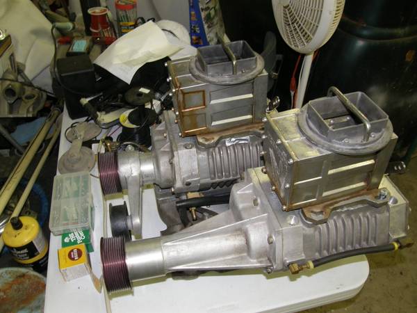

    Ok, so I'm on craigslist looking at junk and cars I don't need and stumble across this dual blower set up with two wash bowls on top and I'm thinking how is this possible or better yet how can i make this possible. The manifold was made here in Austin by a mad machinist or at least a visionary. I'm super impresed by the craftsman ship but how can this work? What compression, boost, carbs, cam etc. Ill post some pics and the link. Enjoy brainstorming and dreaming what you would stuff this boheameth into as I've been doing for the last 24.
  2. Preditor carbs are what 900cfm? Add tiny blowers, preditor carbs? Yea that will run
    . Like crap.

    I wrather see ONE big fat huffer, than two with modern pulleys.

    Looks to me like the S/C's have been adapted to a cross ram manifold.

    I agree on having one big huffer but its still kinda cool looking. Saw some pics with them in a car/truck and looks kinda gay but none the less on the table it still looks neat. Reminds me of tractor pull motors which look way cooler than on a car.

    Blowers are belt driven just underdrive them and it would work, and those look like tiny blowers anyway.

  19. If you lost those carbs. That set up (as is) wouldnt run for crap.

    Make up two 2 groove v style pulleys out of 7075 and run 2 stomberg adapters from vintage speed on each blower.4 carbs in total.
    This on a open wheel car 60s styled=way cool.

    As others have said, the craigslist setup is sitting on an aftermarket cross ram (edelbroke smokey ram or offy)

    I think those blowers are on a late model Chevy fuel injection intake from the 80's, with a new top fabbed for it. I've seen several vehicles with twin blowers, but usually mounted at 45 degrees, with a triangle shaped intake to allow the blowers to sit side by side, and then the carbs mounted vertically at 45 degrees to the blowers so the floats work.
    There's a guy I know here locally who has a Tri 5 Chevy truck with twin 6-71 blowers.
