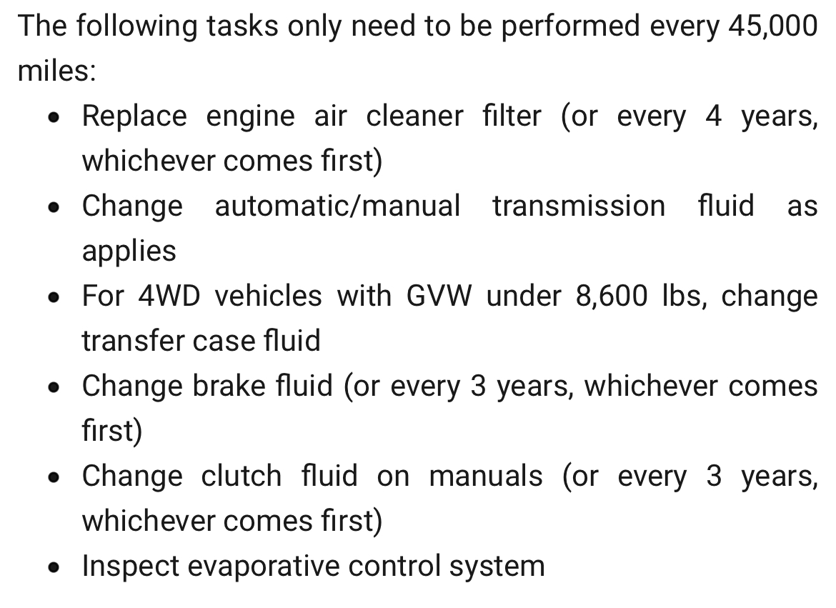

    Maybe this will shed some light......
    Basic up sell - depending on the age of the car and miles.
    If she needs pads/ rotors - good time to do it for longevity but if no issues, I wouldn't do it unless it's time/needed.
    Brake fluid does absorb some moisture.
    Maybe at 60,00 miles. ( like ****** fluid ) changing it - basic upkeep I guess if she plans on keeping the car.

    They do test for moisture when having a oil change. Pretty much every manufacturer recommends changing brake fluid every 3 years these days.

    It's not a scam. You guys are paranoid. She does not need to consent to the service, but it is good that they checked.
    I can remember the brake fluid change interval being called out since the 1970s.
    Yes, you need to change your brake fluid. It is a thing. It has ALWAYS BEEN A THING!
    Brake fluid is hygroscopic, which means that it absorbs moisture. It is supposed to do that. The desired function is to suspend moisture in the fluid, in an effort to keep it off of metal surfaces.
    This is not only to prevent corrosion that could to lead to brake failure, it is also to reduce the likelihood of turning that moisture into steam in the brake fluid, under hard braking.
    Brake fluid, and even water, are both not compressible. Steam, however, is. That can make for a awful surprise.
    In this era of vehicles that do not need any major service for 100,000 miles, people have become detached from the notion that vehicles need any maintenance, at-all!
    At GM we would see cars come in from lease return with one bald set of post-OEM tires, OEM belts, and what appear to be all of the original filters in-place, and un-touched.

    I change the brake fluid in every vehicle that I own, except for those that have mechanical brakes, every 3-years.
