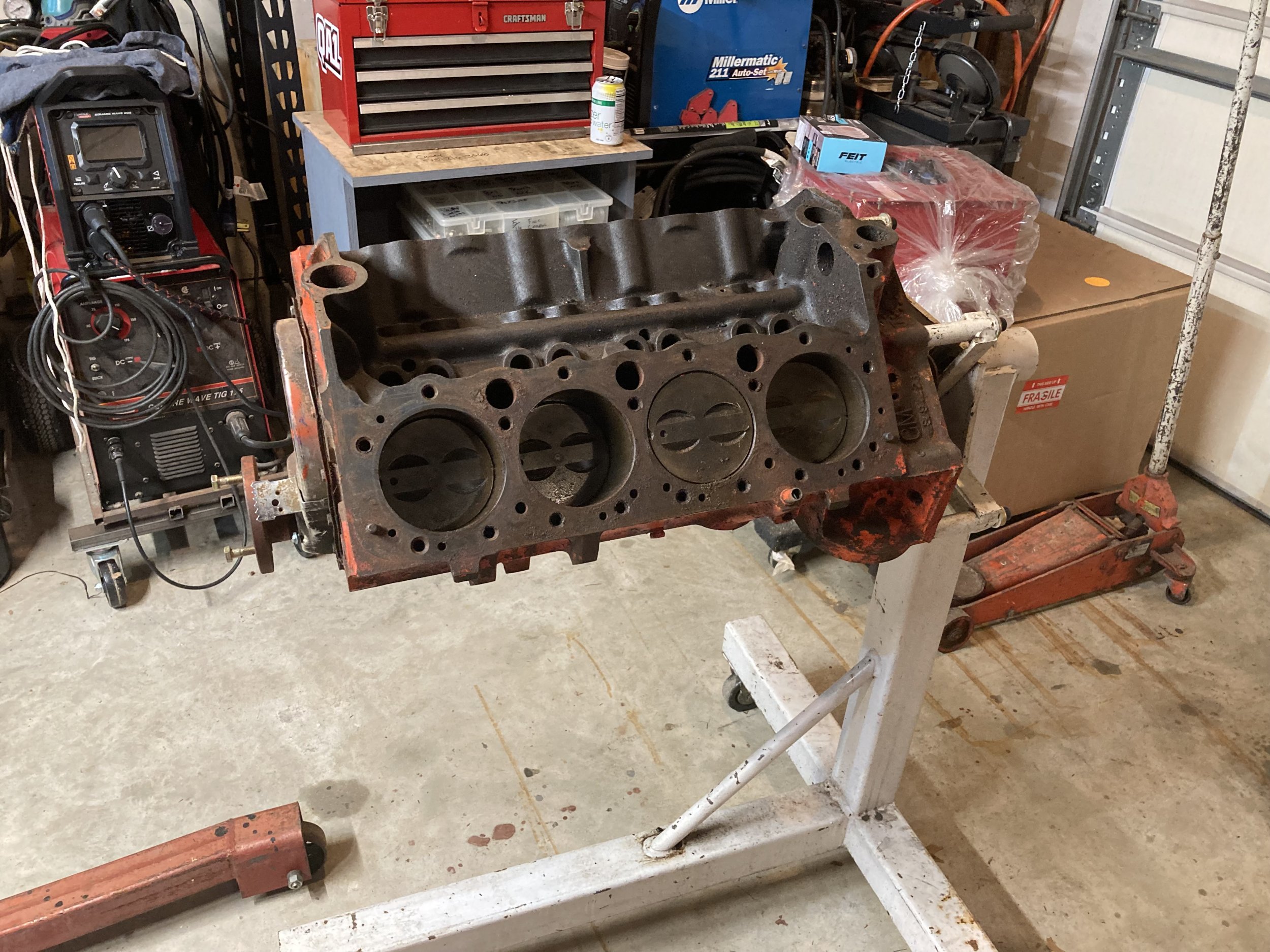

    WWAD? I mentioned in the whatever thread having a new to me 283 short block.
    It’s a bit grimy but otherwise it’s in good shape. Very little ridge, a couple of thousandths at most. I’ve taken a crude measurement at the top of the bores just a bit below the ridge, and it shows about 0.002-0.003 inch wear. Now don’t worry, I know it’s not good practice, but do you guys remember when you were younger, like 17-18 years old, and trying to get an engine running for the paltry amount of money that you made back then?
    So here’s a fun blast from the past to ruminate over. And I know we have all done one of these deals. A true backyard mechanic rebuild.
    What we would have done back then is ream the ridge, and dis***emble the engine, carefully measuring and labeling all of the parts, and washing them thoroughly to ensure they were operating room clean. Right?
    Then, a glaze breaker to get some cross hatch back into the cylinders. Beg, borrow or make your own cam bearing driver, and remove the cam bearings to get everything out of the oil p***ageways. That would be followed up with polishing the crankshaft, and fitting new bearings. Followed by more cleaning. Then rebuilder’s file to fit stock replacement rings, and carefully re***emble your short block, measuring and ensuring that everything fits perfectly.
    Okay, so now the truth. I did an engine early on in my car centric life, a 283, $25 from the local automotive recycling facility, and ran it for 13 months with only a head gasket issue.
    Cam bearings? Looked good just the way they were. Okay, so pull the oil gallery plugs and rifle cleaning brushes and spray parts cleaner, and the block was ready for the honing. Used a glaze breaker and got decent cross hatch in all of the cylinders. Cleaned up again with spray cans and white paper towels, used up 2 rolls on my mom. Oops!
    The rings were 0.005 oversized, and I was actually quite careful filing them to get the right end gaps. 12-inch mill smooth file “borrowed” from work, and clamped in a vise and got the gaps pretty good, if a little bit looser than I was hoping for. Probably better to loose than tight.
    Polish the crank? Take it to work, and ask one of the machinists for help. He chucked it in a lathe and showed me how to get into a good shoe shining mindset with emery cloth from rolls. As I recall he had me use a very fine grit, 400 I think. Took me quite a while to get 9 journals shiny, and relatively the same diameter main journal to main journal and rod journal to rod journal. He spent a lot of time making sure that I was using the shop’s mics properly. And then looked up the dimensions in a manual to determine what size bearings to get. 0.001 undersized worked out just fine.
    So clean the crank and rods and piston ***emblies. Install the rings, bearings in the block, and oil them with 50:weight oil. Same with the rods and piston ***emblies. Slide in a new cam, of course it was one of those favorite cams from Chevrolet, solid lifters and all. I remember using moly ***embly lube and using the whole tube on the cam and lifters. So much so that I had to get another tube for the pushrods, rockers etc. And wash in gasoline to get it off of me!
    So I wanted good heads, and as luck would have it, I had a decent set of 461 heads with 1.94 intake valves. Those cost me about $50 to have them done, and I used the springs for a Z28 cam. So far I was still on budget, but of course I had to get a 4 barrel for it. I had a cast iron intake, that originally had a Carter carb on it, but I wanted a Holley! Bought a 600 cam, now here’s a big no no, a double pumper! And an adapter plate to get it all together. What a FUBAR!
    Now I had read Hot Rod and knew about prelubing the engine, but I didn’t have any clue about how to do it. Go to the speed shop and ask them what to do. Fortunately they took pity on me and loaned me a distributor that had been modified for exactly that purpose. And further, they showed me how to preset the timing for quick startup.
    And it ran! Pretty good too! Lasted 13 months and went with the vehicle when I sold it for something else.
    So, what about everyone else? Horror stories about that first engine rebuild? And WWAD, regarding the new to me engine in the garage? Should I relive my youth and do something similar? I have to say, I do have some automotive machine shop equipment in the garage. And probably better than I used back then.
    Oh well, I was on the phone with the engine shop today getting the 327 in progress finally! I’ll detail the specs in the whatever thread in the near future. Right now first steps are to make sure that the block and heads for that engine are good, and get the striker crank and rods. We’ll figure out cam, and the rest of the valve train after that. It’s being designed to run on premium pump fuel. So compression won’t be crazy high. And the rest is already on hand. More later…
