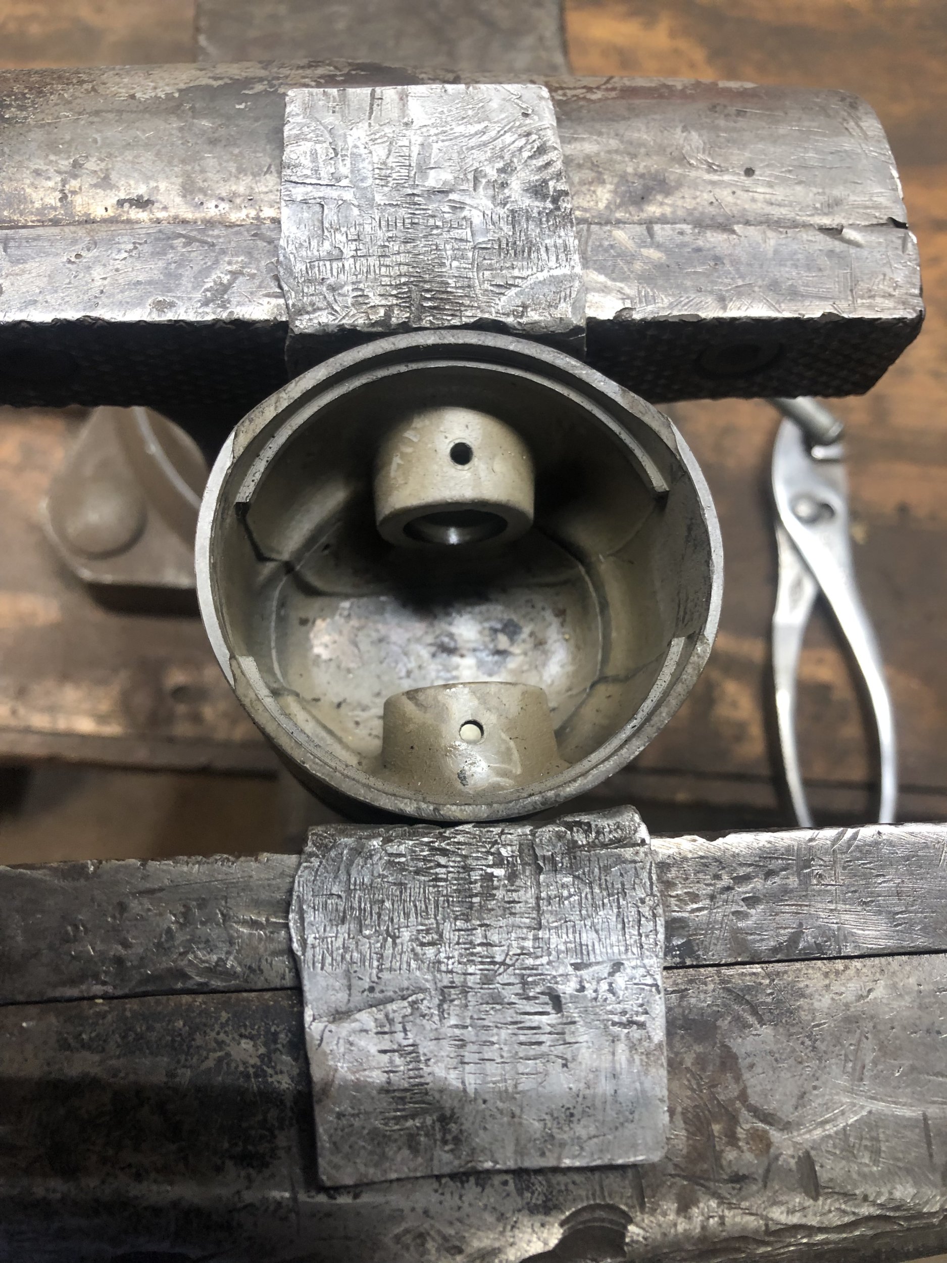

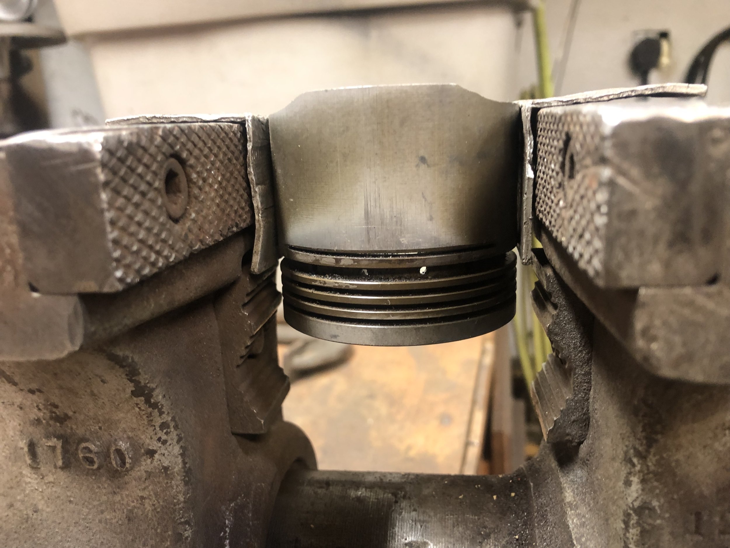

    IMG_3542.jpeg IMG_3541.jpeg When I was rebuilding a BMC A engine I ran across an article on how the Brit’s squeeze the piston to take up slack on the trust sides of piston. They squeeze, measure, squeeze until they get the clearance they want. I’ve never tried it but I don’t see why it wouldn’t help.

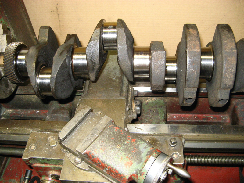

    My backyard crank polishers - one for the mains, one for the rods. I use Scotchbrite pads as inserts. I think red pads are the finest grit.
    OK, you do need a lathe to make it work.

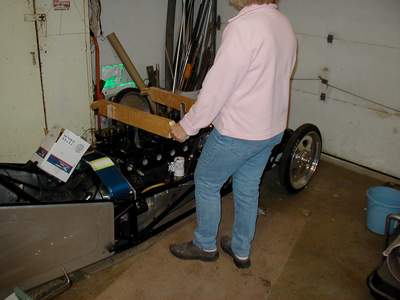

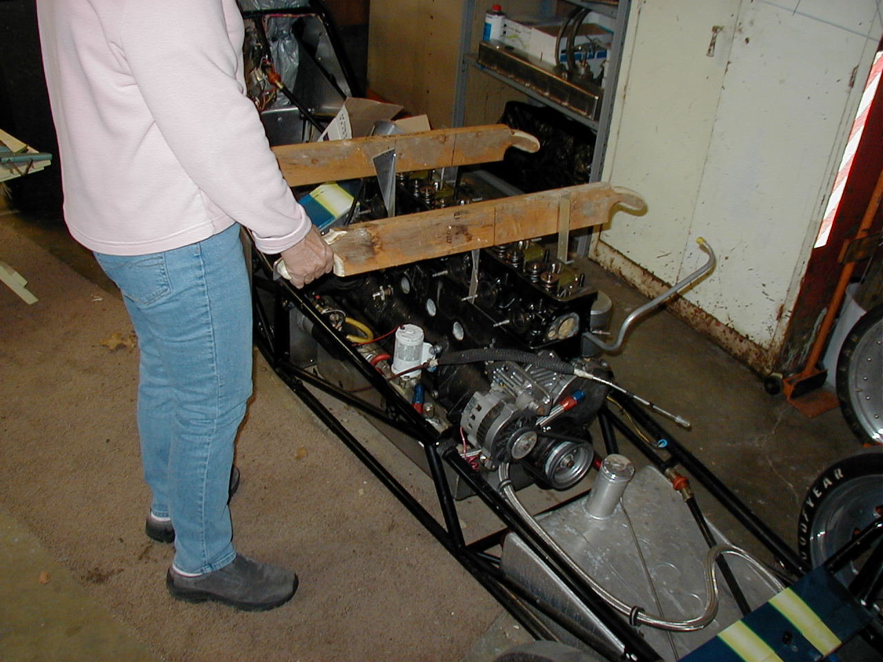

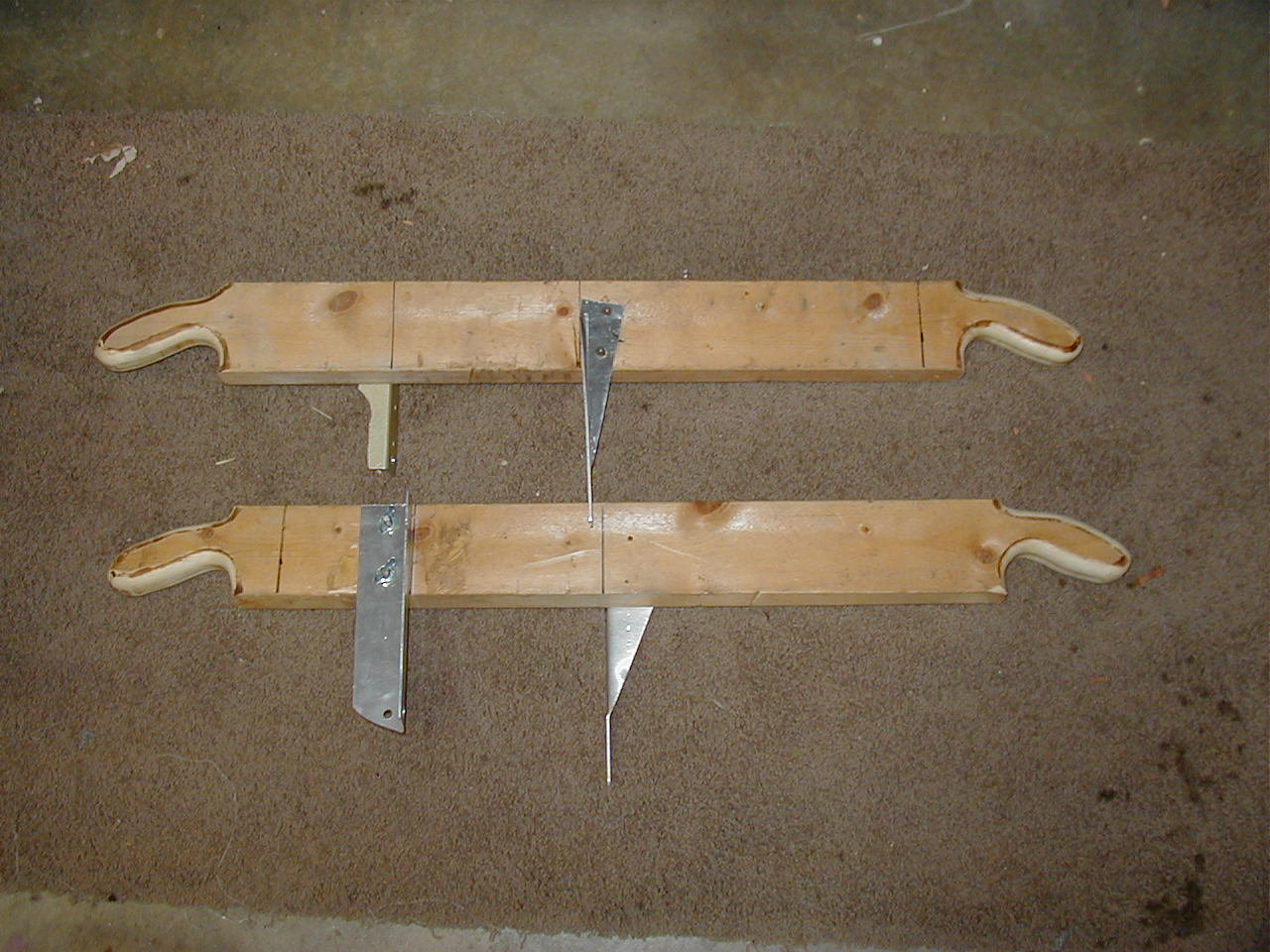

    If you have a willing mate, you can often do without a cherry picker.
    Note the offset in the hangers. Sometimes I let her take the "light side".

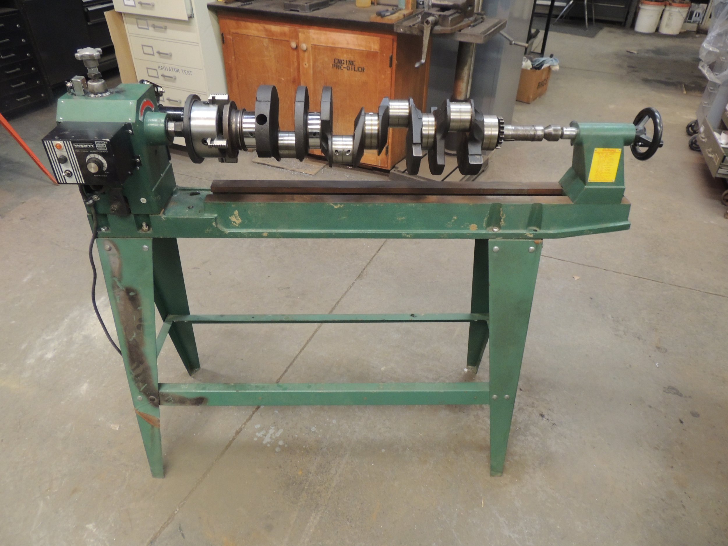

    My cheap crank polisher............
    A modified old wood lathe (even tho I have a 15" Clausing metal lathe). I changed the motor to get a slow rotation (appx 40 rpm) for polishing. It also does several other handy things with heads and cams. Then I used the removed original wood lathe motor and with some bicycle handlebars and pulleys made the actual polishing tool.
    https://www.google.com/search?q=Utu...ate=ive&vld=cid:aed2714f,vid:EtXB8mj1ZJs,st:0

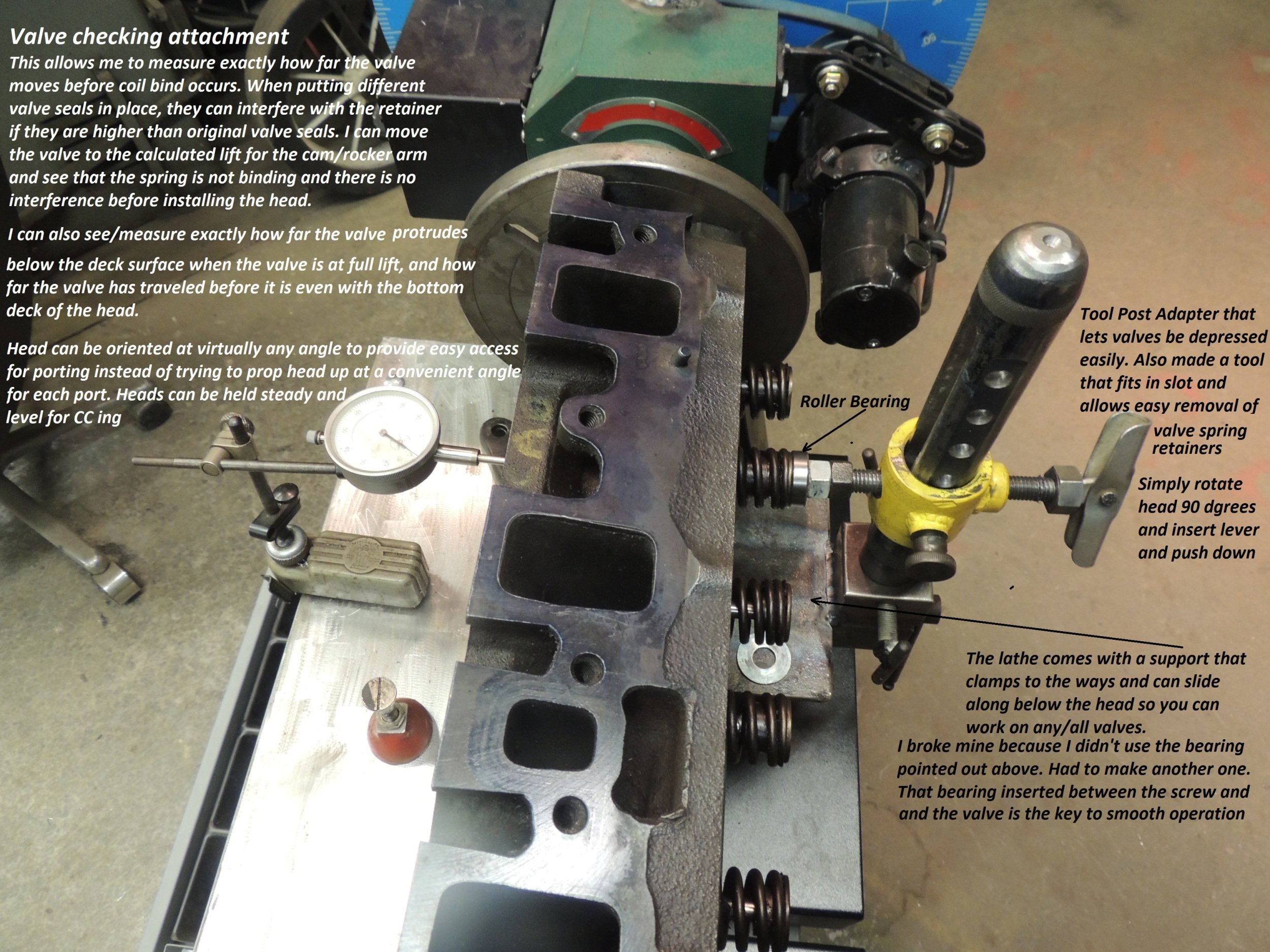

    And as I got it further completed and more versatile........
    Can even check camshaft specs

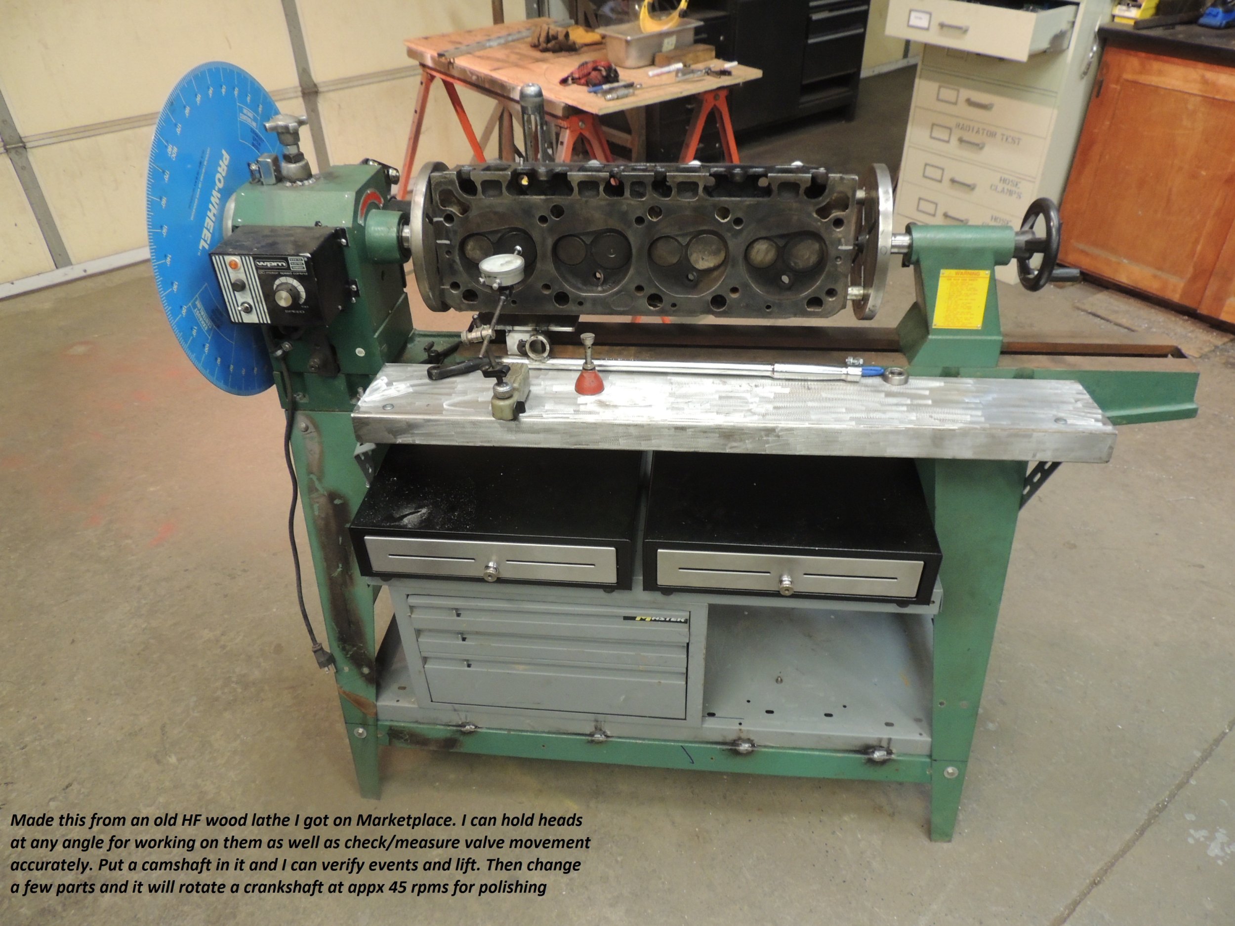

    Its all about using your imagination and mostly cheap or junk stuff.

    There are several articles about pistons being "out-of-round", and why. Early automotive pistons were round because, after all, they were going in a round hole, weren't they? The following might explain why the British are squeezing their pistons.
