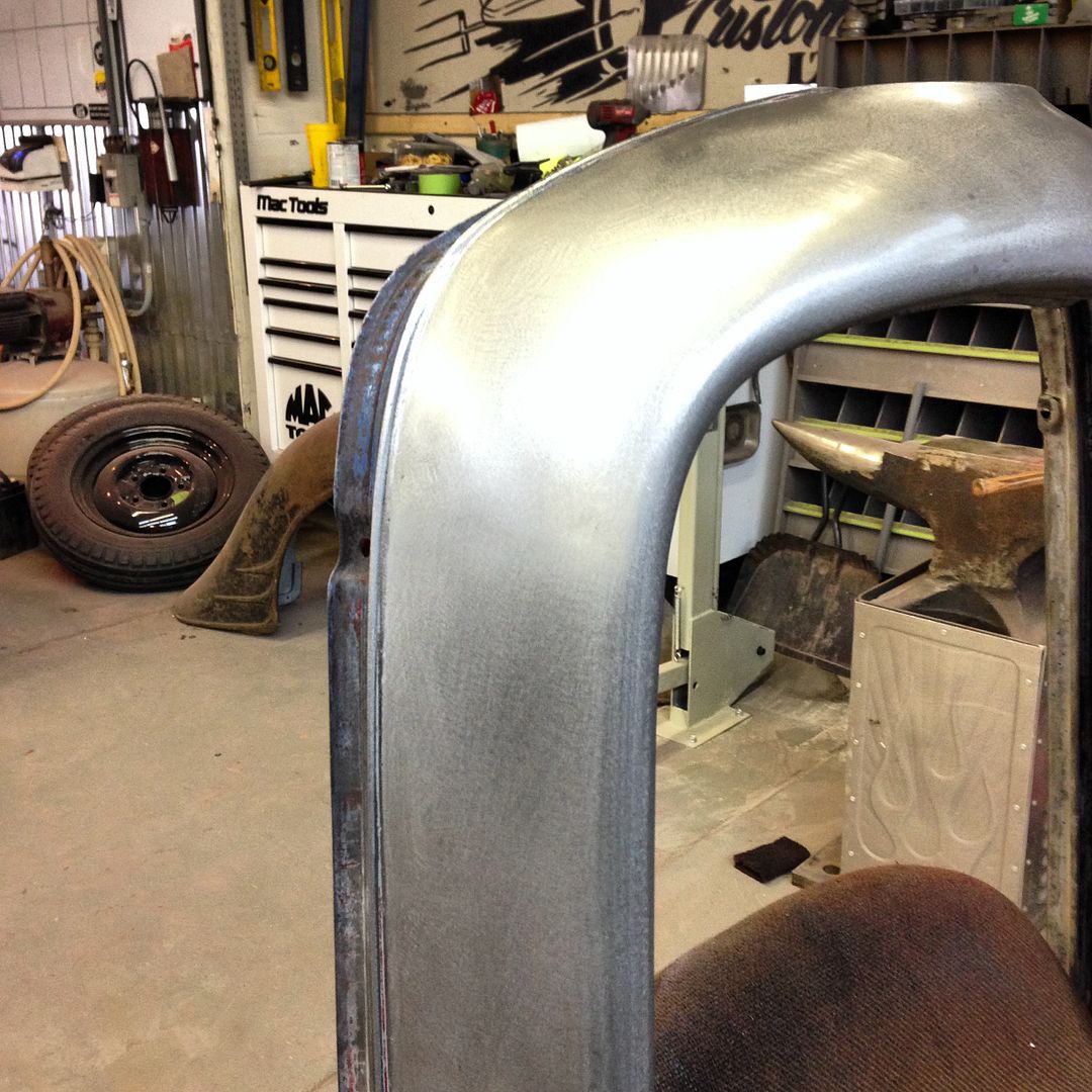

    decided to pinch the rails inward at the fire wall. wanting the rails to be same wide as the grill shell at the xmember and keep the front horns. also wanted to straighten the front horns. so i clamped on a heavy piece of angle, heated and shrank them to get it straight
    all cleaned up

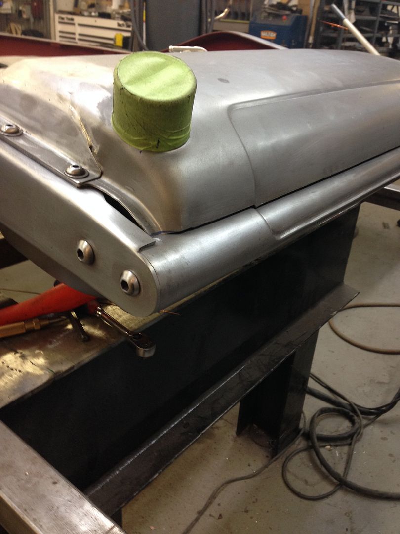

    did the spreader bar to match the tank lines, made the matching lines on the bar go half way around the tube to make the bar stand out but blend in at the same time.
    also decided to recess the bar into the tank similar to the Steadfast car. pushed the bar forward about 2.5 inches
    then trimmed the rails, tapered the top back to match the tube, and metal finished back out. still need to work on the tank sheet metal but that is for another day

    love the rear bar!!! I saw it on the steadfast car too and was thinking about doing the same thing. I love the rear bar idea to reflect the pattern in the gas tank! What's the trick to making that look so nice? did you cut a piece out and tack it back in at a lower level? or shove a small pipe inside? what's the best way of cleaning up the weld after? sorry ...amateur questions, but I really like that detail. Thanks!

    slid another piece of tube inside the spreader bar after cutting out the shape. then tig welded the seam. took a cartridge cone abrasive and sanded the top of the weld smooth
